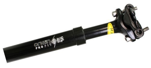

I have one of these on a bike, not as good as the TB or BF I have, but it does help a lot. With 1.77 inches of suspension travel, you'd have plenty of room for it.
https://www.amazon.com/Origin8-Pro-Fit-Suspension-Post/dp/B0046W0N9G
