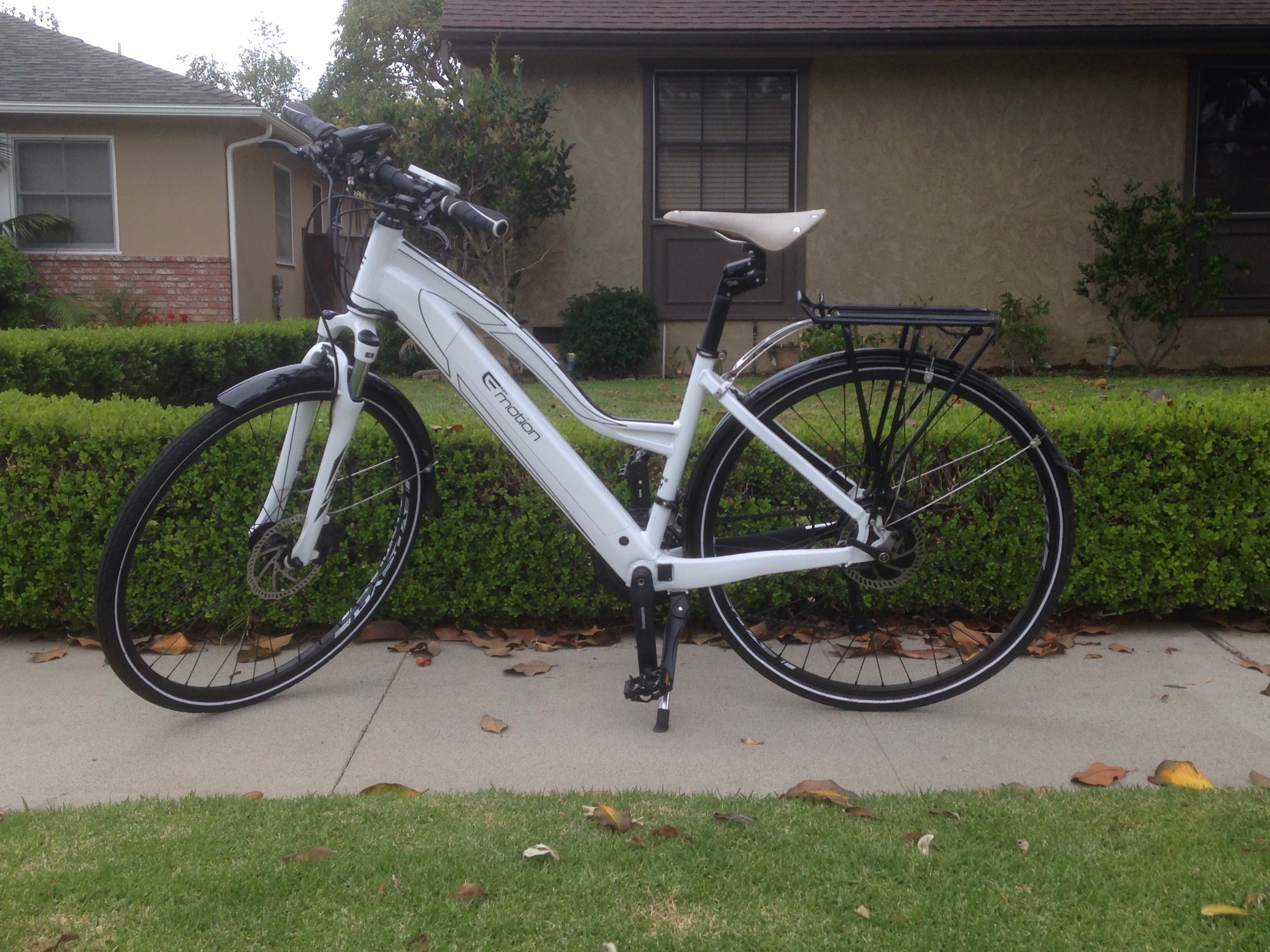

image.jpg Here is a picture of my bike with the Body Float and Cambrium saddle
Sorry the background was not prettier. I stopped in front of some houses I was riding by and snapped the picture.
