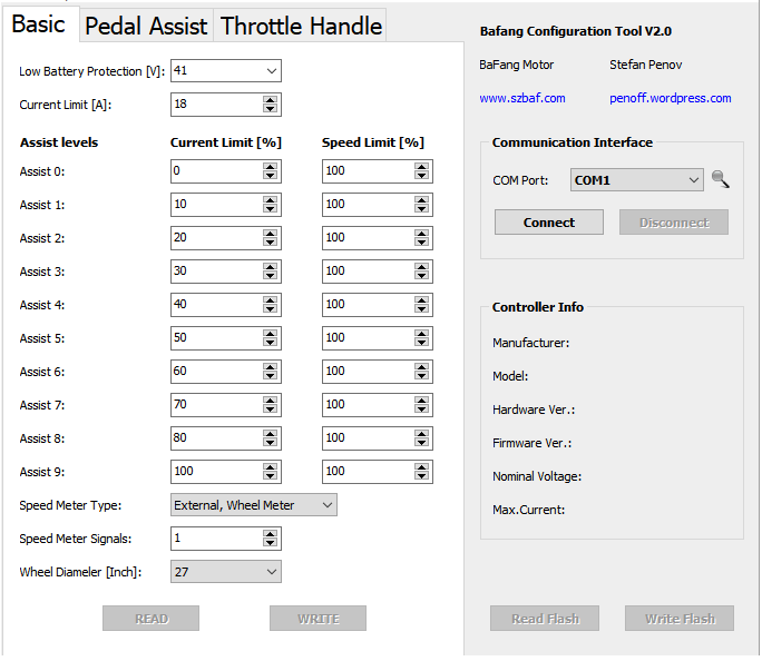

An online business sells 750w BBS equipped bikes that compare in weight and features with mine. The bike alone without the battery weighs 69 lbs. The crank wheel is 44 teeth and the derailleur is a Shimano 9 speed. The battery is 52v,17.5 A while mine is 48v, 21v. The seller says that they programmed the controller to turn it into a 500w street legal bike in Canada and the speed is limited to 32km. They claim a range from 65 to 100km is possible. I wonder what settings they are using to get such impressive results. I limited my controller to 18v as recommended in the guide found on the web and I programmed each of the 9 PAS levels as explained on the web starting at 10 % on PAS 1, etc. Low battery is set at 41. While riding on flat terrain and using only PAS1, I can barely get a 50km range. The display shows around 600w to 760w draw while riding on PAS 1 and middle gear. How could I possibly get the range claimed by that online seller? What settings would make my 750 w behave like a 500w motor?

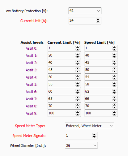

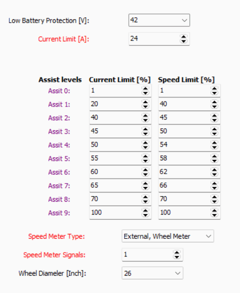

Here's mine (52V 11AH bat):
A steady 600W on level ground seems like a lot. How fast is that?
Tire size and pressure? Total weight including you?
Would help if you posted your PAS settings.

Tires are 26x4 inflated at the 20 lbs manufacturer receommended. Total weight including fat myself is 260 lbs. Riding speed with around 650 w draw is around 31 km/ph, PAS 1, gear 6 or above. Speed limit is set at 100% on all 9 levels, that is 33 kmph. What kind of range are you getting with your setup?

My tires are 26x1.5 front, 26x1.75 rear, inflated 55 psi front 50 psi rear, total weight ~220 lbs.
My 24 mile ride to and around the Arlington Triangle uses about 1/2 the battery.
I cruise using PAS 3-5 (higher levels as the battery weakens) at about 32 kph.
More about how I determined my PAS levels here:

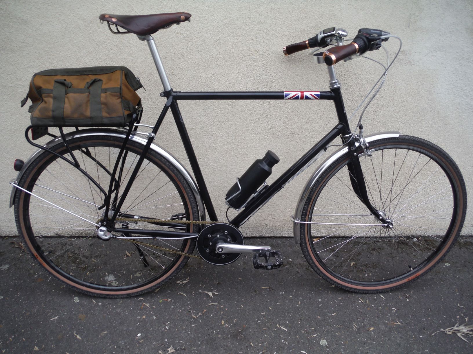

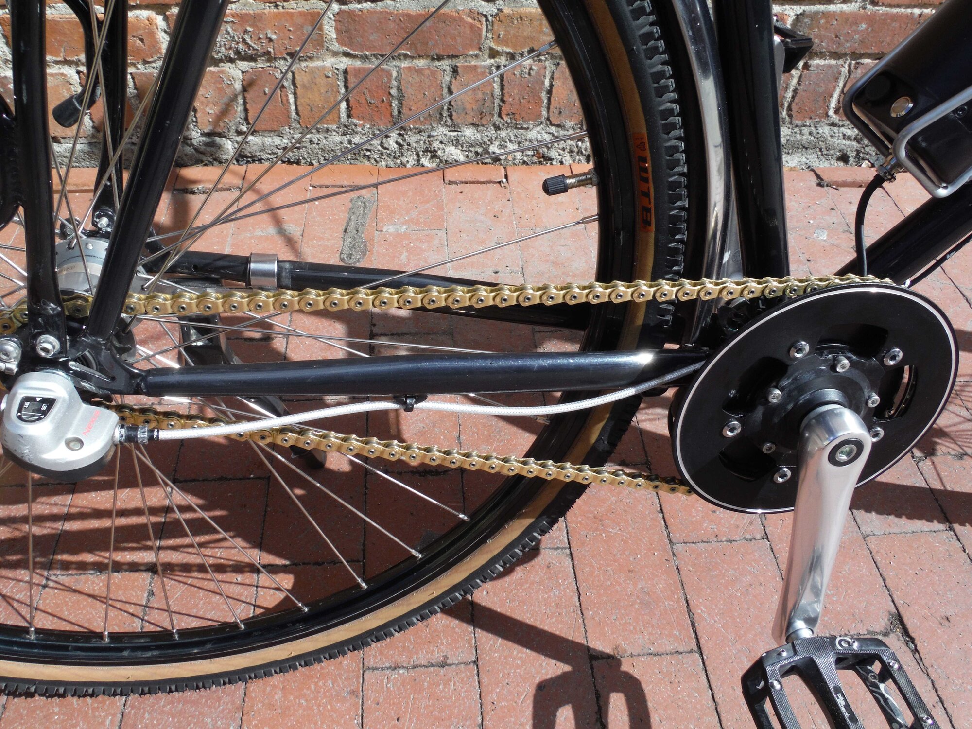

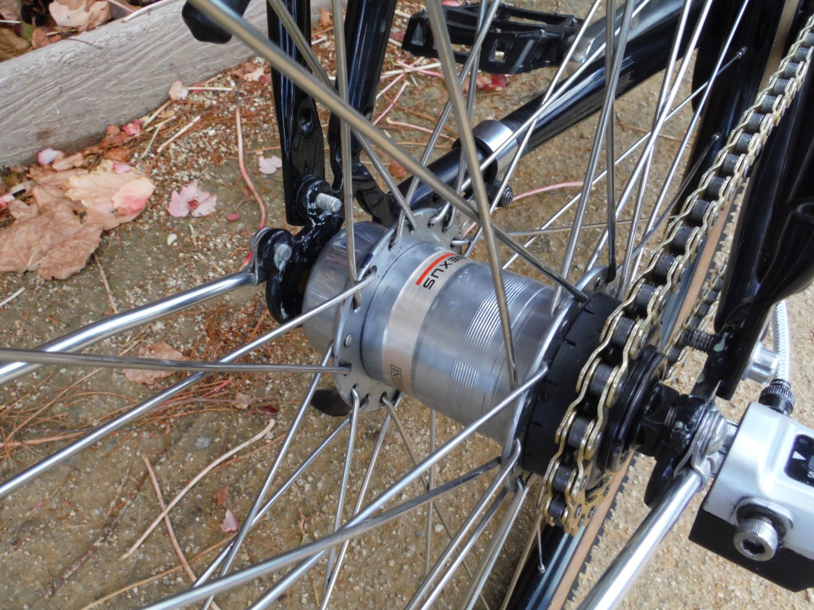

Draw on the flats should be under or about 100W. 100W for one hour = 100wh. I can ride a 36V 7Wh battery for about 2.5 hours. That is on a bike with 622 x 40 tires at 45psi and a total bike weight of under 40 pounds. That one is a three speed and has a torque sensing motor that is more efficient than the Bafang mid-drive. A three-pound 252Wh battery goes 50 miles with wind, hills and some stoplights averaging 18.2 Mph over the total ride. I know a guy with a premium battery on a fat Bafang who drains his battery at two miles. It is because he is ghost pedaling and using the throttle. I use a motor for assistance not substitution. Here is that bike from a couple of years ago. I sold it and made a similar one with some improvements. The battery is in the water bottle cage. You can see the discharge wire running to the motor. I am now better at concealing wires like that for a more refined finish, but that was four years ago and I am still learning.

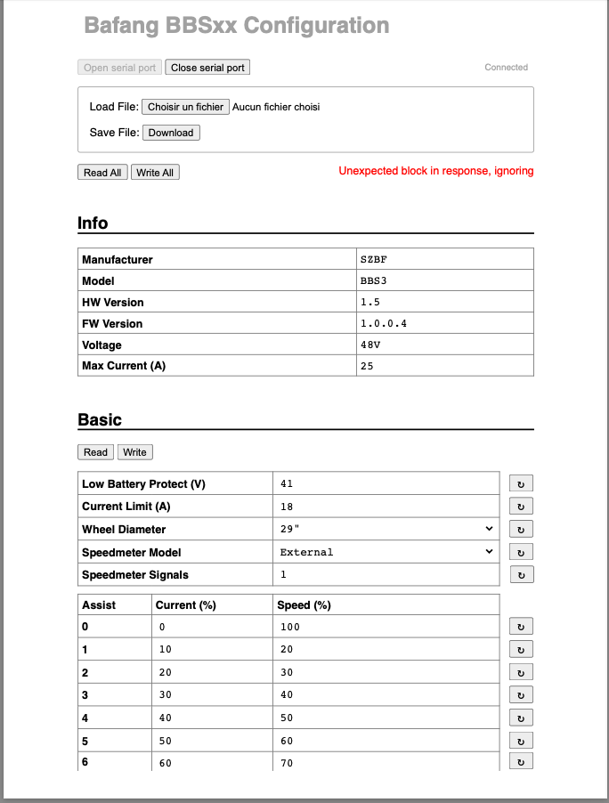

What is it that I don't get about setting up this BBS3 750w motor? I see users posting low watt usage as low as 98? Is it stable 98w those guys are getting or are watts fluctuating a lot like on my bike? The display never shows watts below 400w and it keeps fluctuation between 400 and over 850 in PAS 1 set at 10% and first gear. Do you have to limit the % motor speed in order to get low watt consumption? Unlike with my hub motor bike which provides a very steady speed and watt usage, my BBS3 feels like the assist is constantly on and off, which is very unpleasant. Should the BBS3 run very smoothly or is that kind of internal fight between full power and low power to be expected?
Post a picture of all your settings.
When pedaling on a flat I'm usually using 0 to 125 w. It does fluctuate as your pedaling speed has minor deviations and wind can affect it as well. With taming the settings you should be able to produce relatively smooth and predictable output.
Post a Pic of your bike and an estimate of your weight.
Also describe how you want to ride. For exercise? For speed? The motor giving you a little extra or a lot of assistance.
Don't become frustrated... We'll get you rolling right
Read my post here and tell me if it interests you or what you may want different.
Post in thread 'BBS*** Settings for a Smoother Ride' https://electricbikereview.com/forums/threads/bbs-settings-for-a-smoother-ride.37833/post-462130
Understand anyone else's settings should be for learning and a starting point. You should always tweak things to your specific bike, physical ability and riding style

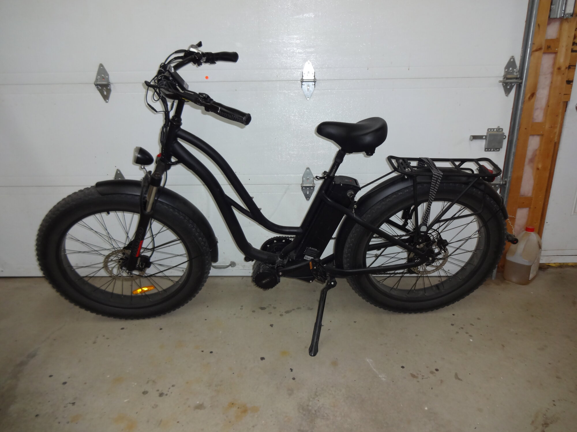

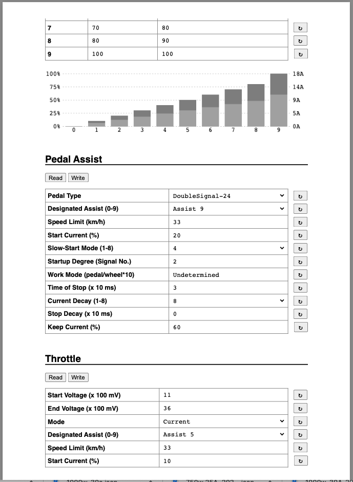

MY bike and myself weigh 260 lbs. I don't care high speed riding. I prefer when the motor gives me little assistance when necessary but I like to pedal non stop. I do want to exercise.
Thanks
