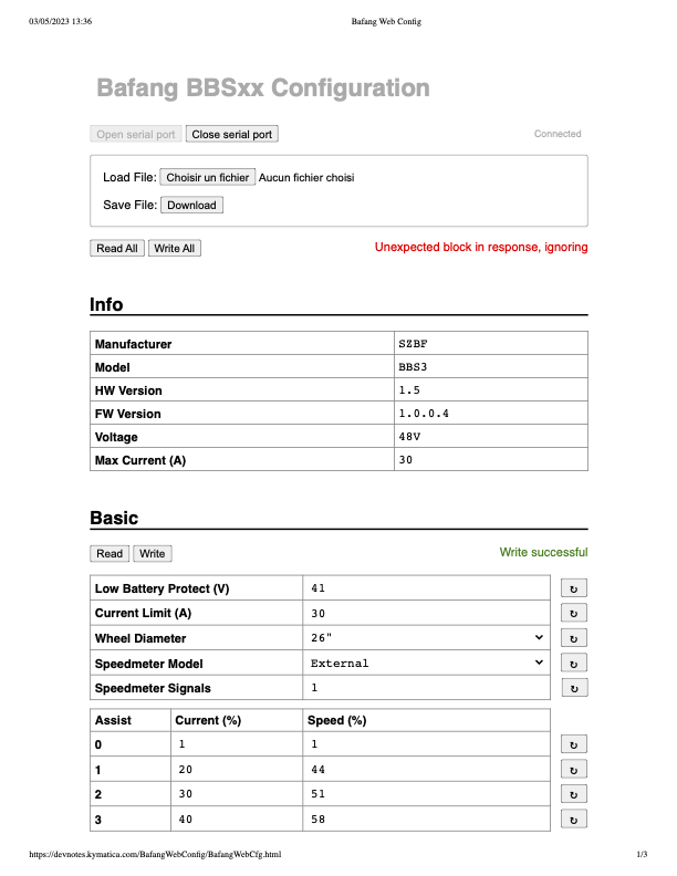

No sorry I did not mean that. You did a screen shot in Post #18 of your settings. I think that was from the web based Bafang configuration tool. Thats what I meant.
Along the lines of removing variables, I also see that PAS0 has a 100% speed limit reading. Normally that is 0%. Also note how mine are 1 and 1 for the two settings. Supposedly that keeps throttle functional while PAS is set to zero. Given your locale you may not even have a throttle.

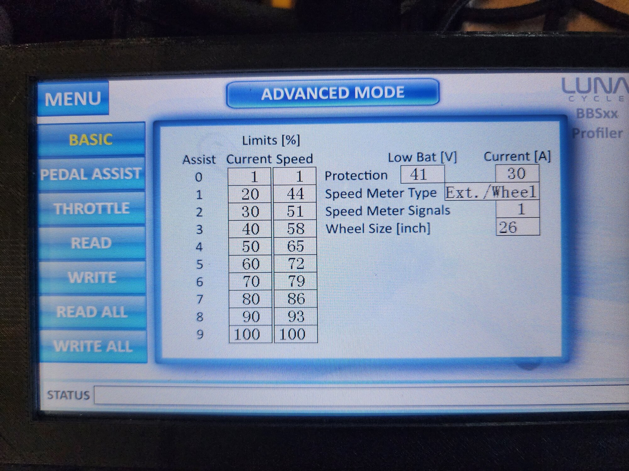

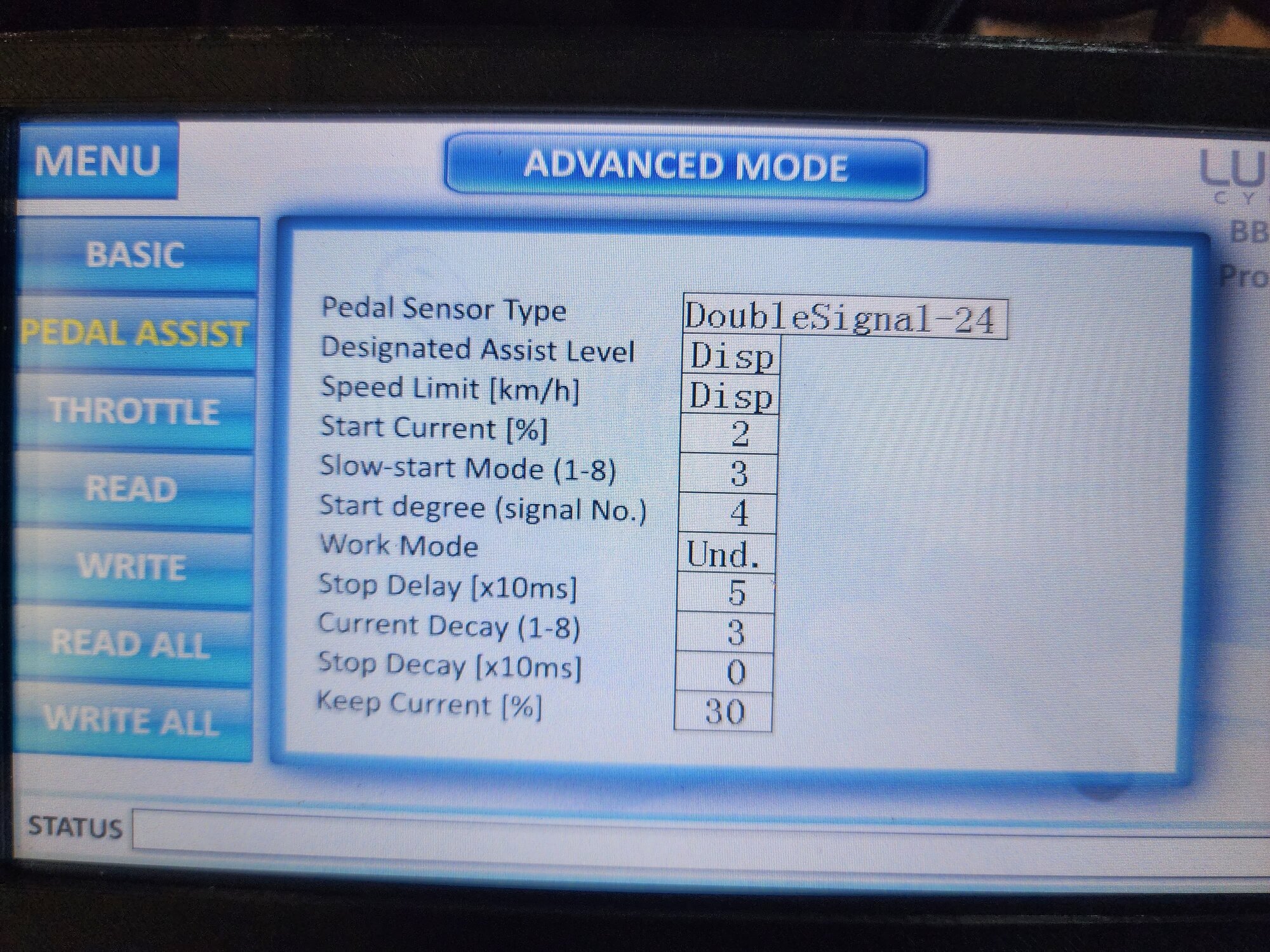

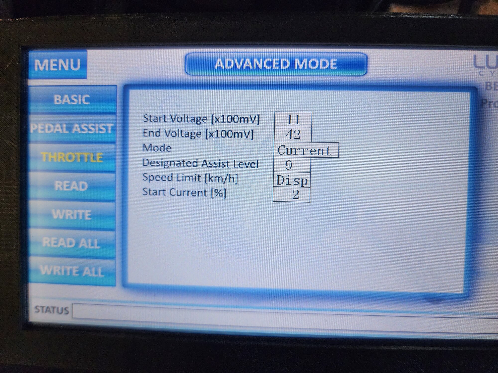

Here is what I wrote on the 1000w controller. I tried to copy your exact settings.Testing will have to wait until the rain stops.

I can't read that fast 🤣 check your photo.
I would try lowering PAS 1 SPEED to 10 and see what happens.
You should be able to shut the motor down pretty easily with pedaling with the settings as is so this is a bit of a mystery.
