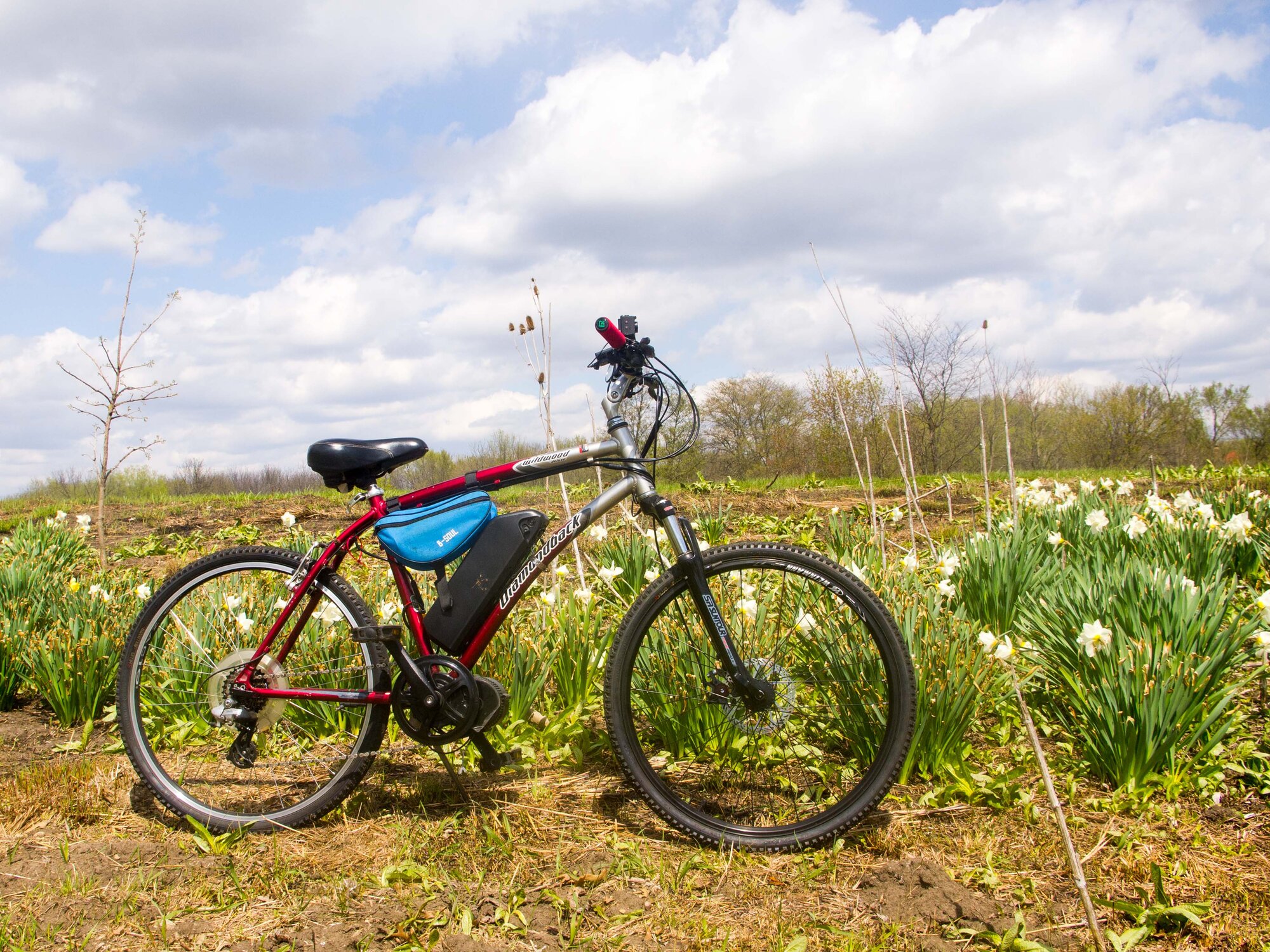

Bought the BBS02B last January from pswpower.com. I believe it was $430 USD shipped, Found the Diamondback for $50 that same week. Unlike other Diamondbacks I have from the same time, this one had steel wheels and no provision for disk brakes, I had to swap in alloy wheels and a new fork. When I put these pics up, I realized that one rim is silver and the other black, Damn. Oh well.
I knew that Bafang had changed things since I bought my first BBS02B in 2016. Did they ever. Found it unrideable by my standards and had to buy the program cable to change the factory settings, That went pretty well, The details are on the web, I even found the cable on amazon for $13,
Battery is 48V15AH nominal, 14AH actual, Uses LG cells, Attached to the curved frame with four fasteners, Could be worse as far as looks. . I've gone 44 miles and drained it down to 47.4 volts, so I think 60 miles is a guaranteed range,

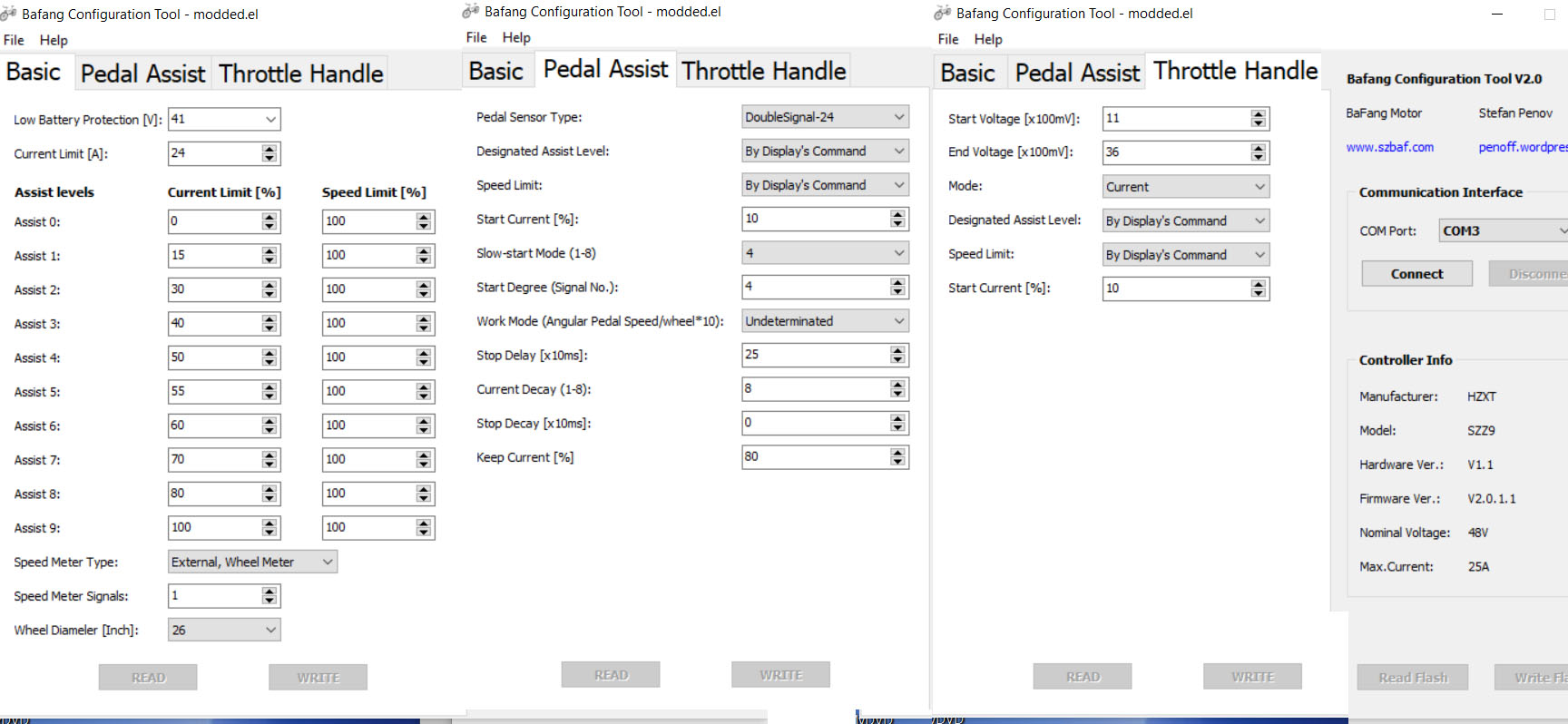

Not saying that my settings would be perfect for you... but they're definitely geared towards us older gents and think you might appreciate some aspects of it compared to stock and your changes so far.
According to what I'm reading that Assist 0 setting should be 1 and 1 or it disables throttle at PAS 0. May be outdated info. On older versions of the firmware I used 4 and 30 and created a crawl-mode for use on crowded mixed-use trails. Doesn't work anymore.

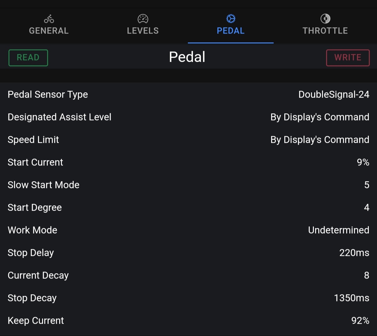

Here's another way to do pedal assist screen. Start current is much lower so its gentle on the rear cluster. Slow start mode is a little gentler to be nice to the drivetrain. Start degree is cranked way up but thats me slowing down the engagement of the motor because its a 2wd bike and the front motor takes the initial load from a stop. Stop delay engages as quickly as can be safely gotten away with. Current decay (when cadence rpms climb to the point where motor power begins to be reduced) is set to the lowest effect on this version, but I usually use 4 nowadays, which is more aggressive about pulling power back as my cadence increases. Stop decay is as fast possible. When current decay kicks in, it only keeps 40% of it on this screen. My thinking is if I can spin the crankarms I don't need power. That thinking doesn't work on singletrack
My throttle settings are wider at 11 and 42. Makes for a wider throttle response that is also smoother. I also put throttle start current down to 5% to keep the drivetrain pampered.

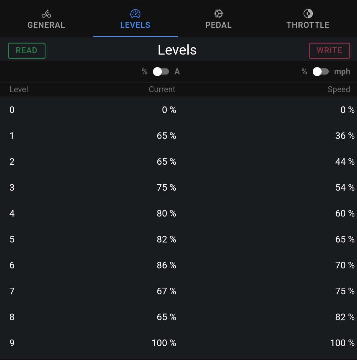

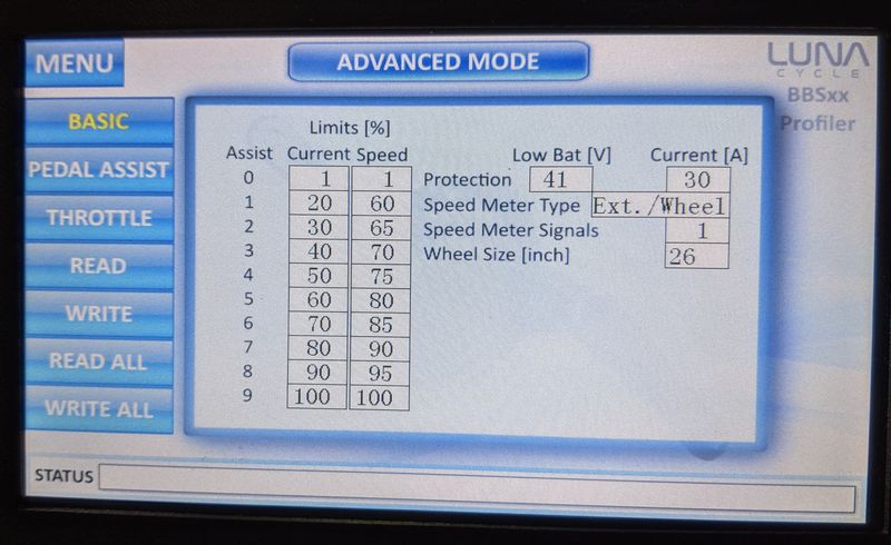

This is my current basic screen, which is not particularly intelligently laid out. I have tried some much more fancy algorithms to do the different limits, but this simple numeric progression does what I want, in the end, which, coupled to the decay settings, cuts my power back when I start reaching differing higher cadence rpms or motor speeds. A lot of people like to use solid 100's on the speed percentages but if I do that it handicaps the motor's ability to cut back power when its not needed. On a singletrack bike I can see 100's across the board. On an urban bike where rhythmic, precise cadence is a big part of the ride, this version comes into its own.
What I'm going to start testing is whether a scheme that changes speed % (and perhaps also current%) to increments with a uniform 40% increase makes for a better ride in hill country.

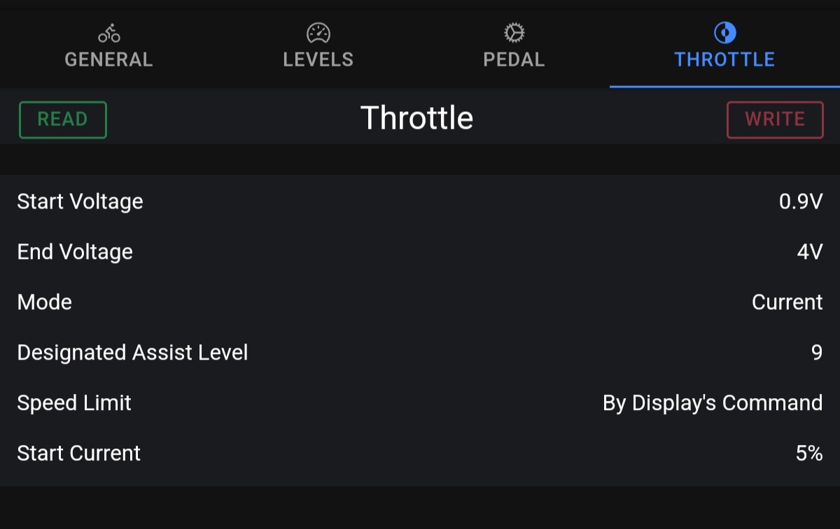

As for the throttle... Best thing you can do for the widest smoothest feel is to set the START and END Voltage to your particular throttle. Mine is set for the half twist type.

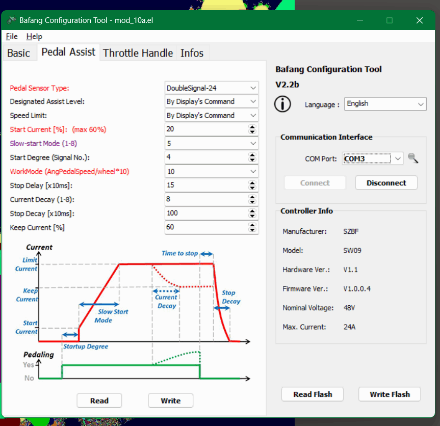

I also recommend this post from @circuitsmith
Which has this great graphic of how the Pedal tab's parameters affect BBSxx motor behavior.
I can tell you with certainty that the Stop Decay doesn't work as illustrated and nothing I've seen other than assumptions confirms that graphs accuracy... Well at least on the BBS02B.
That said it does seem to be in the ballpark.

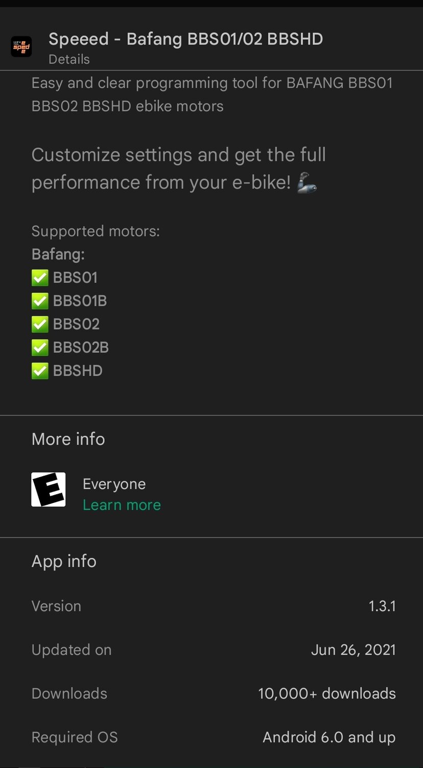

Amazon delivers the cable and adapter today. I'll try Speeed on a bike I don't have to depend on as I've seen it doesn't officially support the BBSHD, although users claim it works fine. Also in another venue I was helping a guy out and he claimed the app bricked his motor. But I think it much more likely he did something dumb.

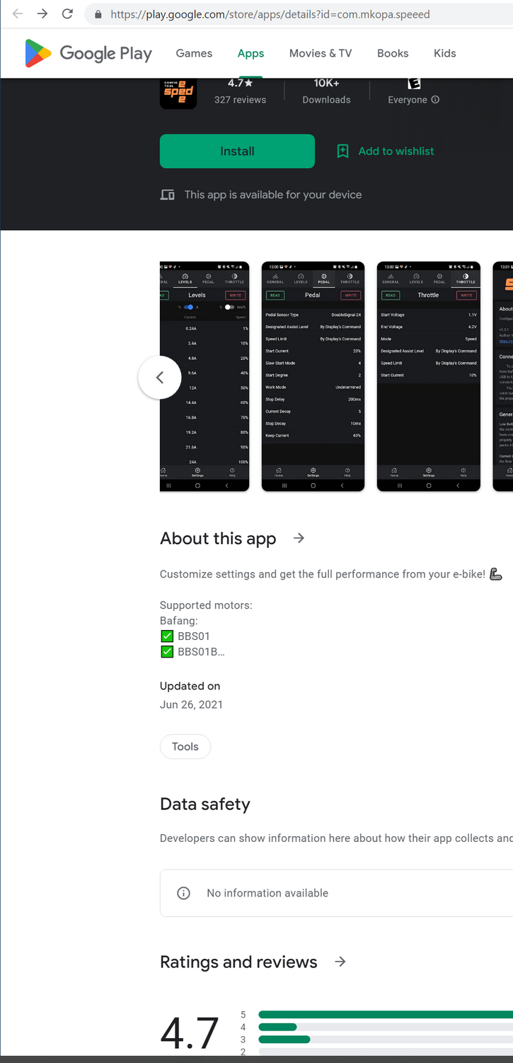

What makes you think that the HD isn't supported?
My experience has had 0 bugs
There is a list of supported motors in the app's entry in the App Store and it only names the BBS01 and BBS01B. Now, clearly, thats not exactly correct given the BBS02, and add to that the fact that there's plenty of different ways you can describe the BBSxx series of motors (i,.e. BBS03, BBSHD and so on). But coming on the heels of someone telling me the app bricked their motor, I'll try it on a reserve bike first.
I've experienced BBSHDs that have not quite compatible firmware inside of them depending on who sold it to me. I have always bought Luna motors but I do have one recent purchase from Cali Ebike and that motor is forced to 28a max. One of the recent '52v' motors from Bafang. On E-S I saw a report it had some other quirks that for an unknown reason made it a weaker performer than 30a HDs. Bafang basically doing its hate-thing on 52v. I set that motor aside and relegated it to backup status.
hmmm I just looked at your scrnshot and its not what I see. I'll check the display on my phone instead. That ellipsis at the end of the motor list implies something else is there and based on your scrnshot...
Yes that's the abbreviated description and I too had to expand it to see the full list.

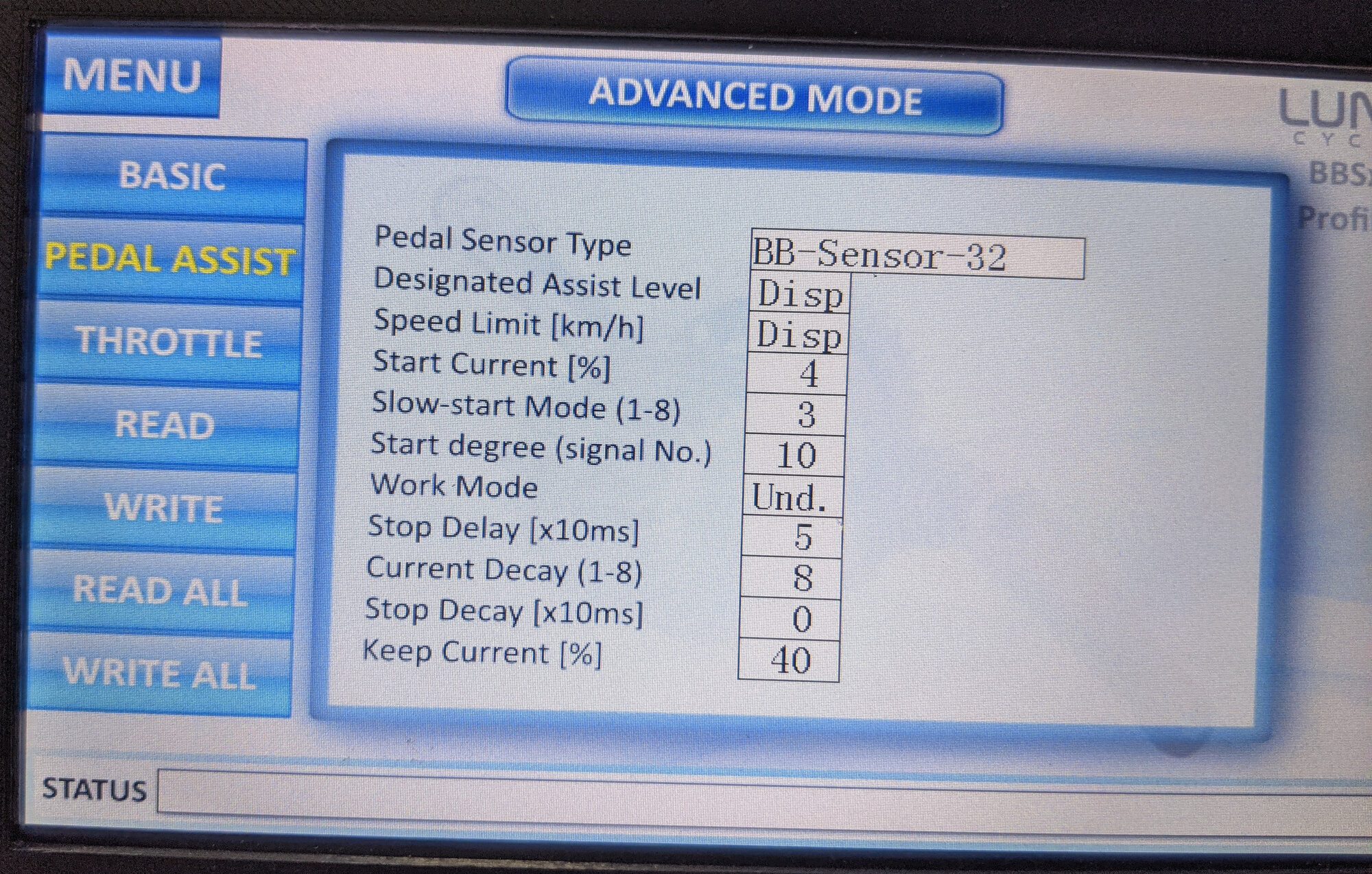

I am planning on playing with my white Bullitt via my Black Box later today, so sure I can fiddle with it. I use a Stop Decay of zero with the idea being I want the motor to stop assisting as fast as possible when I stop pedaling. A setting of 1 second would seem to allow quite a ramp-down. I should be able to test that pretty conclusively as I'm riding up steep hills, and I do not use a gear sensor. I can stop pedaling and simultaneously shift and see what happens. As it stands I get a gentle gear shift with the whisper of leftover power and drivetrain momentum. If I get a much more noticeable powered shift that will tell me *something* is happening immediately. From there I can see what the effect is on flat ground.

But my experience is that this setting has absolutely nothing to do with motor run_on after pedaling stops and in assumption is tied to Keep Current. It smooths out the motor acceleration, cruising and eliminates the ON/OFF feel when at a steady pace as well as heavy lurches. A minimum setting of 1000ms (100 in the software) is required to start seeing these results.
