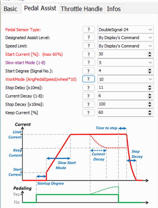

I think the settings that contribute the most to taking the rough edges off of the BBSO2B are on the Pedal Assist page.
Start Current of 5 - 10 should be adequate for most
Stop Decay of above 90... I'm currently using 100 and feel it is the most important setting as far as smoothing and removing the heavy lurching forward and the pulsing On/Off with the stock settings.
Keep Current of 90 seems to work the best with the rest of my settings.

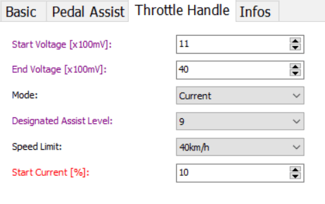

On taming the throttle, page 3
Mode: Current
Start Current... again something between 5 - 10
And getting the top two Voltages set correctly based on the particular throttle you have. If you are unable to take measurements another way is to rotate the throttle and see if there is too much travel before it engages. If so, lower the Start Voltage. If you end up settling it too low, the display will show an error. Careful doing this as it is possible to activate the throttle without touching it so having the back wheel off the ground is recommended.
On the other end if fully rotated and not reaching maximum current you can decrease End Voltage and if getting there before full rotation, increase End Voltage. This will give the throttle the widest range. To be honest, this method is kind of hard to guage but it does help.

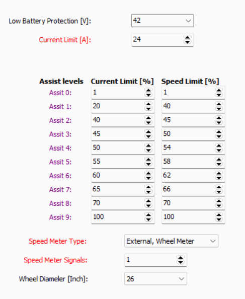

In all... All settings I feel are personal and what I'm using on Page 7 post #123 of this thread work very well for me, my bike and how I ride.
My Page 1 Basic/Speed Limit % are set to my desired cadence for each PAS level and giving me the current needed to achieve it for various terrain situations... but keep in mind that you'll never draw that amount as cadence tempers it as soon as you start moving.
