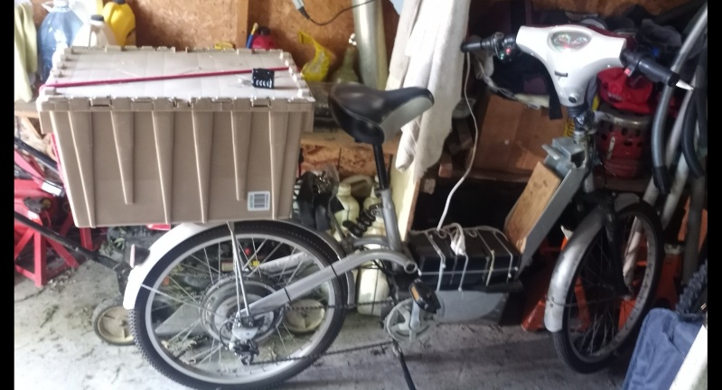

More than 3 years ago, I got an aftermarket controller for my Radmission. One advantage was that I could have the throttle available while pedaling without PAS. Today I tried PAS on a hill. It cut out for about a third of each cycle.

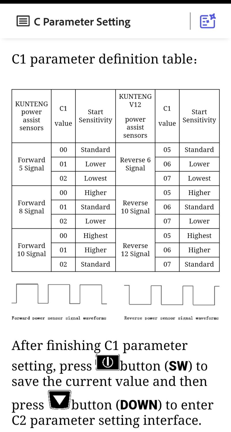

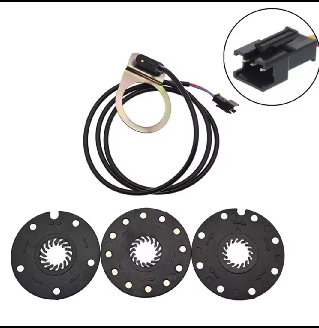

My KT controller allows for 5, 8, 10, and 12 magnet PAS sensors.
No 7 magnet version though, and the only 5, 8, and 10 magnet versions that I could find on Aliexpress are the old-school Huge ring types,..

The original controller missed shifts. I put on a KT. The manual said nothing about the number of magnets in the cadence sensor. These 12-magnet sensors are supposed to be nearly universal. The 12 magnets are supposed to provide a quicker response.This new type also has "double Halls."

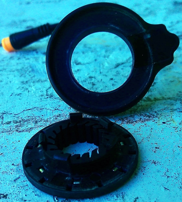

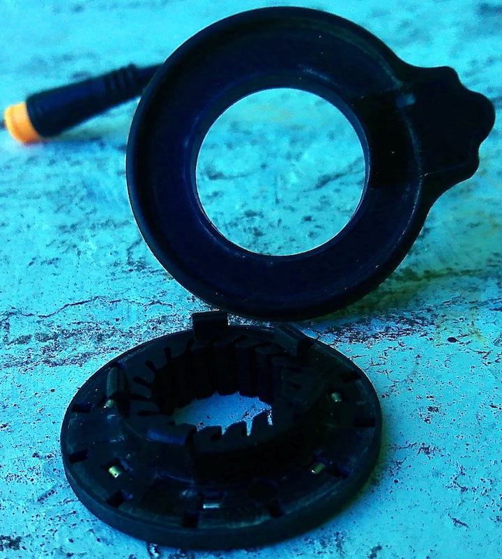

I don't know where to get a cadence sensor for a single-speed bike. I popped the old one open and touched a steel circlip to each magnet. Six magnets would lift one side of the disk. One was dead. I wonder how that happened! If one dead magnet caused trouble in 2/7ths of a revolution, I guess the transistor reads not the magnets but the gaps between them.
@PedalUma wrote about replacing magnets. I haven't popped the bad one out, but it appears to be 1.5mm in diameter and 2mm long. Where could I get a replacement?

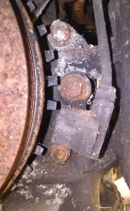

Maybe that single dead magnet is supposed to be dead, like the missing tooth on the flywheel on my car? (for the crank shaft position sensor)

I'm thinking that maybe there's something proprietary going on and the seventh magnet is dead on purpose to leave out a pulse on every rotation?
(Like the missing tooth on my crankshaft pulley.)

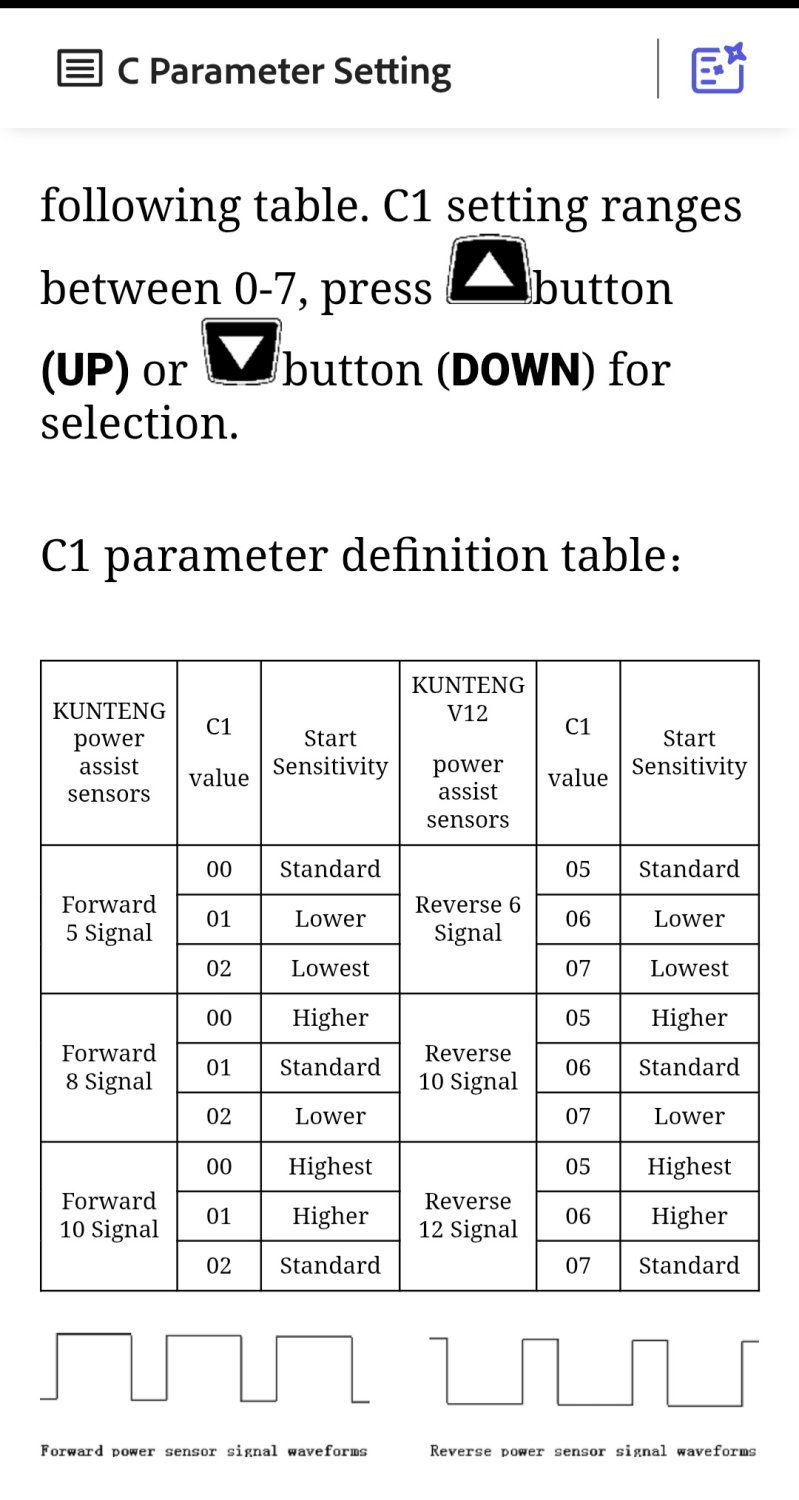

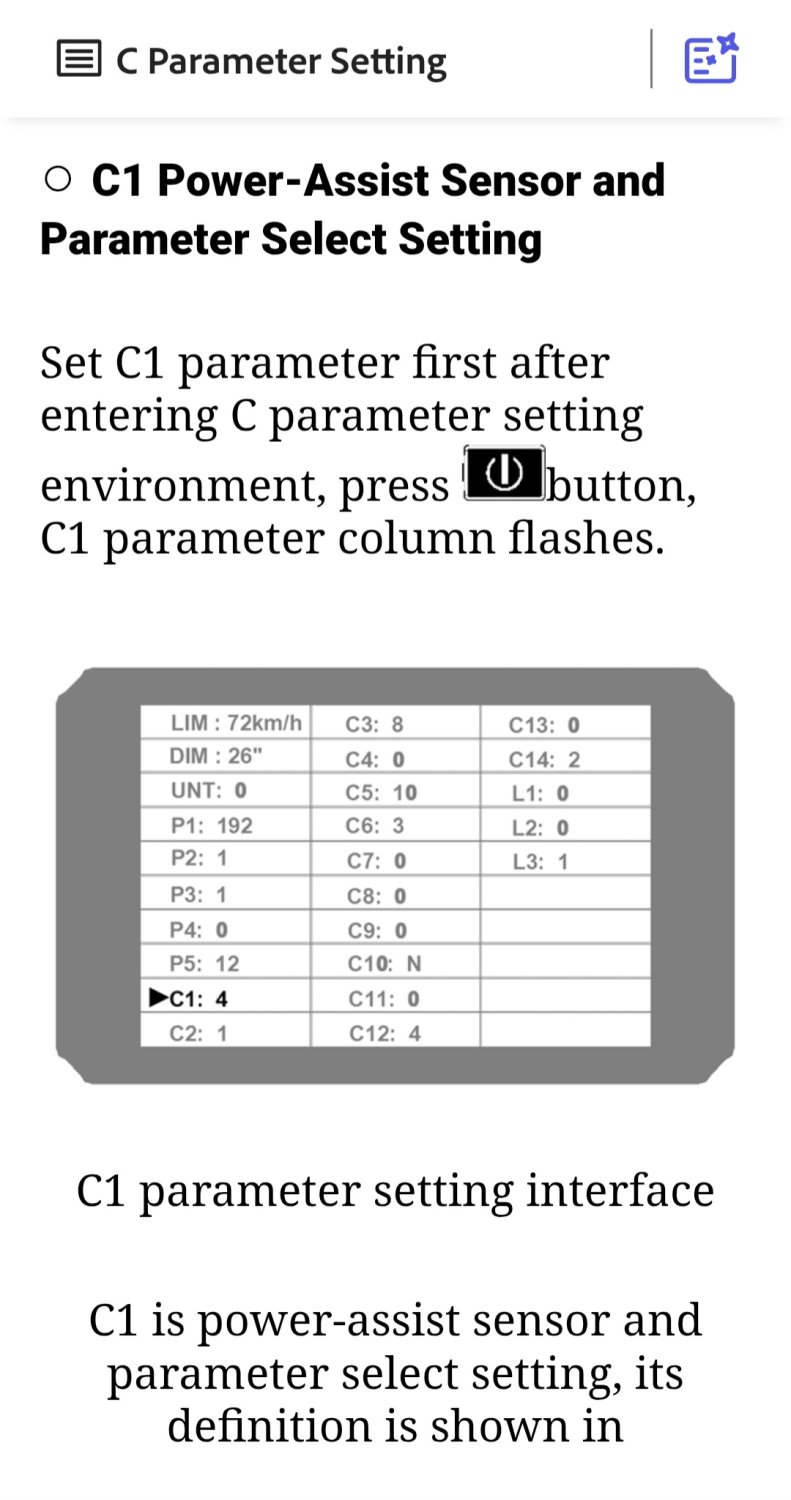

This is how you "program" a KT controller to accept a KT V12 cadence sensor,..
If you did install a KT controller (not just the KT V12 cadence sensor), then you need to have a KT display that allows you to program the settings.
(Not all KT displays have a programming mode.)

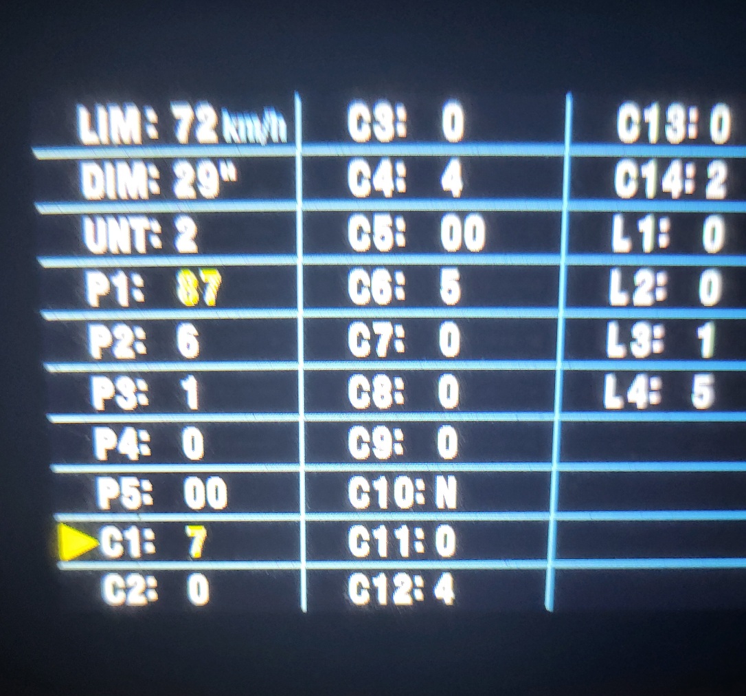

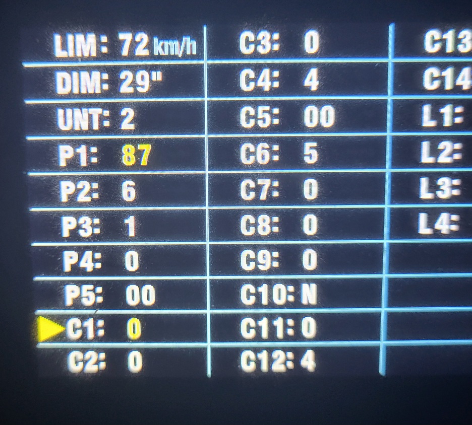

This is my C1 setting on my KT display.
It goes from 0-7
Just start at 0, try it and see what happens.
Increase it one number at a time until it gets to where you like it.
There's no reason why a KT V12 cadence sensor won't work with a KT controller.
(unless it's some kind of proprietary controller using KT programming and it's locked or something?)
