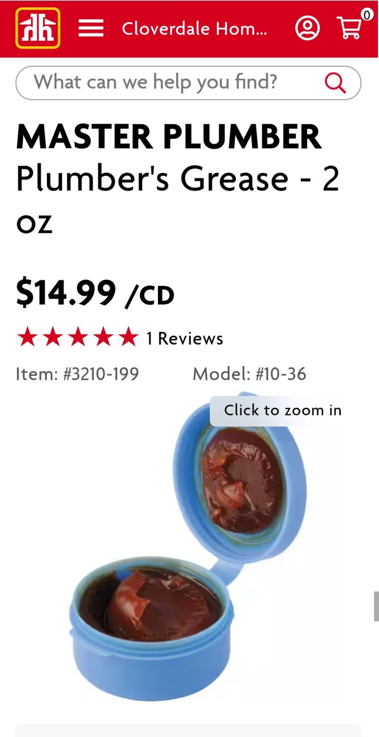

Plumber's O-ring silicone. It lasts in kitchen faucets for ten-years. Nothing sticks to it.
Yeah that s*it's expensive.
You don't need much but still.
I just use silicone dielectric grease.
Interestingly silicone grease can dissolve silicone in the same way that petroleum based lubricants can dissolve petroleum based rubber.
The best rubber to use is urethane. You can lube it with anything slippery. 😁

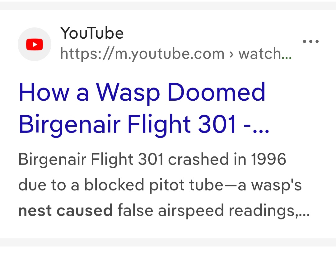

The KT controller used to work fine with the P14L. Six of the seven magnets still energize PAS at 10 RPM. The dead magnet explains the gap. If it had been dead before, I would have noticed the gap. Are there parasitic wasps that lay eggs in little magnets? Can the measles virus damage magnets?
