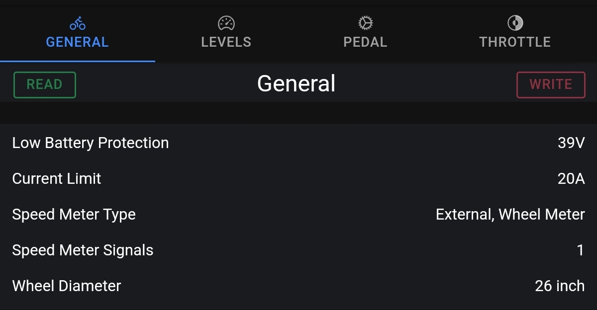

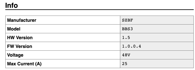

As you can see on my screenshot, It was taken from Bafang Web Configuration Tool and it does show 25 A current for the 750 w and 30 A on the 1000w I also have. I thought the BBS3 was only 1000w.
Sorry... I didn't write the firmware.
This question is probably best directed to the seller.

There's the manufacturer rating and then there's the max current allowed by the controller set (changeable) in the software/web interface/Android app.
Mine is 25a/20a respectively.
For clarity..
I understand what you are saying but is my 750w motor a real BBS3 which, as you said, is a more robust motor? Or does it depend on the controller attached to the motor?
BBS3 was an early model j inner used by some. it’s a BBSHD. sold and labeled 1000w and 750w some versions of the BBSHD can run 48V OR 52v. some were shipped with 25A firmware and some with 30A. all rather confusing. that said the performance difference between 48V 25A and 52V 30A are quite close. Bafang shipped with at least 4 different firmware. like the version that won’t run on a 52v battery. Changes in throttle availability in PAS made quite a stir. Bottom line the HD is a beast. ride it like you stole it.

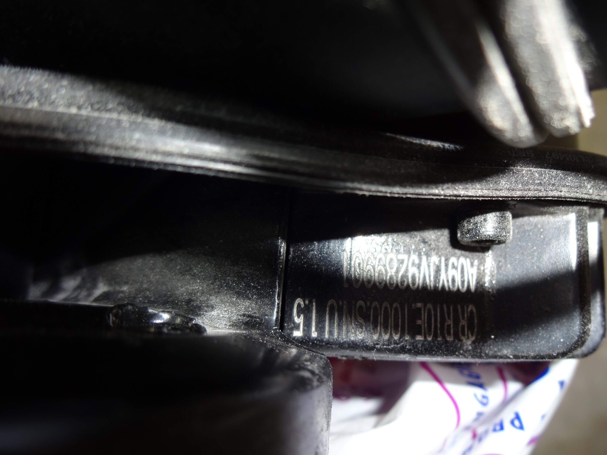

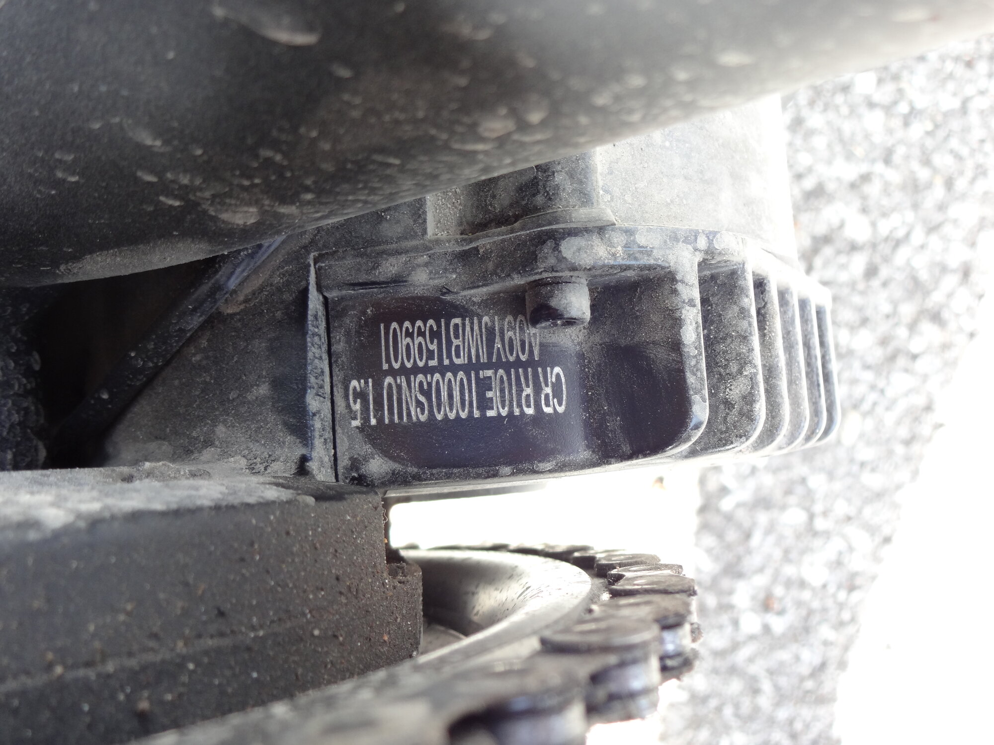

It'd be interesting to have pictures of the information engraved into the motor and controller. Or even just of the motors for a definitive ID.
the 750 is a BBSHD. if the 1000 motor fins are the same as the 750 you have 2 BBSHD motors. likely different firmware.
