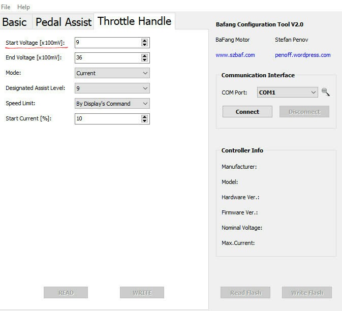

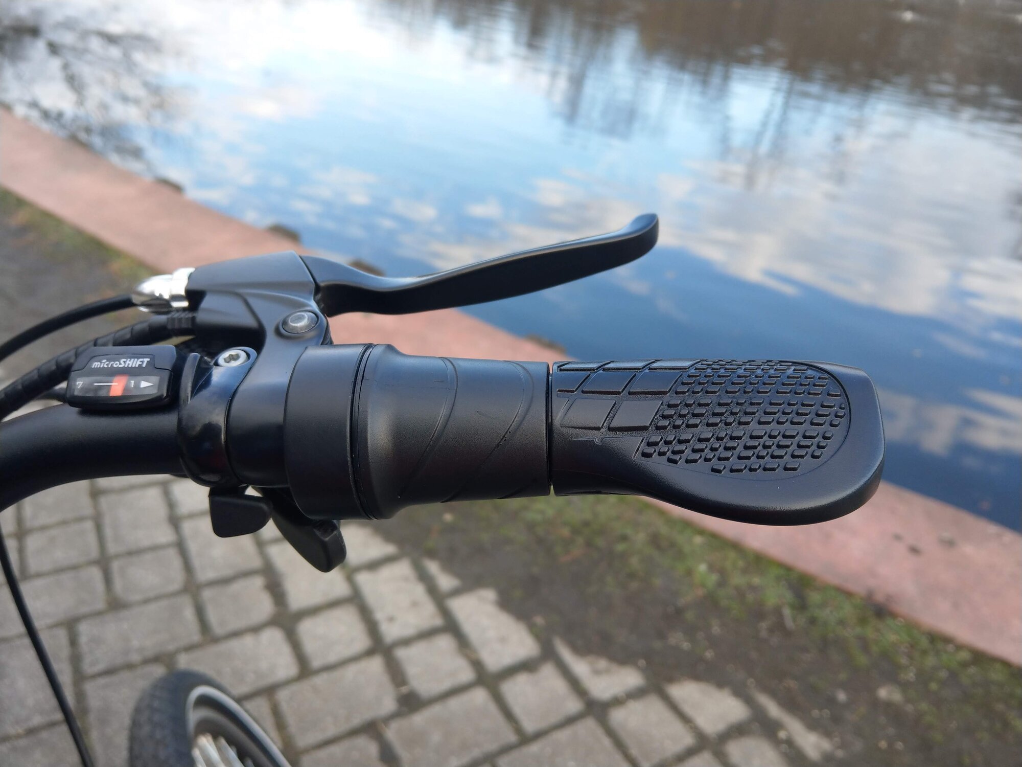

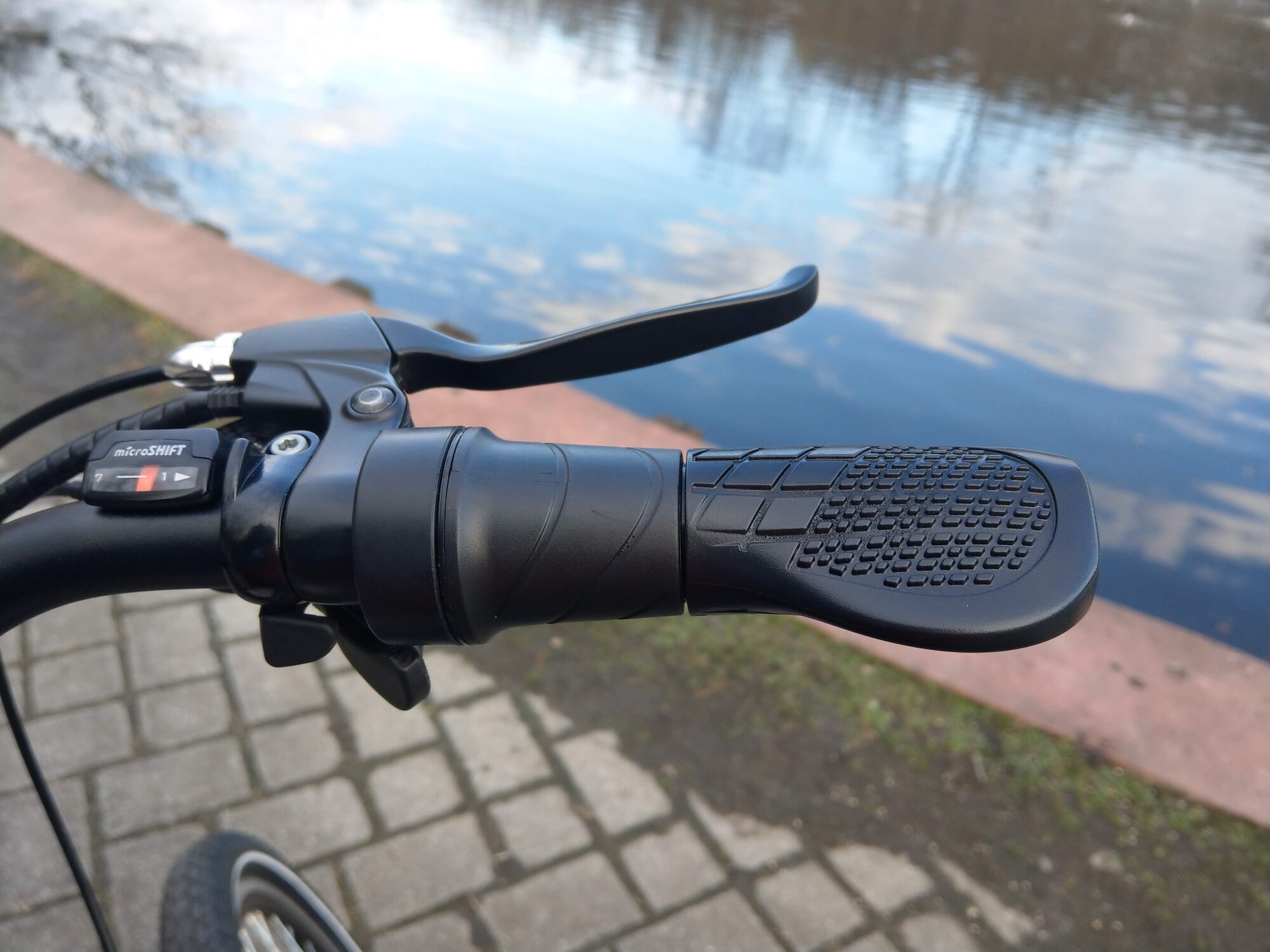

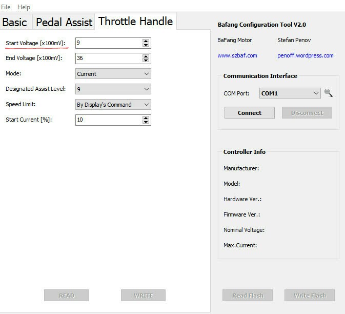

You forgot #FatTyres maybe #BBSXX too....a quick update as I changed my throttle from a full twist to a half twist and I noticed that in the first few millimeters of rotation there was no motor response. Changing the Start Voltage on page three from 11 to 9 corrected the issue. A setting of 8 caused an 04 Throttle Error.
