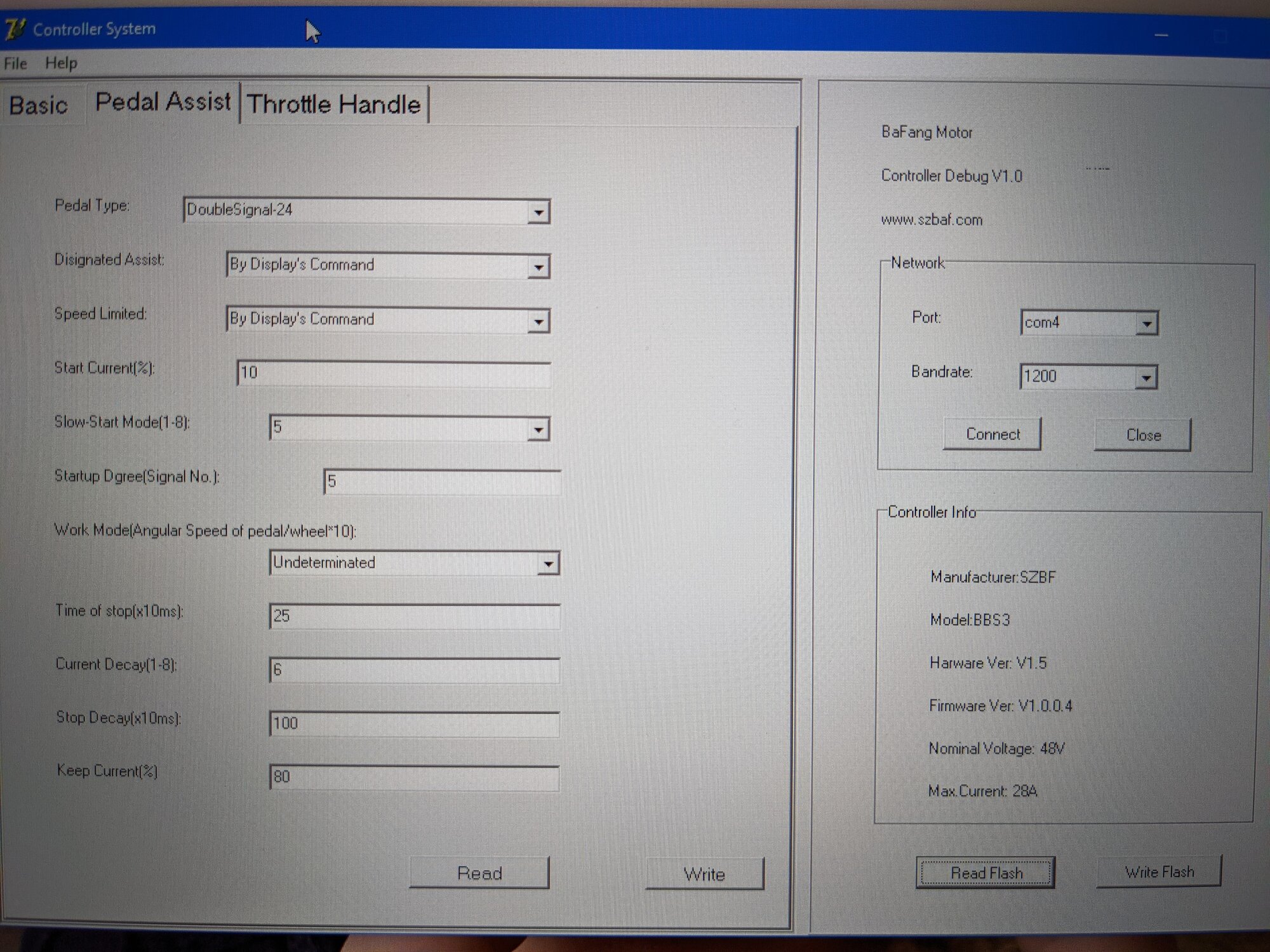

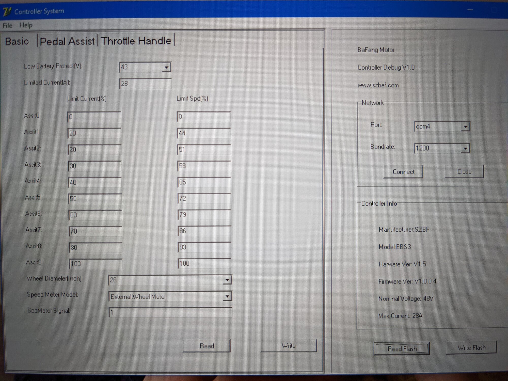

Glad it was helpful.Great thread and I applied your settings to my BBS02 and my initial observation is that the start up is a bit too sluggish so have changed from 10 to 20 and it's a lot improved. To compensate I've also changed the max amps to 18 to lessen the load on the controller. Thanks for posting your settings as they have been extremely useful.

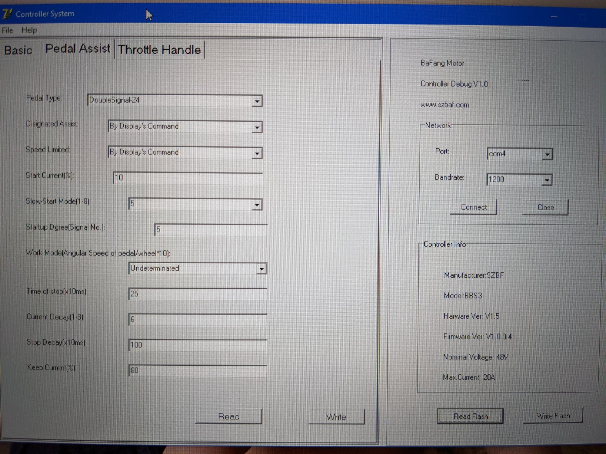

As with these settings... I suggest that you try a personalized version of this recent discovery.
BBS** Settings/Pedal Assist/Stop Decay *Excellent Motor Refinement *
I'm wondering if anyone has played with Stop Decay beyond the typical 0 - 10 setting. I've been playing with setting in the range from 40 up to 120 and I notice a much improved smoothness to both acceleration and riding along at a constant pace. The only way I can describe it is that the PAS...
