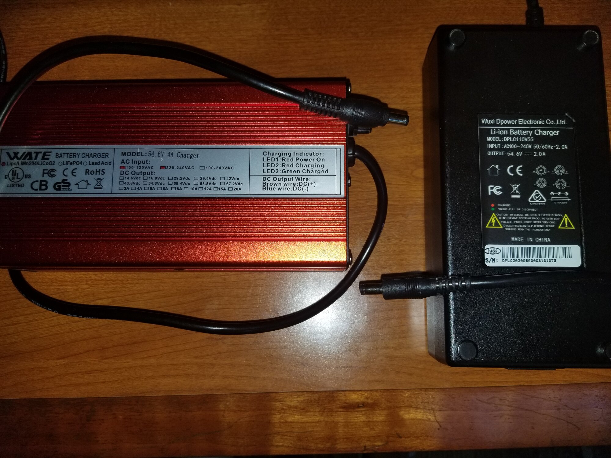

Not sure on the grill but I replaced the cheap chargers that come with the Espin and XPs with a little better charger that has a fan. The old chargers got very hot...

The charger on the left was purchased on Aliexpress for around 60 US. I bought 2. They work great and the fan kicks on right away. They do not get as hot as the black one on the right and I believe also charge a little faster...
Its the fan'd chargers that are more vulnerable, because they have a two-cent mechanical part that, if it fails, allows the charger to overheat and then bad things happen. The fanless ones that use radiant heat to cool themselves are actually more fault tolerant - in that one respect. I'd say ALL cheap Chinese chargers are to be avoided. I've had three of them fail on me. No failures in the years since I went to using Mean Wells, which are effectively the same underlying tech as a Grin Satiator without the fancy UI (I have one of those too).

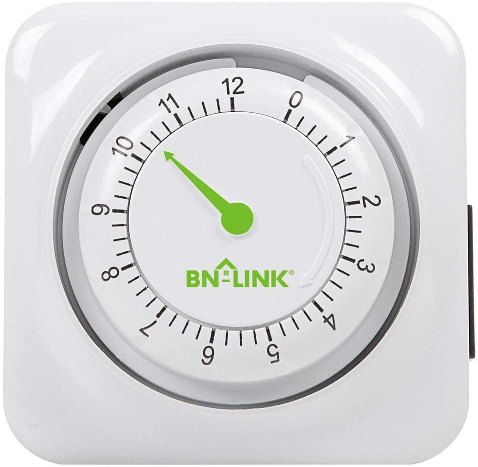

Also, do yourself a big, fat favor: Learn your charge times for your charger (i.e. how much time it takes to add 1 volt to a given pack) and then use this cheap tool as a fail-safe power cutoff. Those chinesium chargers are infamous for losing their ability to stop adding volts. Two of my three failures were chargers that kept on charging.

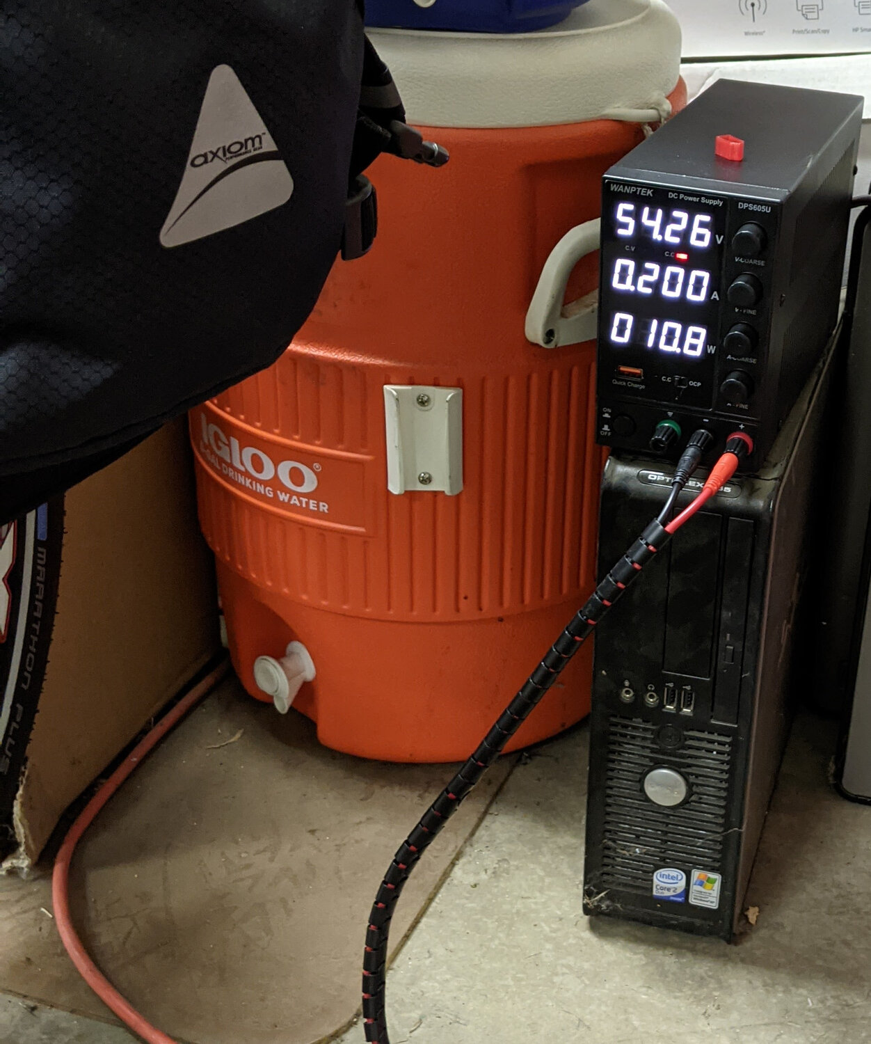

And finally, slower charging is safer. Use an adjustable charger to add in 1a or less. everyone wants fast but thats not good for the battery and really not good for a cheapo battery. If you know how much time until your next ride, and you know your charge increment over time, you can dial your charger down to give you only what you need in the time alloted. This one at work in my basement garage is feeding the pack 0.20 amps. Less than 11w of output.
