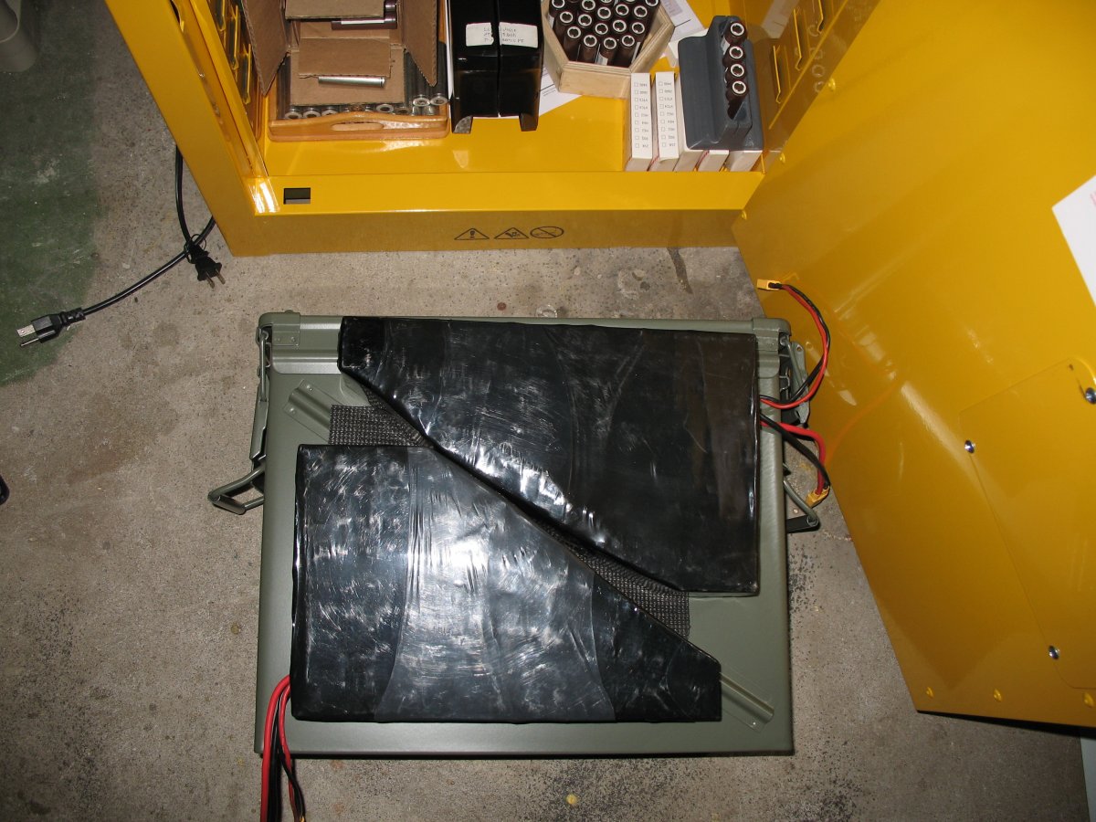

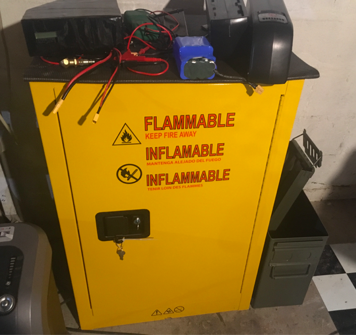

I bought a flammable cabinet from Zoro. About once a year they do a deep discount and free shipping. I'm really wanting a lithium battery rated fire blanket, but for now this is my solution. Sorry to those that have seen me post this manytimes, but here's howmine has developed.
First I bought one of the largest Ammo cans. 40MM
Then I drilled 3/4" holes and protected with rubber grommets.
I removed the rubber gasket and am next adding Ceramic Fire Blanket like used in my wife's kiln.
I really now only need the Ammo Can. I bought the cabinet when I was still building and repairing batteries and doing customer service. But as it turns out I still have 5 batteries and still find it useful.
DON'T FORGET SOME WELDERS GLOVES!!
EXCUSE THE POOR EDITING. Please!

Thats the same can I was talking about earlier. Also known as a 'tall 20mm'. I've seen them marked both ways. I started using them and the shorter 40mm version for camping as it was the best way to keep out the ravens or even a bear from your snack food. Dunno if you've ever seen what a murder of ravens can do to a campsite but it looks like a tornado went thru camp.
I never thought about the grommets though. I have a bunch just like that I can use.

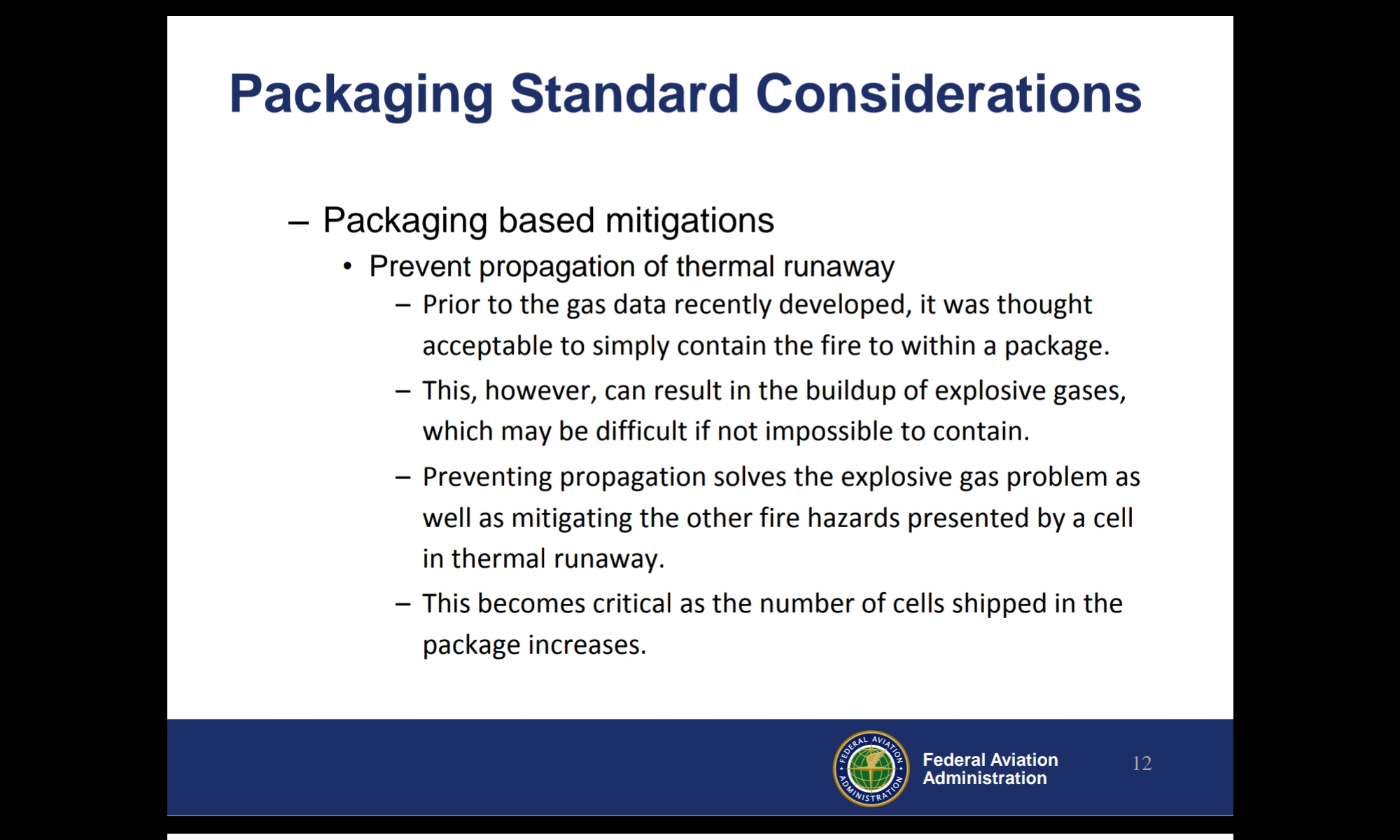

But I think charging outside a bit away from the house if possible surrounded by some concrete block for some containment is the safest solution I've seen so far.
Encasing it further in steel may just trap heat furthering runaway, make it harder to cool with water and if not sufficiently vented may just become a big bomb and possibly hurling shrapnel.

Nice build! I might try the ammo can approach for individual charging but the cabinet would be necessary to store my other 5 batteries.
BTW, I don't use the plastic case for charging, just for physical protection during transport.
I did understand it was for transport. I thought maybe some others might have not realized that. It looks like a good idea! Dropped batteries can be accidents waiting to happen, especially with cheap glued packs.

I do think well ventilated can be better than encapsulation as releasing any potential heat/gas build up before a fire can be just as if not more important as fire containment. Is not prevention typically a better approach?
