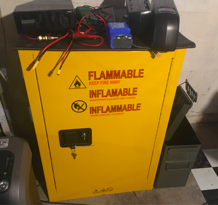

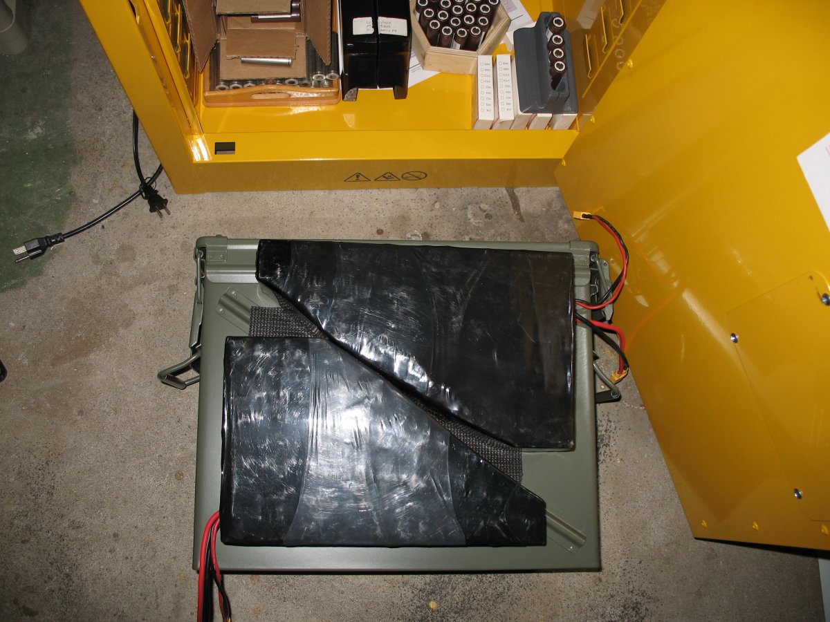

I bought a flammable cabinet from Zoro. About once a year they do a deep discount and free shipping. I'm really wanting a lithium battery rated fire blanket, but for now this is my solution. Sorry to those that have seen me post this manytimes, but here's howmine has developed.
First I bought one of the largest Ammo cans. 40MM
Then I drilled 3/4" holes and protected with rubber grommets.
I removed the rubber gasket and am next adding Ceramic Fire Blanket like used in my wife's kiln.
I really now only need the Ammo Can. I bought the cabinet when I was still building and repairing batteries and doing customer service. But as it turns out I still have 5 batteries and still find it useful.

View attachment 126591View attachment 126591View attachment 126574View attachment 126581
View attachment 126596View attachment 126590
Do you have any problems with the battery overheating inside the closed ammo can? Do the grommet holes provide enough ventilation? My batteries get quite warm when charged and as per mfg. suggestions, usually do it in a well ventilated area.
I'd like to highlight one thing stated in the manufactured battery box descriptions..."for storage and transport"
Dependant on your battery size and charger output would an ammo can be the sole cause of thermal runaway, probably not. But it sure would make it worse if there was a battery malfunction and could potentially be the straw that breaks the camels back and takes it to the point of no return.
That said... depending where you are charging and if ventilated and sized properly, it might prevent a house fire.

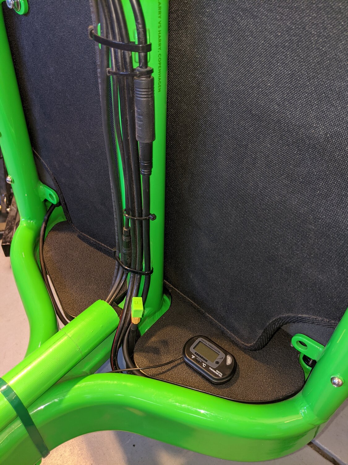

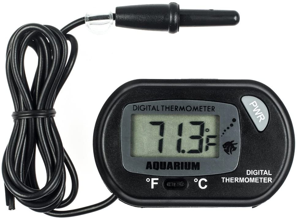

In addition to all the other safeguards I mentioned in an earlier post in this thread, add this one:
I tape this to a surface on a battery and switch it on when I am home or at the office and parking the bike. I want to see what the pack's surface temp is before I begin charging. If the temp is not declining I don't charge. If it is over 100 degrees I don't charge (its in the 100's now outside so its going to be hot no matter what). And if your charger is causing the battery to get hot for sure don't charge. Thats a problem that requires a solution.
On that sensor, if I need to I have it placed so I can leave it turned on and monitor it. If I have to park on the pavement outside Costco (steel wall'd building, blazing sun and concrete) I can monitor pack temp on the ride home and keep to the shade, or sit in some under a tree with dirt under the bike to let the pack cool to ambient.
