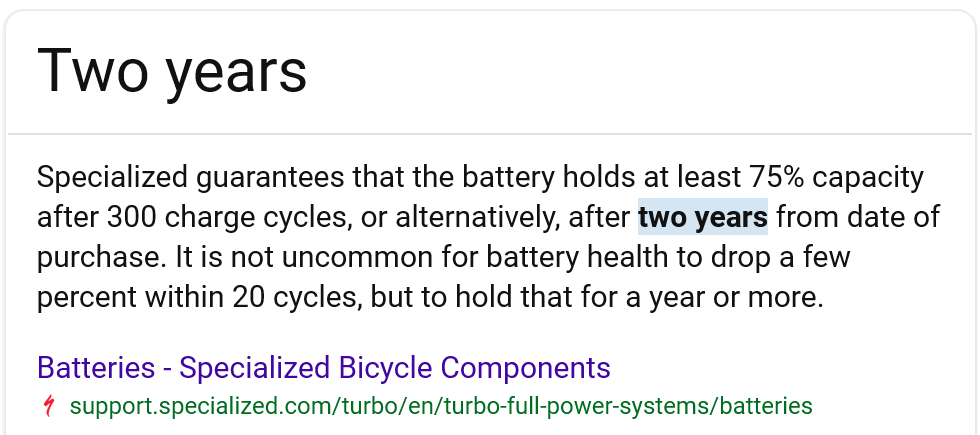

Regarding the Specialized warranty...
Well, the Gray Battery served me well for 4.5 years, then died. That's the life.
Let us consider the Number of Cycles. I was on 445 Vado rides. The number of cycles on the three batteries was 135 + 135 + 61 = 392. Ya, well, maybe.
