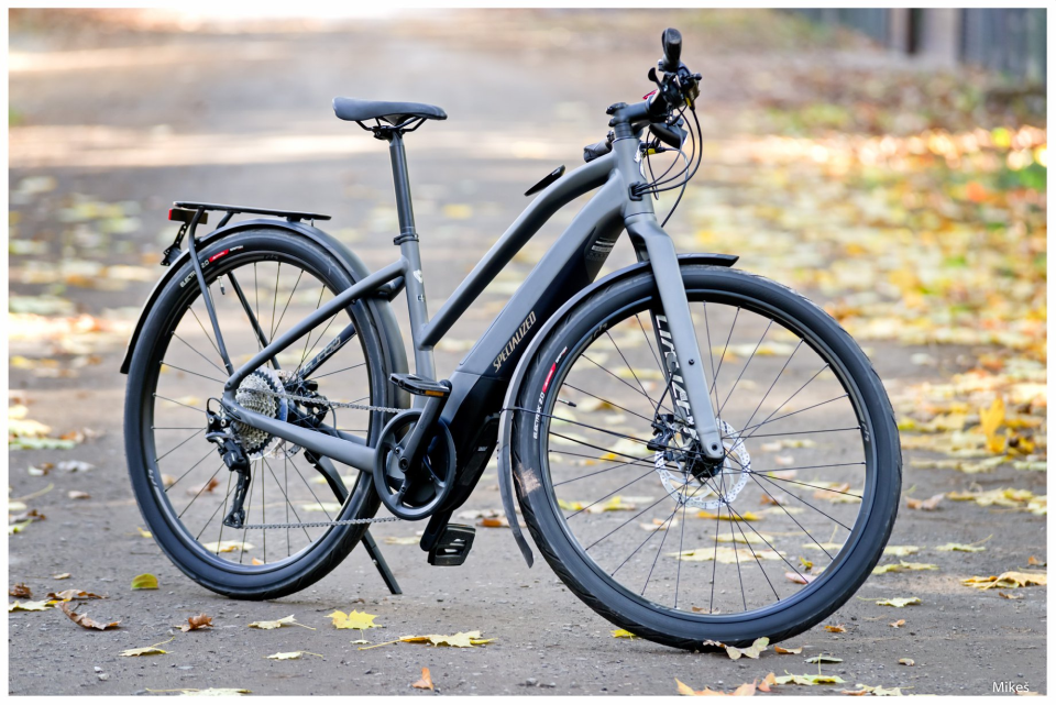

Which reminds me of the day I collected my new Vado from an LBS...
My Vado post her first ride, November 1st, 2019.
There was an youtuber by nickname of WrongWay! (who was promoting DIY built, 100 km/h mini-motobikes pretending to be e-bikes) hanging around. His "e-bike" looked as if was just pulled out of a junkyard :D A big homemade battery was taking the entire frame front triangle. At the sight of my Vado he stood and looked like he was unable to breathe :D It was because the poor bastard could see a quality production e-bike for the first time in his life! He asked about the maximum assisted speed and was impressed it was a 45 km/h, pedal assist e-bike. He was complaining on the motor overheating in his "e-bike", too.
My feeling is the techie at GTX lost his breath, too, when he saw how an advanced e-bike battery was built! :D
