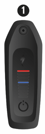

I might be the first user here to encounter an SL Range Extender battery fault here.
Upon recharging the main and SL RE battery (from two different chargers, that is, each battery separately) and reconnecting the RE to a Vado SL, I noticed the Error Code 1
Battery Error.
I have immediately disconnected the Range Extender from the e-bike. Then pressed the battery button to see one red bar and two flashing green bars on the top of the RE. Mission Control reports no RE battery issues.
I'm worried. Things do break. I am afraid of a potential battery fire... At the current time of the year the Specialized dealership does not work...
I do not think anyone has experienced the issue similar to mine?
P.S. After several hours of laying on the balcony (temperature +4 C), the error has cleared itself!
