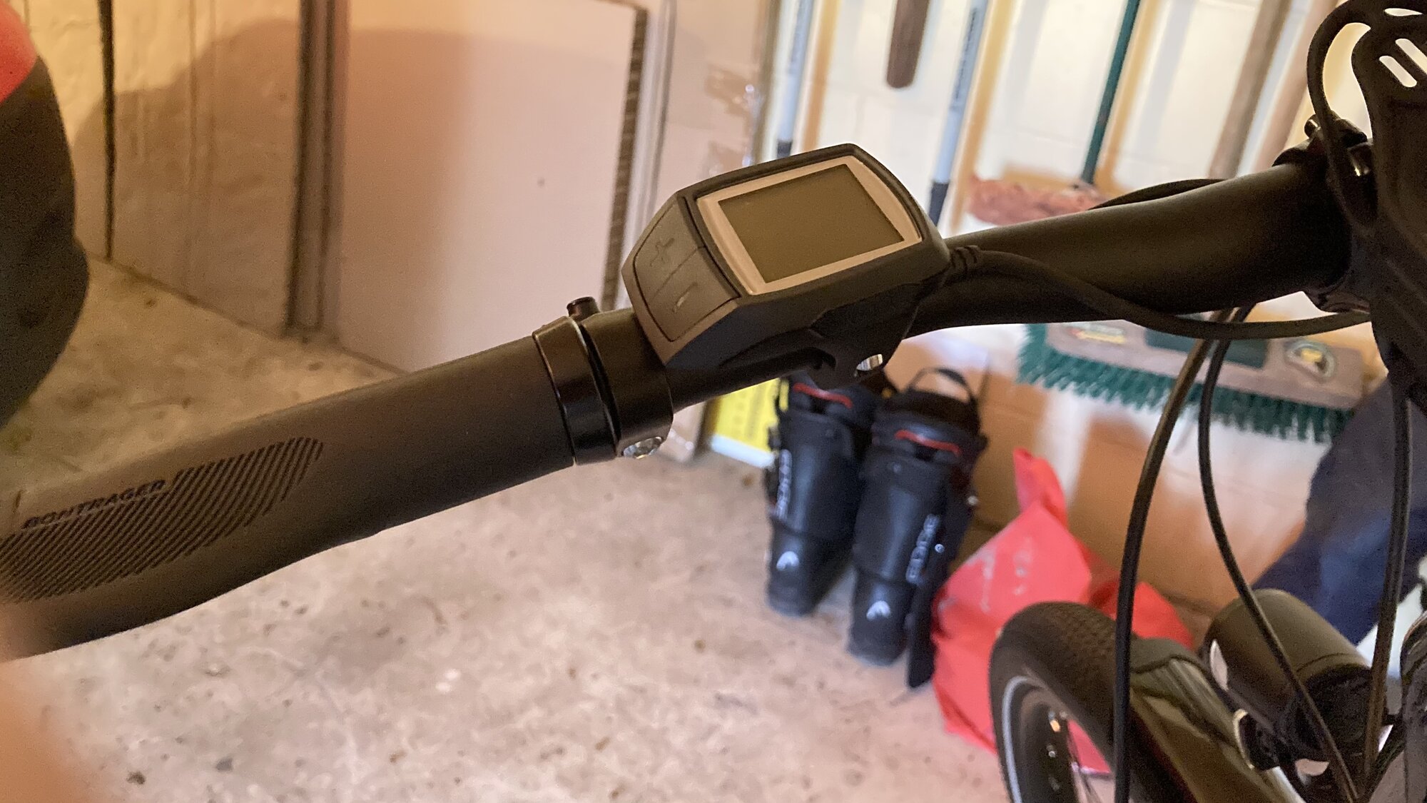

Have anyone swap the bell out for a knog oi? Where do you place the it as it doesn’t fit where the existing bell goes?
I bought one last year for my Trek verve+3 and finally switch to a Allant+7.
It easy to fit, comes with a spacer. On my allant+7 I added a few layer of tape to get a good fit.
I like it very much.

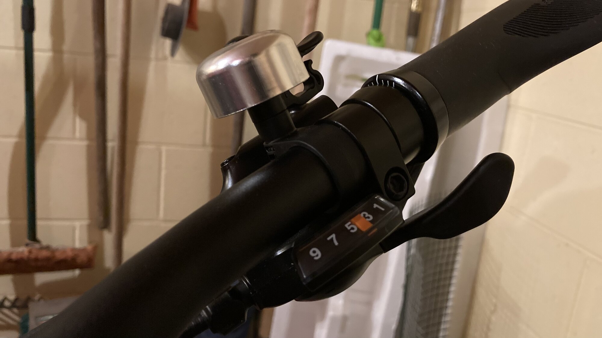

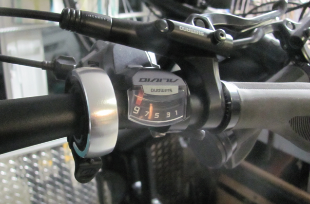

The Oi looks awesome but I was concerned about it’s durability. Who knows though. I went with a different premium bell. Robust, tiny, fairly loud, and has a lifetime warranty. Here is my Spurcycle Compact bell (the compact is their less expensive bell). Just in case you want to see how other bells can fit.
I would love to see a Oi in person. Looks cool. But seems like it might be fragile or maybe make noise when on rough roads.

The handle bar sizing for knog oi is the smaller one. I wanted it to mount where the original bell was mounted but it won’t be able to fit in as there’s not enough clearance between the gear indicator and the bar.
You have moved the positions of your brakes and shifter, how does it felt ergonomic wise?
I didn’t move the position of any of the components. I guess they set up bikes differently sometimes. Mine did not come with a bell, for example. Only the S models come with a bell around here.
Ergonomically it is perfect for me. I can reach the brake, both shift levers, and the bell all without having to move my hand from the grip. I couldn’t reach the bell if it was on the other side of the shifter because my hands are not large enough.
I forgot to mention that one of the reasons I went with the Spurcycle compact was because it was small enough to fit in that gap. The Oi was too wide to fit there.

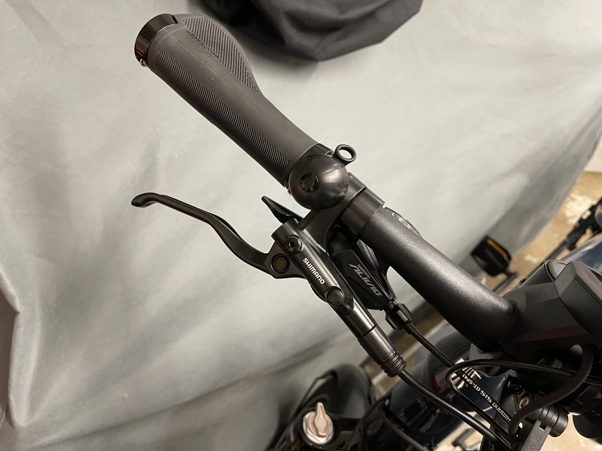

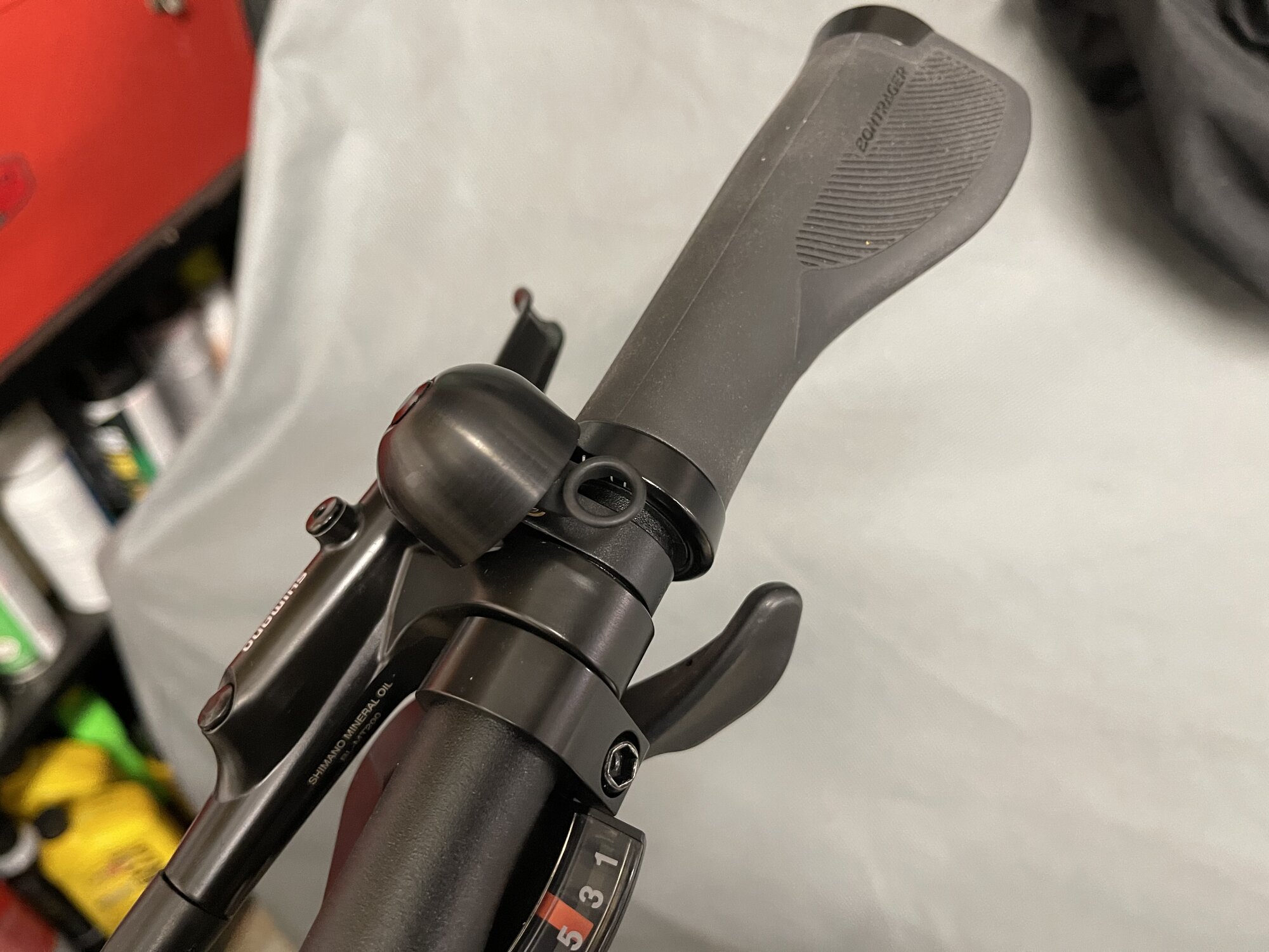

yea I got the +7s. Attached some photos to give a clearer view on my challenges. Another option if I am dead set on a knog is to mount it on the left by moving the purion to the right a wee bit
