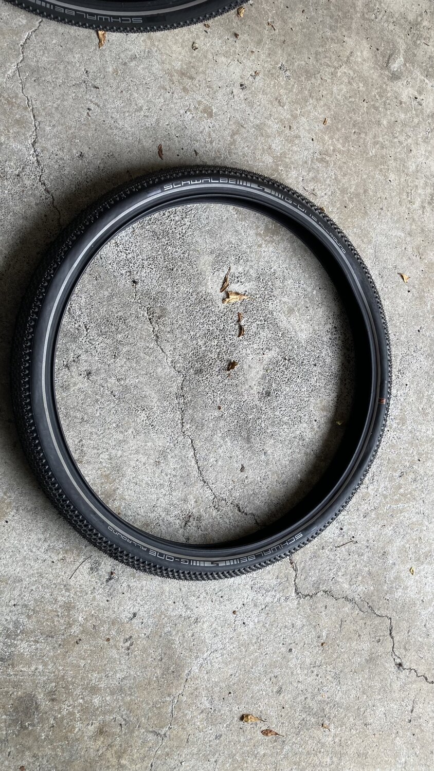

Sweet. When I dropped it off to the bike shop I didn't realize the g-ones are tubeless ready.
They have installed the goodyear peak ultimate on it instead, I'm going to pick the bike up tomorrow, going to ask for the g-ones back so that I can use that in the future.
Thank you for sharing ;)

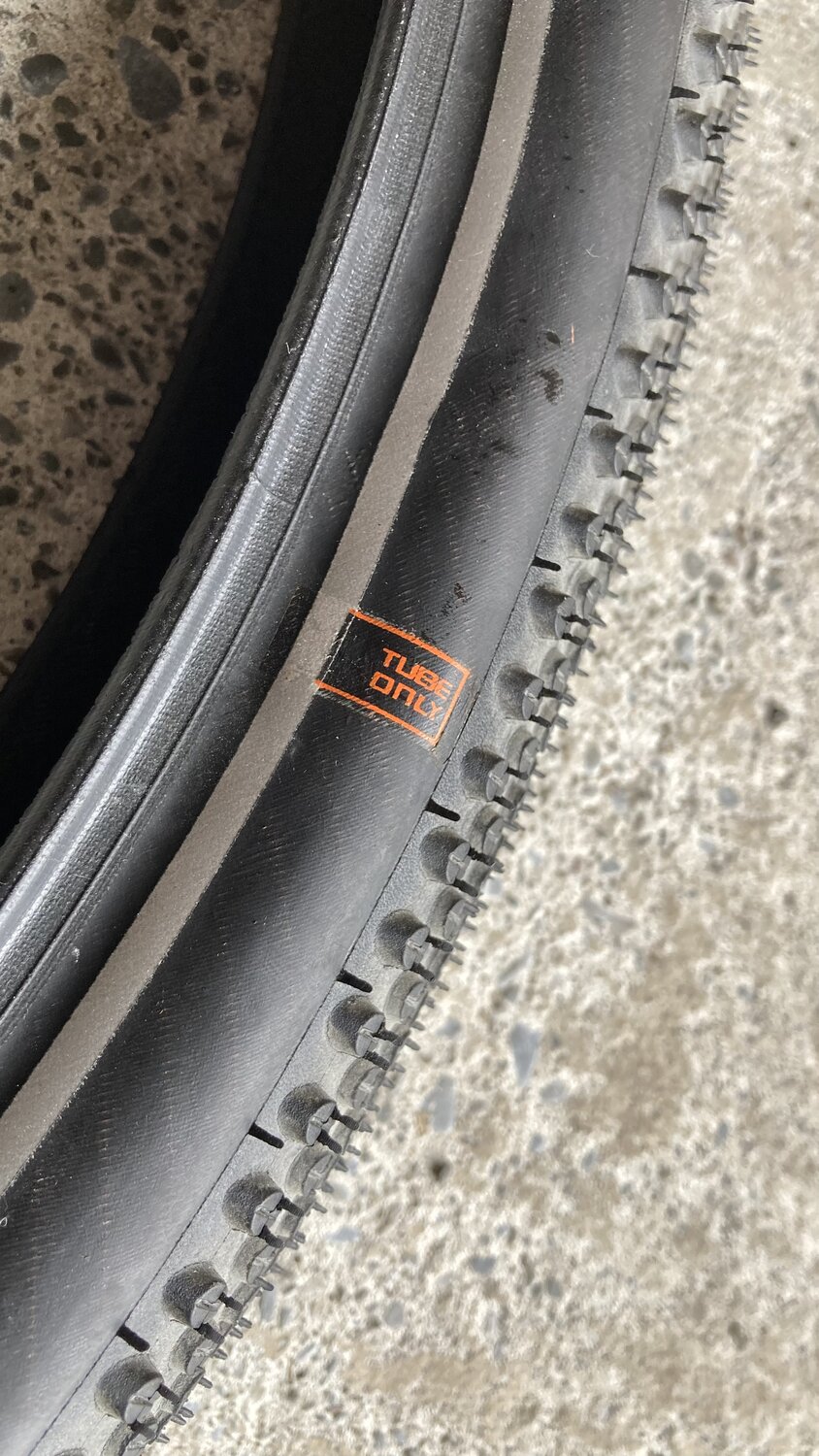

Well, got the original tires back. Strange it wasn’t tubeless ready though.
Strange. Schwalbe define G-Ones as Tubeless Ready and my gravel riding mates use them tubeless.

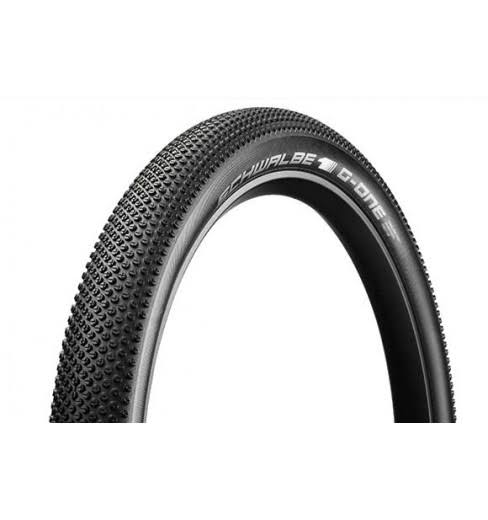

Judging by the tread, G-one would be faster. Goodyear Peak Ultimate resembles a Schwalbe Smart Sam. That is, the Peak would roll silently on the pavement and offer good grip on gravel and in mild off-road but at a cost of somewhat increased rolling resistance.
Not that would matter a lot for you Justin! Bear in mind your Allant+ is equipped with a powerful motor that would offset the difference easily. I have run Smart Sams on both my full power and the lightweight e-bikes for a long time to my utmost satisfaction. Only recently, I've started thinking I might be better off with G-ones on my less powerful e-bike as I'm searching for anything to make it roll more efficiently :)

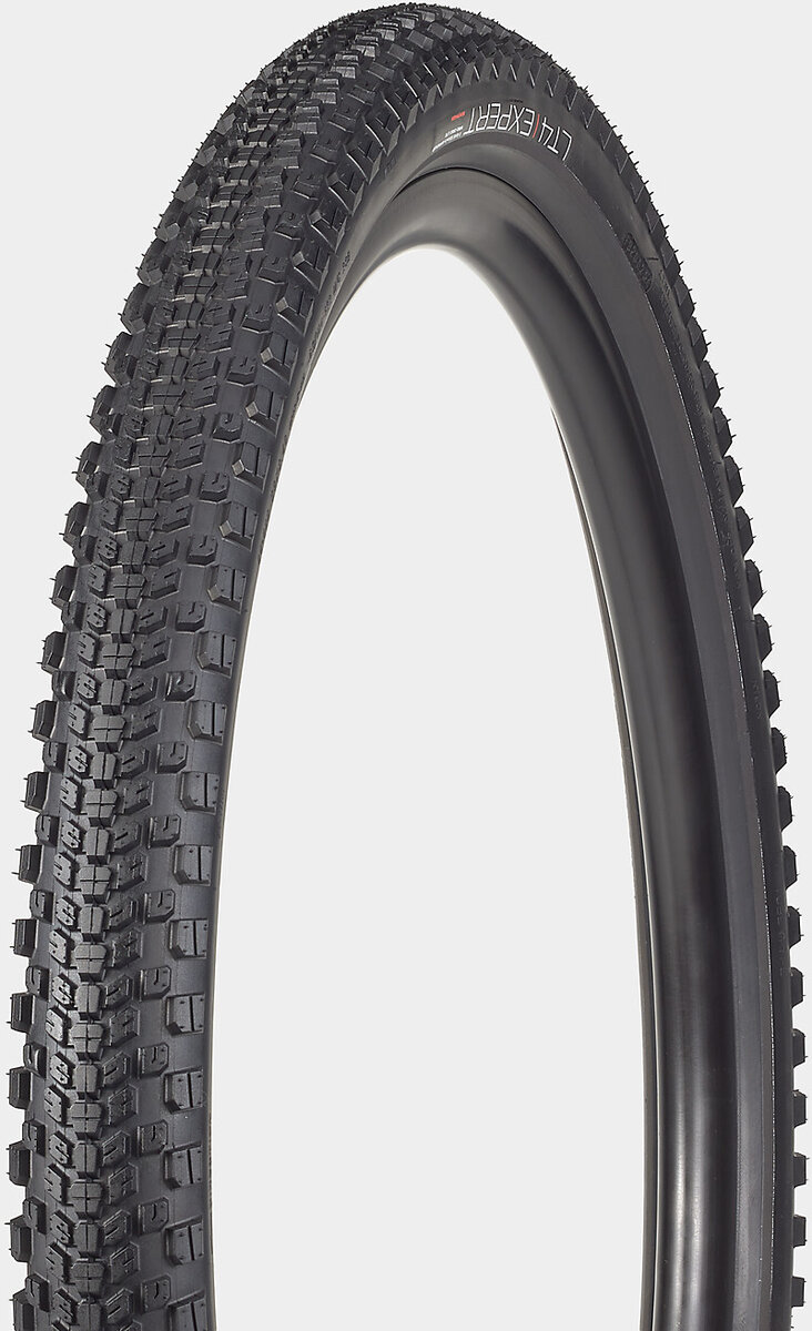

got these for our Allant+8S bikes since i liked them so much on the Powerfly. Bontrager LT4 Expert. Really good in sandy soil and quiet on road. the standard Allant+8S tire is almost a slick.
Not without a reason. This is because that tyre has a low rolling resistance (being wide at the same time), and additional compound makes the tyre soft and sticky. The whole idea behind is to facilitate reaching higher speeds such as 28 mph while making the road ride safe. The same concept is applied to Euro 45 km/h Specialized Vado 6.0, where the Electrak tyres are pretty similar to Bontragers in that respect.
