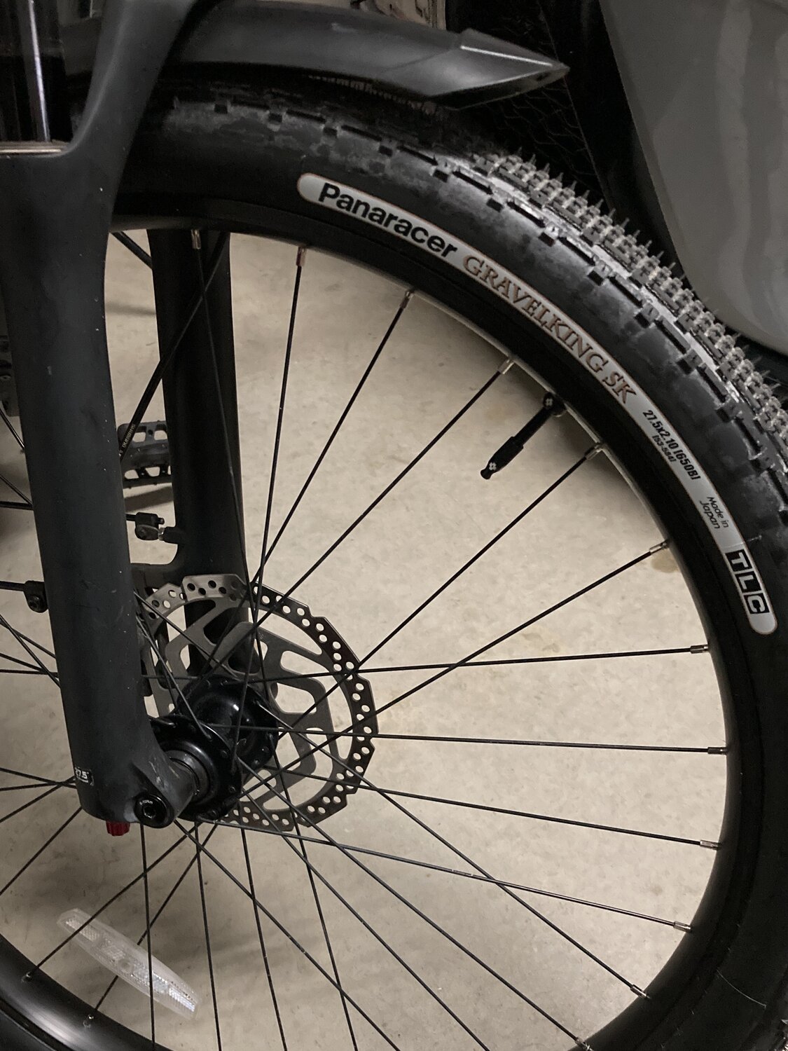

Also, FYI, different topic, I just replaced the Schwalbe G-Ones with Panaracer Gravelking SK tires. Loved the G-Ones but they are no match for prickly things on the trail. Even with Slime. Going tubeless. As soon as it stops raining I hope to test them out.

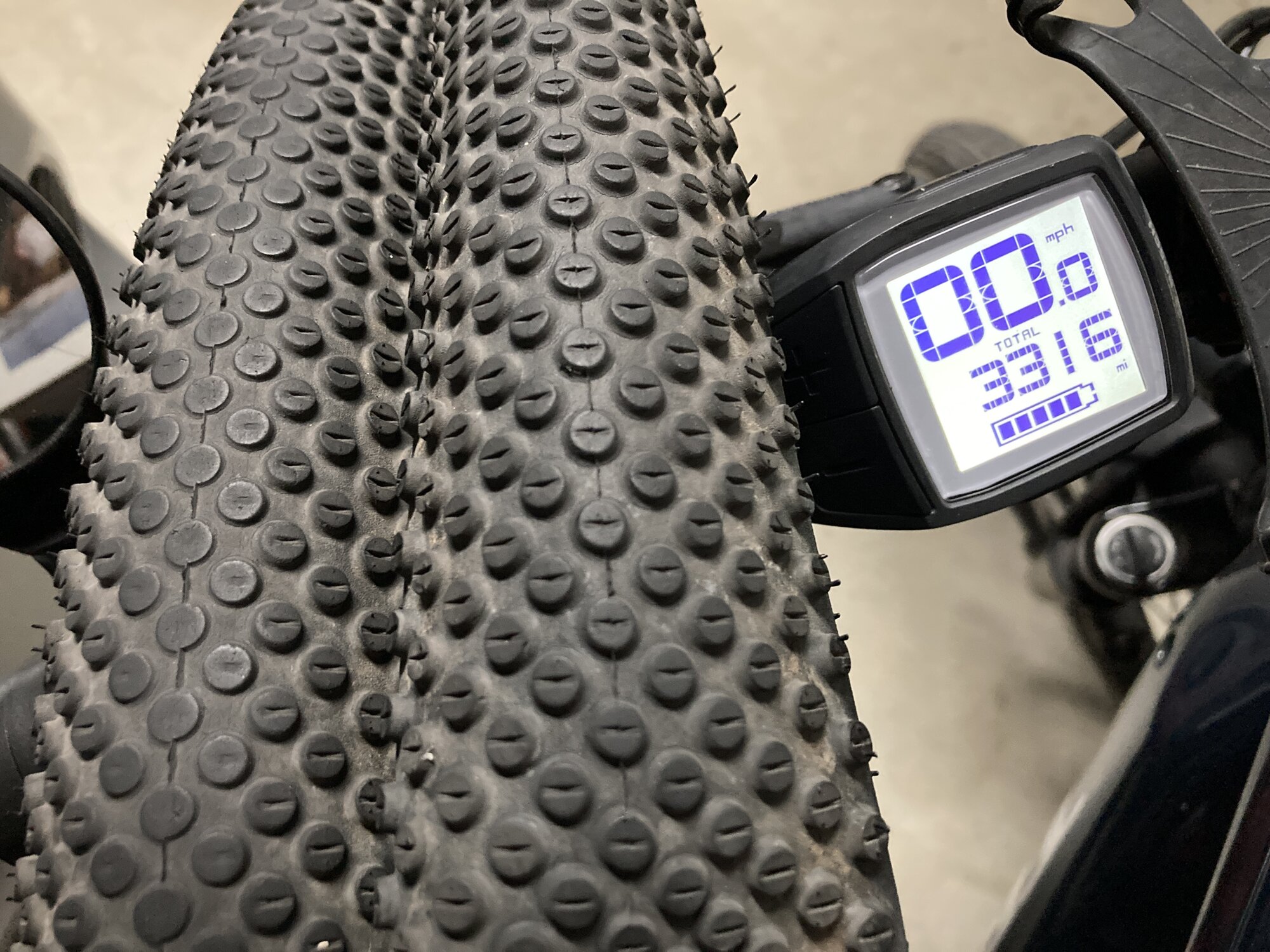

What was your mileage with the G-ones?? I have liked them but it seems, at least to me, that the wear has been quick. I am at 1400 miles on them. Not ready for the trash bin yet but the tred has worn down.

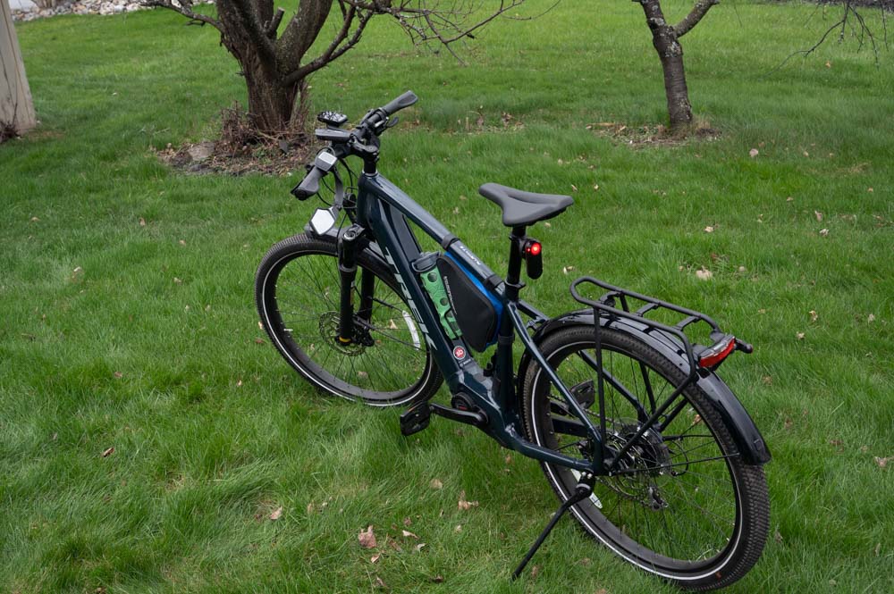

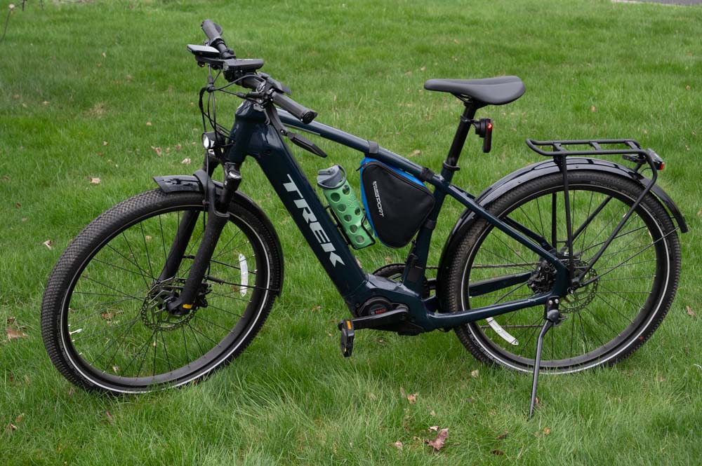

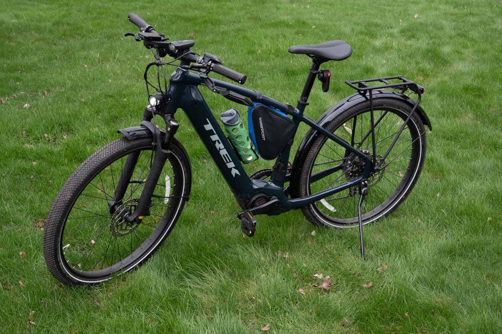

Here is my Allant7+ S which I like a lot. It opened my eyes to how expensive some bikes can be. Quality of course.
Got this in Jan of 2022. So far about 93 miles on it. Had to wait for the snow to melt and salt get washed off the road.
I live in a hilly area. This is the bike I need to get up those hills especially when there is a head wind.
You can see the tire wear (rear left, front right) and the mileage less 20 put on yesterday after buying the Gravelking SKs. Most of those miles were ridden at above 27mph. FYI, per tire wear, weight=155, 45psi. I ride fast and hard when solo. 90% pavement. When I am on gravel I like to brake-slide my rear tire to impress my wife riding next to me. She said it doesn’t work. It’s still fun. Just like when I was a kid. I grew up in the country with all gravel roads. The new fad is not new to me.
Sad to give up the G-Ones — very good tire, but highly pervious even with Slime. I felt could not depend upon a ride with no flats when riding in Arizona. I am very pleased with the Gravelkings so far. Much quieter than the G-Ones, and I assume less noise = less resistance. Although I never felt that a problem with the G-Ones. $270 for the tubeless mount, tires, parts and labor.
I definitely pray for no flats as there is no way I could break the bead and insert a tube on the trail. My Lbs guys all confirm no flats, but may need to refresh the sealant every 3-6 months — it could be used when self-sealing multiple thorn holes, etc., or as it dries out. Definitely will do just prior to heading back to AZ for the Winter. Free refills.
