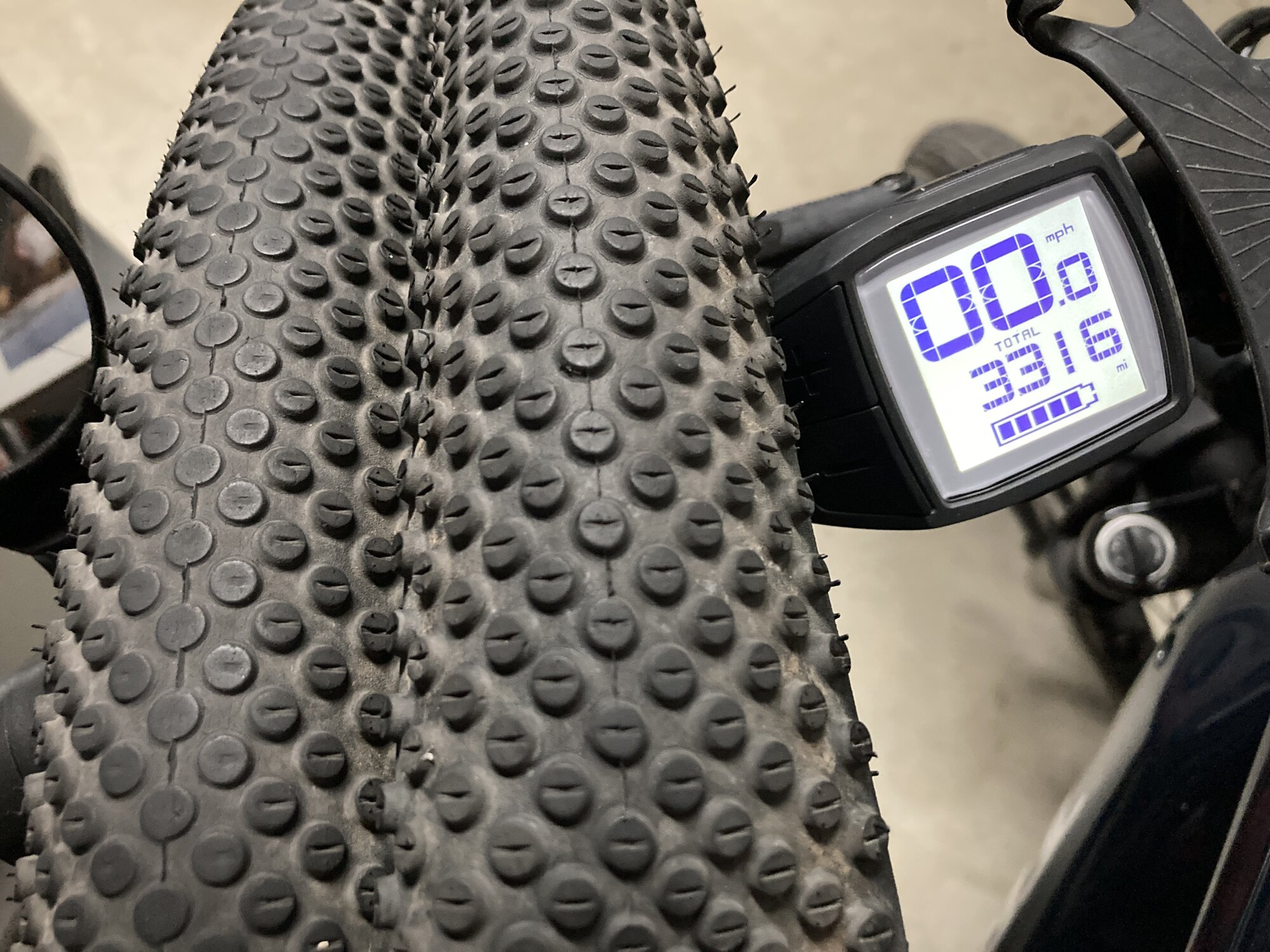

Picture showing G-ones when I replaced them at 3,300 miles. And I like to slide my rear tire for kicks. 2,200 on Panaracer Gravelkings, tubeless, and just replaced the rear tire. And no flats with tubless!
