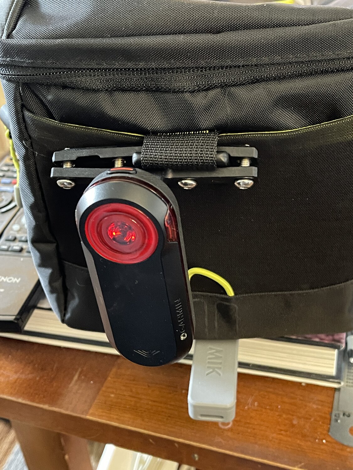

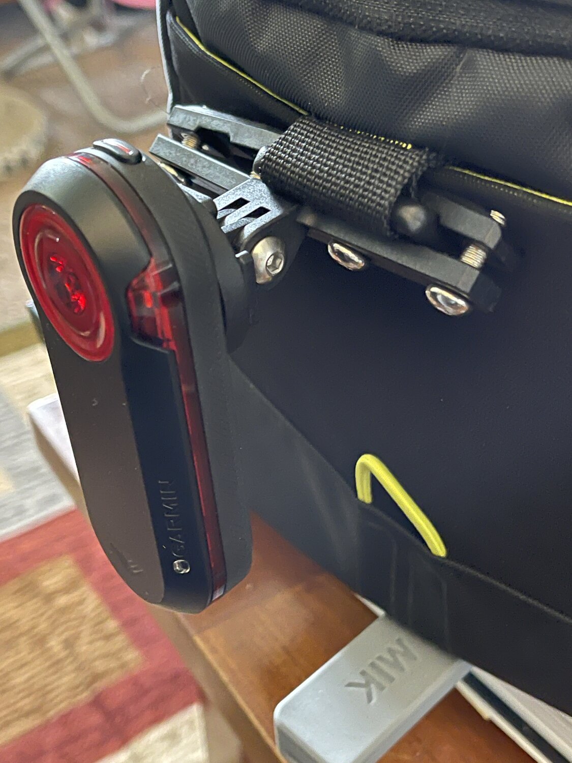

I hope that this post doesn't violate the thread but I struggled to make room for my Garmin Varia radar on my MIK Bag. I finally solved it with purchasing a small item from Amazon and attaching it to my bag as shown in the pictures below. I'll do a test ride later today. I may attach a zip tie from the mount to the yellow band on the bottom to prevent any wiggling of the mount.
What's the advantage of Garmin radar over a mirror? I find my bar end mirror does quite well. Am I missing something?
I have both. I find the radar very dependable and useful, warning me of cars quite a distance before my ears pick up the sound of them. Especially with electric cars which at times don't make any sound.
Yep its lets you use your ears more then your eyes to know what's going on behind you.
Interesting. I live and ride in a rural area. It must be much quieter because I often hear the cars long before I see them in my mirror! This is especially true where the road is curvy.
Thank you both for clarifying.

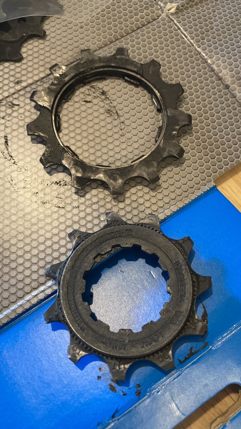

My chain is skipping like crazy on the smallest sprocket over the past few days. I am going to take it back to the shop and ask them to change it from 11t to 12t.
Before you change cassettes, try re-seating your axle in the frame. Loosen and re-tighten the axle. That solved my chain skipping problem. Worth a try. Changing gear ratios can open up other problems.
Well… the bike has been in and out of the lbs now. I was going to do the axel thing that was suggested but I have a tight schedule over the weekend so the bike went in a day early before I get to try the new fix out.
Anyway, new cassette and new chain. Got the shimano xs-hg-400-9 11-12-14-16-18-21-24-28-32T. So hopefully I’ll be riding the 12t more than the 11t. I can see the old cassette has quite worn out 11t.
My daily ride involves a lot of flat road hence I am always riding the 11t. At the same time I have one steep uphill bit which requires me to use the larger sprockets.
Would be ideal to have 11-12-13-15 and then something 30+t on the largest sprocket but doubt you get that on a 9 speed.

Upgraded to Trek’s ebike chain — which Trek does not provide as standard equipment, and Shimano Deore derailleur. Cassette, not sure of brand. All were recommended by Trek technician. Next upgrade may be to a 10 gear set.
I experience the same chain skipping as you in the smallest gear. Many have tried to adjust it, but the problem persists. Best temporary fix is frequent cleanings and lubes, but problem continues.

I have tested both and I would get 2500 miles on a regular shimano or kmc chain and 3000 on a e bike chain. but the e bike chain is almost twice the price.
I have some chain skip but it is during shifting with the derailer trying to find a gear. I'm sure I need some adjusting in cable length and derailer.
Per chain skip, look closely at worn teeth in your cassette. I replaced mine at 1,250 and again at 3,550 miles for chain skipping. I kept thinking chain or derailleur but both are still good at 5k miles. However, I ride fast and hard so your mileage may be different, but I now know better and will likely change the cassette again as soon as chain skip starts again.
I replace just the smallest gears(s) on the cassette usually once then replace the chain and cassette after skipping starts again …or should I say the shop does
I have been hoping for the worn cassette solution you describe, i.e., just the worn gears which for me have been the outside/smallest two. I have not found a supplier — maybe I am not looking in the right place?
