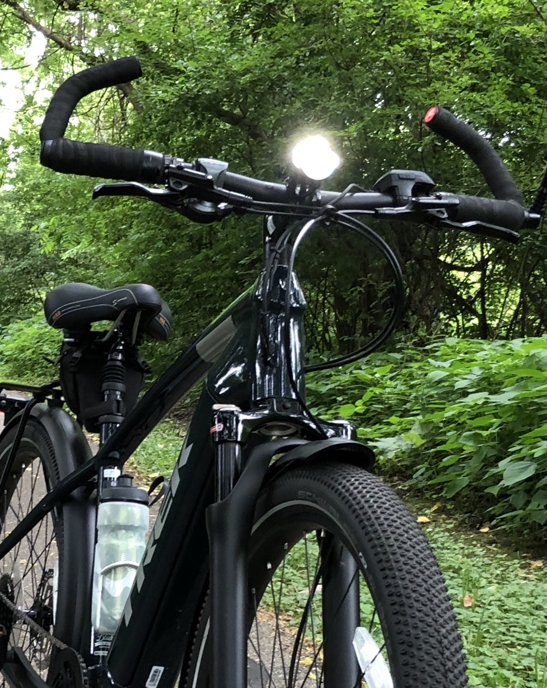

View attachment 58581View attachment 58582View attachment 58583
How do you like the nubby tires and suspension fork? Better on gravel and uneven pavement?
