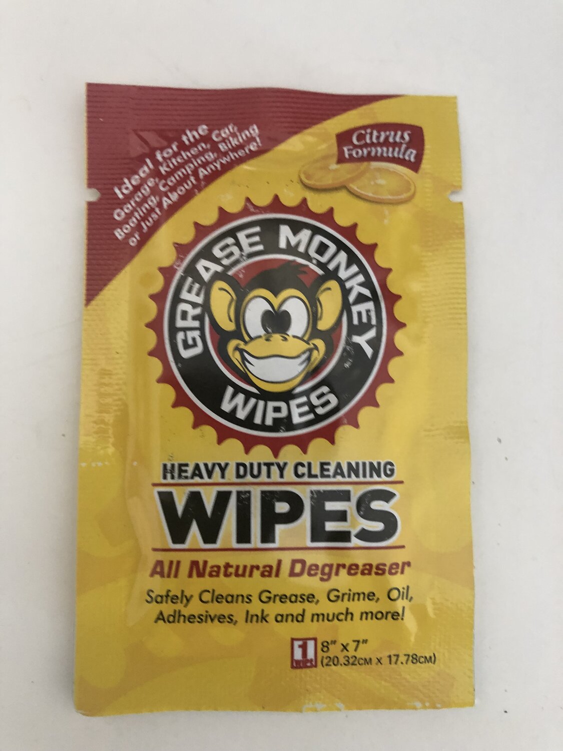

I’ll add: Children’s chewable Benadryl tablets, band aids, Grease Monkey hand cleaners, nitrile gloves
So true! Totally forgot about the gloves. I have used them more than once. Once for me…once helping someone else.
These work.
