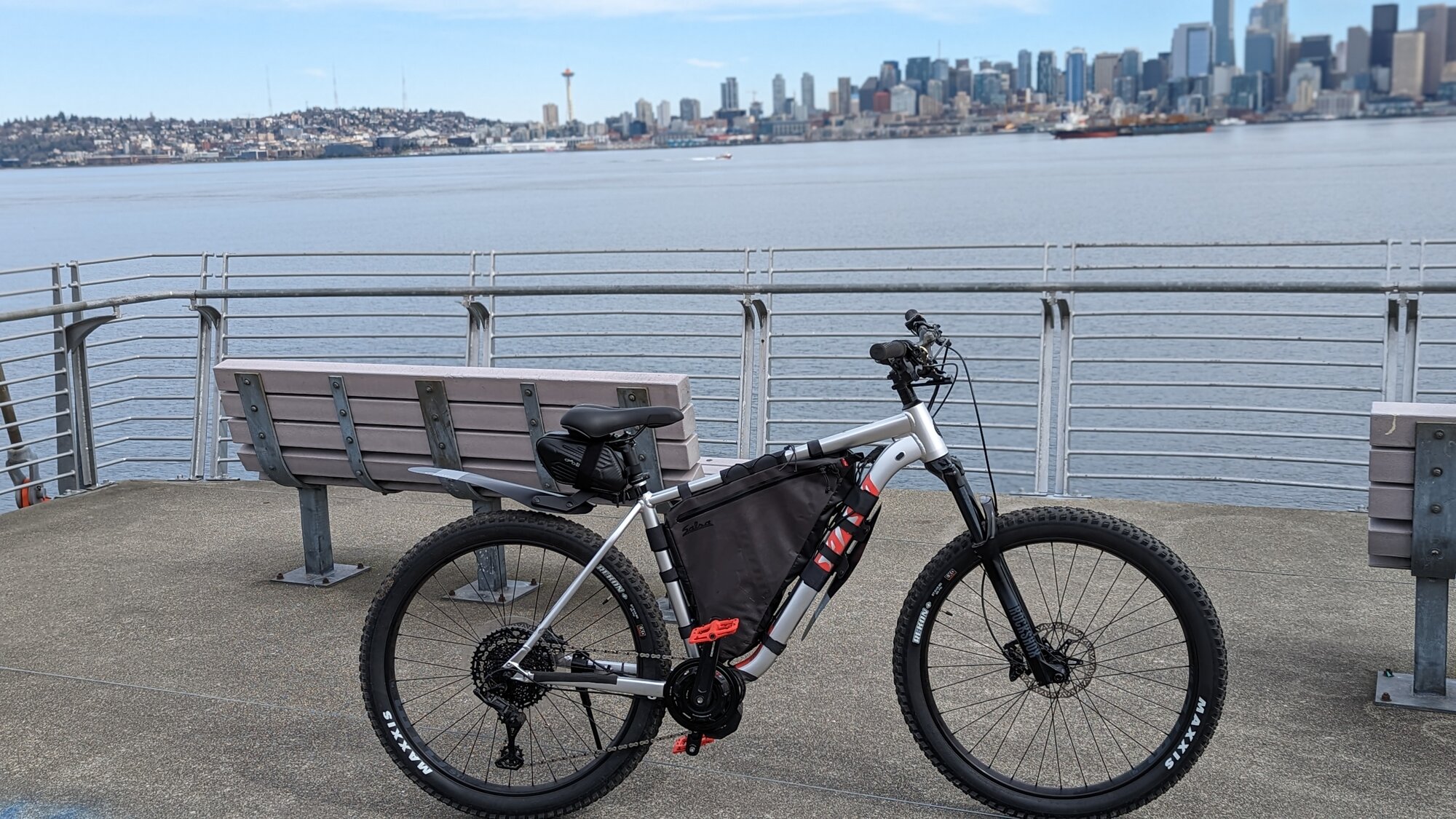

Yeah, I added up the cost for my latest BBSHD build
$520 Luna Bare Motor
$30 stock crankarms (seem to work for me)
$90 eggrider display (other displays are close in price)
$16 stabilizer bar (Full suspension, I just prefer to use these)
$145 Lekkie BlingRing 42t
Total $809
Thanks for the link to the backpack battery, food for thought
I have 60mi on it so far, I'll post more info once I hit 100. So far it has been perfect.
