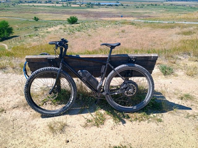

Bridge Club RH212 updates
As mentioned previously, I bought a Surly Bridge Club frameset to play around with hub drives again (second time I have owned one). At the time I purchased the frameset I was thinking of revisiting a Nine Continent RH212 DD hub motor with statorade I have lying around. I previously used this motor on this frameset but my wheel build was plaqued with 'spoke nipple noise'. Im pretty sure I misdiagnosed the issue back then blaming it on the rim(specifically the steel eyelets). Basically the nipples would creek unless I kept them oiled. At that time I had built about 5 wheels and all have worked fine with only fine adjustments required even to this day. I did that wheel build with elbows out at the motor which yields a spoke tension ratio of 30:70 which is more dramatic than my gmac build which was 39:61. One thing I didnt do was 'recheck the spoke tension' when the noise occurred. I have heard people mention having to retighten the spokes on RH212 builds so that may have been the issue.
The new RH212 build is using velocity USA blunt 35 rims. These rims are pricey at $120 each but are one of the only 36hole rims with a 30mm internal width which is about ideal for the range of tires I use (2.4 to 2.6, 2.8 occasionally). The only other option is Halo USA SAS downhill rims which I used on the original RH212 build. DT swiss also makes one I think as well but its like $180 and out of stock everywhere. I am going to use 1 cross spoke lacing on this wheelset instead of the 0 cross/radial lacing I used last time. I will also be using elbows out on the drive side and elbows in on the disk side which yields a spoke tension ratio of 34:66. Hopefully all these changes will keep the spoke noise away (Im guessing they will).
Since most hub drives at this time seem to favor 135mm rear spacing, the bridge club frame seemed like the best choice. Note that the Grin All Axle rear DD motor can accomodate many different rear spacings. I am tired of the hassle of quick release and disk brakes. Its almost impossible to reattach the front wheel without having to adjust the brake calibers. Surly sells a boost thru axle fork for the Lowside Dirt Jumper Frame with only 2mm more offset than the bridge club frame so handling should be about the same. Only problem is its pink. The color is called 'pig smell' and its the ugliest color I have ever seen so I painted it black.
The build is done and I took it for a ride in 95F weather today and beat the snot out of it and never saw motor temps more than 60C. A true beast of a motor. The battery is now the limiting factor (EM3EV 52V 17.5ah pack with about 250-300 cycles). Ride was 25.67 miles, 1348 vertical ft and average speed of 18.9mph.
See attached file for latest build. The front wheel/tire(27.5x2.8 Maxxis DHF) is temporary and was pulled off my Luna X2.

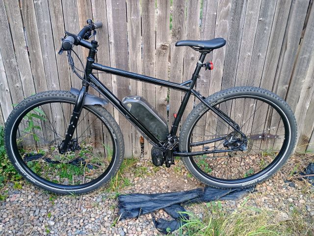

Surly Ogre CYC Photon Build to sell
I built up the Surly Ogre to sell as an acoustic bike, then got the news that CYC will be coming out with a Gen 2 so decided to put the Photon on the Ogre and sell it as an ebike with one of my 52V 17.5ah batteries. See attached pic.

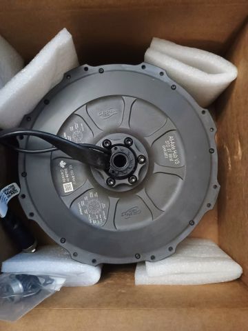

Grin All Axle Rear DD Motor
I recently purchased and received a Grin All Axle Rear Motor(with statorade). What an absolutely beautiful motor and five# lighter than the RH212. Not sure what build/bike this will go on. With adapters, it could fit on any of my current builds.

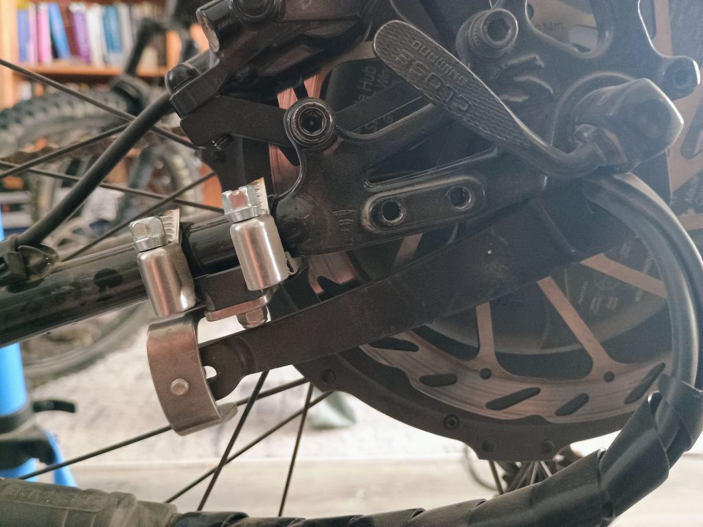

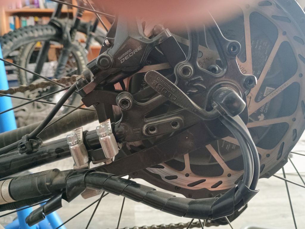

Grin All Axle Install Issues
I have been struggling getting the Grin All Axle motor installed in my Surly Bridge Club. The biggest install issue is the torque arm mount. It either interferes with a a rear brake line zip tie mount or just barely fits with the mount turned around front/back. In this position one of the hose clamps isnt 90 degrees to its mounted location so it slides as its tightened. This is workable (for now) by fiddling with the two hose clamp mounts to get a good compromise. The only other downside is the motor connector cant be tucked under the chainstay because of the torque arm chainstay hardware so it stick out to the side which can be hit by my foot in some scenarios. The latest Bridge Club comes with a kickstand mount and I think the best solution would be to make an adapter to be able to bolt the torque arm to the kickstand mount. I initially made one out of 5mm steel plate (just had lying around). The 5mm was fine without the QR tightened down but caused too much side force on the torque arm when tightened down. I bought some 4mm aluminum plate and it looks ideal but wanted to go for a ride first.
This motor is also made for vertical droputs so putting it on an Ogre with horizontal dropouts might not work although the Ogre dropouts(145mm spacing) can accommodate 142mm or 148mm thru axles which this motor is supposed to support.
The Bridge Club is also not the best if you want to run a larger front chainring and still have access to all the gears. It takes about a 53mm chainline to fit a 42t front which IMHO is the minimum front chainring size for an ebike with this speed potential. When I was using the erider torque sensing BB, the double chainring spider wouldnt work with the chainring on the inner position (49mm chainline) and had to be on the outer position (56mm chainline). The fix was just not use the lowest gear by adjusting the derailler. In reality I doubt I would ever need a 46t gear in the back with a DD motor so not really an issue.
The Ogre easily accomodates a 42t chainring with a 49mm chainline
Phaserunner and Cycle Analyst was setup according to Grins instructions for the All Axle Motor with integrated torque sensor.
First Ride Impression and Failure
Love the quiet DD motor
The first 10 minutes or so was awesome. While it took some getting used to the torque sensor in the cassette vs the bottom bracket (torque values change with gearing) it was doable. I also set it up for regen by pedaling backwards (the farther you pedal backwards, the more regen). I previously had regen setup on buttons like assist level. Having it on the pedals was AWESOME and I immediately started using it all the time.
After 10 minutes, the torque sensor started acting up. Basically you could see on the CA display, there was a constant torque setting being shown although I was not inputting torque. As such the bike was now outputting constant power which got dicey. At the time I noticed this, it was outputting 1000 watts so I started using the brakes ALOT until I figured out that the constant output power could be controlled with assist level. When this started happening the backward pedaling regen didnt work anymore. It seemed to be resettable by doing regen thru the assist level buttons but kept returning. I also have a mode setup for PAS only which has always worked fine with the Erider BB but got 0 watts output in this mode.
Ok, while this all pissed me off, perhaps the answer was just go back to the Erider BB.
So I then decided to do some full throttle testing going up a slight incline of 2% or so. Motor was awesome till about 75C when it felt like the motor/controller shutdown. In reality, something mechanical in the motor was rubbing to the point of stopping the motor. It felt like the rotor was contacting the stator due to the vibrations I felt. I had to wait a few minutes for it all to cool down but still felt rubbing till it got below 70C so the rest of the ride was now just using assist level to control constant power output and keeping the temps below 70C.
Note that this motor had statorade injected by Grin.
So it appears the All Axle motor is a failure for me. I will be contacting grin ASAP and hopefully can return and get my money back. While I love the design of the All Axle motor, Im not willing to pay the price of whatever it takes to get it working. For the $$ it costs, I expect more. I have used and loved Grin products since 2019 but this motor is a failure for me.
I also prefer the feel of a torque sensing BB, in addition it computes human power which I log for fitness comparisons.
While the All Axle motor should have been everything I wanted in a hub motor, I am just going to stick with my RH212 and GMAC.

Grin All Axle update
Grin responded pretty quickly with some things to change/verify but I am back running the RH212 and erider BB. I dont feel like swapping out motors over and over and am just going to return it.
I dont think the motor was locking up as much as trying to apply maximum regen for some reason
