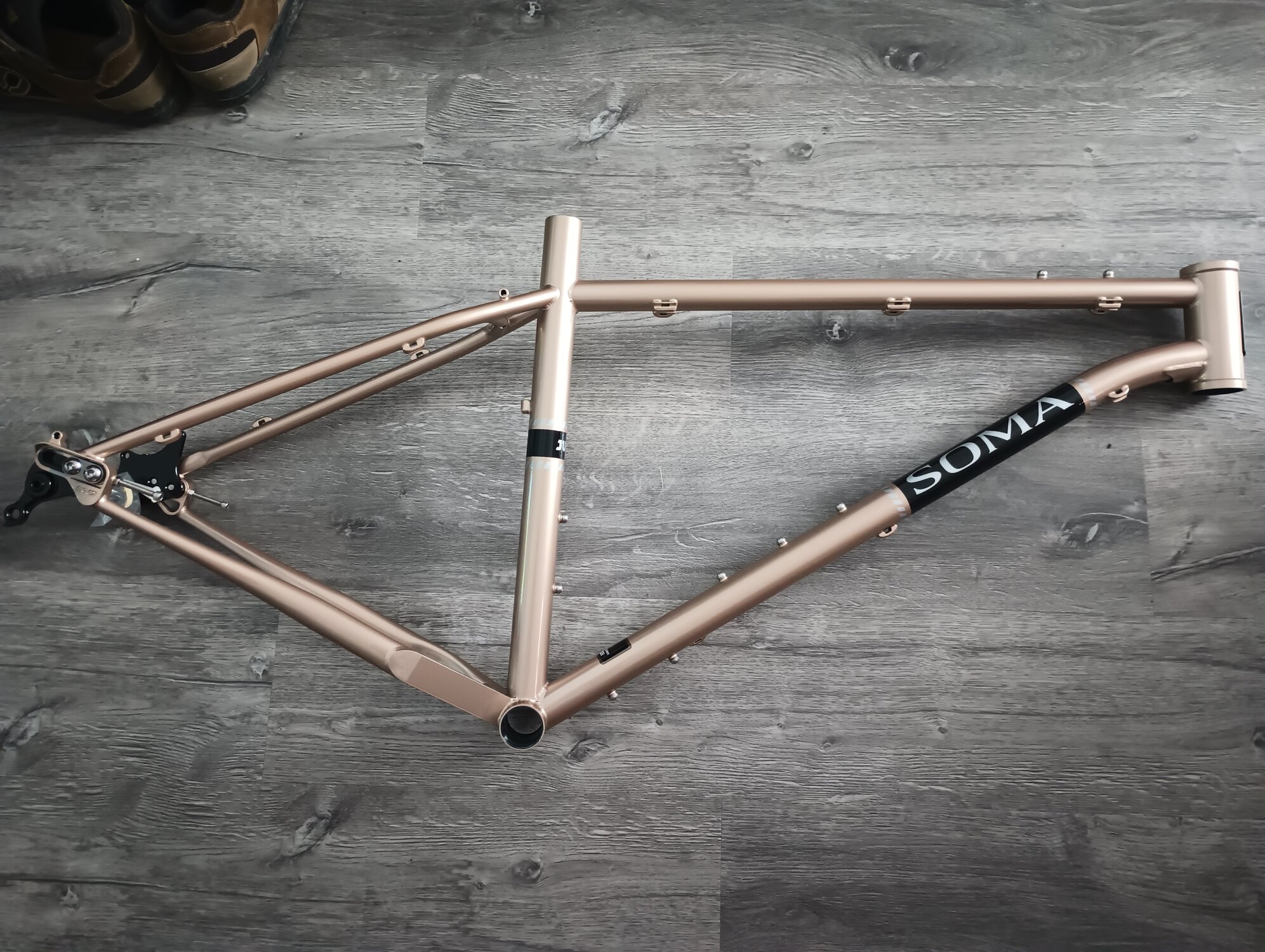

Enter the Soma Juice 2024 (Boost rear spacing new for 2024)
The Soma Juice appears to have the same style drive side chainstay as the Surly Ogre and Troll (flat bent piece as opposed to a tube) which allows for more chainring clearance. I emailed Soma and was quoted 39t for maximum front chainring clearance on a 1x MTN setup. Since this frame supports rear Boost Spacing a 1x MTN boost(+3mm) front chainring at 42t will most likely work fine. We will have to see how the BBSHD, CYC Photon and TosSeven DM01 workout on this frame.
Its also suspension corrected so I can either go rigid with something like a Salsa Rigid Grande 29 fork or a RockShox Reba SL 100mm travel fork. The 44mm headtube inside diameter means I can go with either a 1 1/8 straight headtube fork or a tapered fork depending on what what headset I pick. The headtube/trail specs are around 68.4 and 89mm respectively.
So the frame was just ordered($699)...more details to follow
Soma Juice 29r Initial Frame Impression

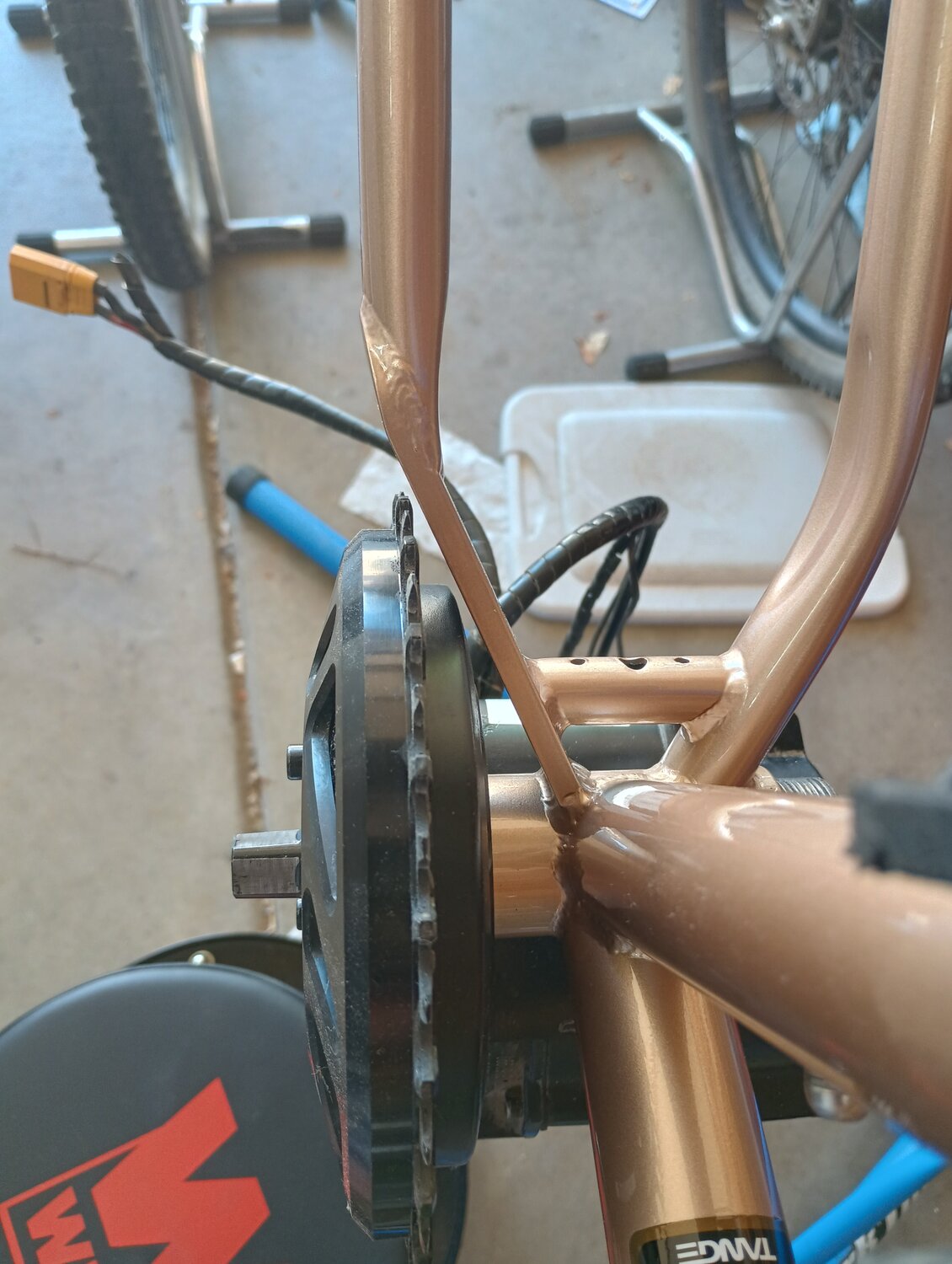

Just received the Soma Juice 29 frame and must say Im am totally impressed. The Desert Metallic paint matches the Surly Ogre Champagne Supernova which I totally love. As can be seen from the pics, it has tons of mounts just like the Surly bikes I have owned and they are all reinforced. I especially like the mounts on the underside of the Downtube(same as all the surlys) which allows the use of a BBSHD motor brace available thru california ebikes(see post #133 for picture)
Mounting a BBSHD only required 2mm of spacers on the drive side to get 2mm of space between the motor housing and 42t chainring. The Surly bridge club also required a 2mm spacer although I did get that down to 1.5mm by careful whacking of the driveside chainstay with a hammer (protected with a 2x4). The surly Ogres require a 1mm spacer.
The chainline with the BBSHD and 2mm of spacers is 54mm (boost 1x is 51-53mm) so close enough
While its nice to know that the BBSHD fits, I will install the CYC photon on this frame due to the better torque based assist which will be better on many of the offroad excursions I plan for this build.
Still waiting on all the other parts.
Totally glad I decided to try this frame, if the build goes well and I like the handling I will buy a second frameset and sell off my surly ogre frames.

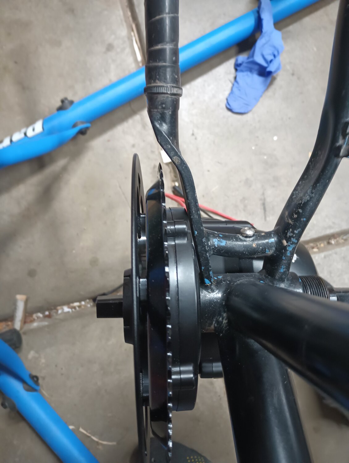

ToSeven DM01 Update
Wrote California ebike about getting the 46t offset chainring (to mount on inside of spider mentioned in post #344 above) and never got a response. Oh well, their loss, I cant force them to take my money. I just ordered this chainring from GoldenMotor.

Received the offset 46t chainring + spider today from golden motor...kudos for quick shipping!
DM01 Fitment on Surly Ogre and Soma Juice 29r
The DM01 fits both the Surly Ogre and Soma Juice 29r using a 1mm spacer
The chainline is around 57mm with a 1mm spacer to allow motor housing to clear frame on a Surly Ogre frame (see pic)
So it looks like I would loose the lowest gear, not sure how that will workout because I am also using a bigger chainring now......I will have to ponder this.
Since I have exclusively gone to linkglide/cues I might be able to get away with using the whole cassette range with this chainline. The 9-11 speed cassettes use the same cog spacing supposedly with the additional cogs being added on the larger cog side. Since I will be using a 9 speed linkglide/cues cassette, this might work to my advantage.
I will try this out tomorrow and provide an update.

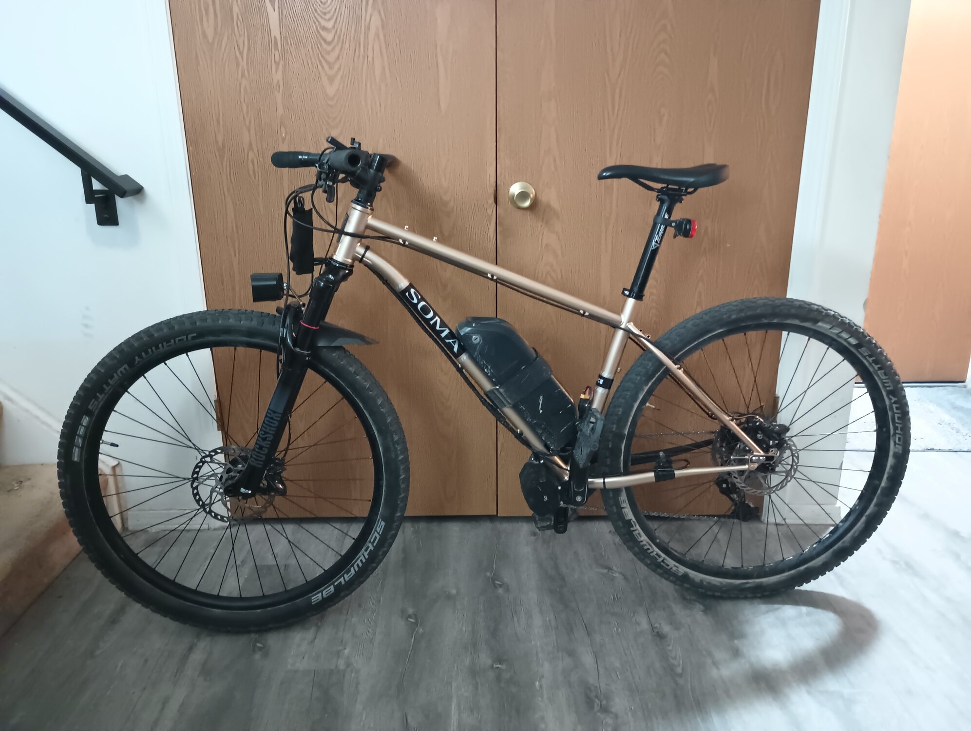

Soma Juice 29r Update
Finally got the Soma Juice 29 build built about 5 minutes ago and did a quick 5 minute ride. Many parts came off the Surly Ogre its going to replace. I did put on a RockShox Gold 35 ebike certified fork ($269, on sale from $459). It also got a new 9 speed 11-46t cassette Shimano linkglide cues setup. The Surly Ogre uses a QR front end so I built up a new wheel using a DT swiss 350 hybrid front boost hub (beefier for ebikes) on a velocityusa Blunt 35 rim, rear setup was the same DT swiss 350 hybrid hub and rim from the Ogre. Installed the 2k miles CYC photon from the Ogre. Had to put a 5mm spacer on the drive side for the 42t chainring to fit (BBSHD requires a 1mm spacer). Chainline is within a mm or so of perfect.
I decided to try a magura MT5 setup (quad pistons F/R and 203F/180R) and it gave me quite a bit of trouble. The rear installed without a hitch but the front calibers just would not retract enough no matter what I tried so I just used my existing Deore 4 piston 180mm Front 2 piston 160 Rear from my Ogre for now. This is a bummer as I really like the feel of the magura brakes and the MT5 kits are on sale for $270 including rotors.
Overall very impressed with this Soma Juice 29r frame, most likely will replace my other surly ogre this winter but will use a rigid fork and suspension stem (Kinekt).

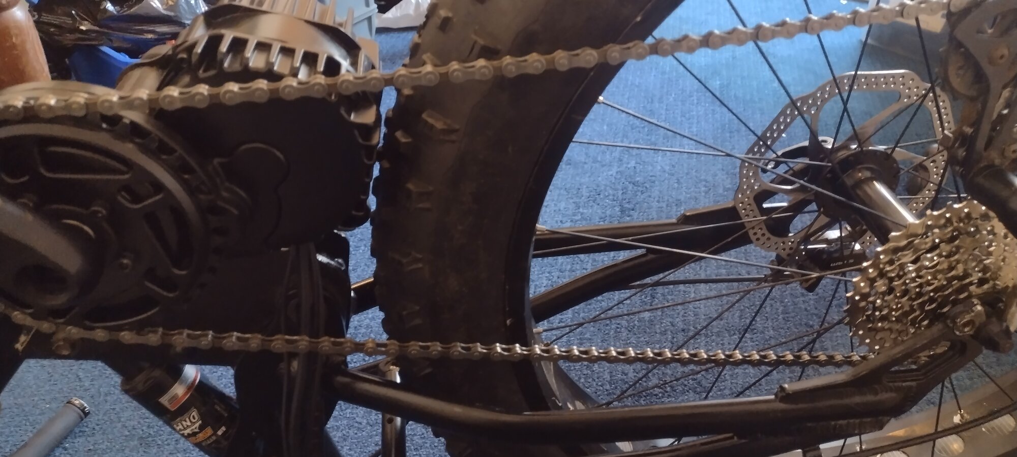

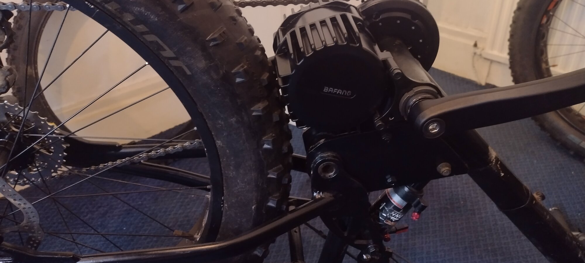

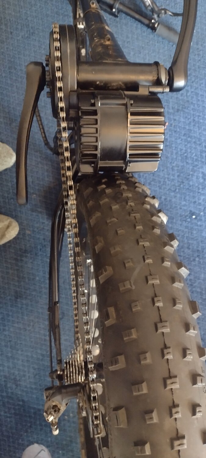

Nice, the endless bbshd chainnangle issue, as you can see mines pretty bad, but not drastic.
I ordered the 120mm version, but have since realised because of my single pivot I could run a 100mm, maybe even smaller, so Ive ordered a 100mm shaft., not sure if it will fit the 120mm motor, but botch is my middle name,
I would also have to cut down the BB and the bbshd itself. :)
Yes Ive fitted it upside down because Ive got the space.
