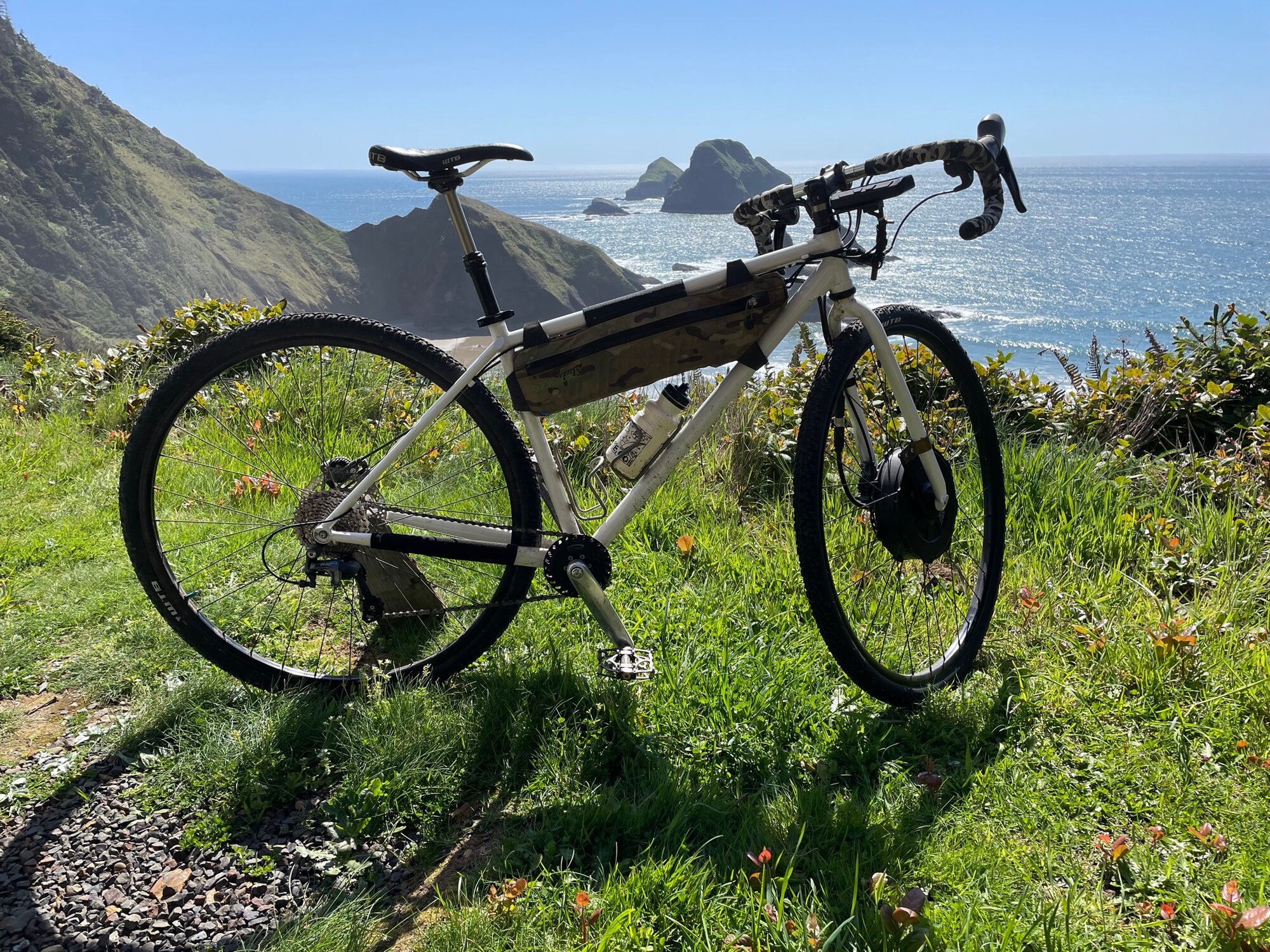

A friend was in on the development and sent me a frame/fork, rims/tires and component group back in the fall of 2019. I have had several whacks at using the wheels specifically since then and was unable to really say much about them. But now that the cat is out of the bag here is where the bike is at today with a Grin All Axle DD hub, CA3 display, Schlumpf High Speed Drive and 52v 17.5Ah 21700 cell shrink wrap battery/baserunner controller set to 25A in the top tube bag for the clean look I was going for. A Shimano drive train and hydraulic brakes as well as a dropper post that is activated by the left brifter lever rounds out the build. The bike operates without PAS and instead a throttle with cruise control as the use of the Schlumpf doesn't allow for PAS. I have had drop bar bikes now set up like this and actually prefer it for primarily road use although I like torque assist PAS on my MTB in addition to having a throttle on board for the moments I feel the need for one.

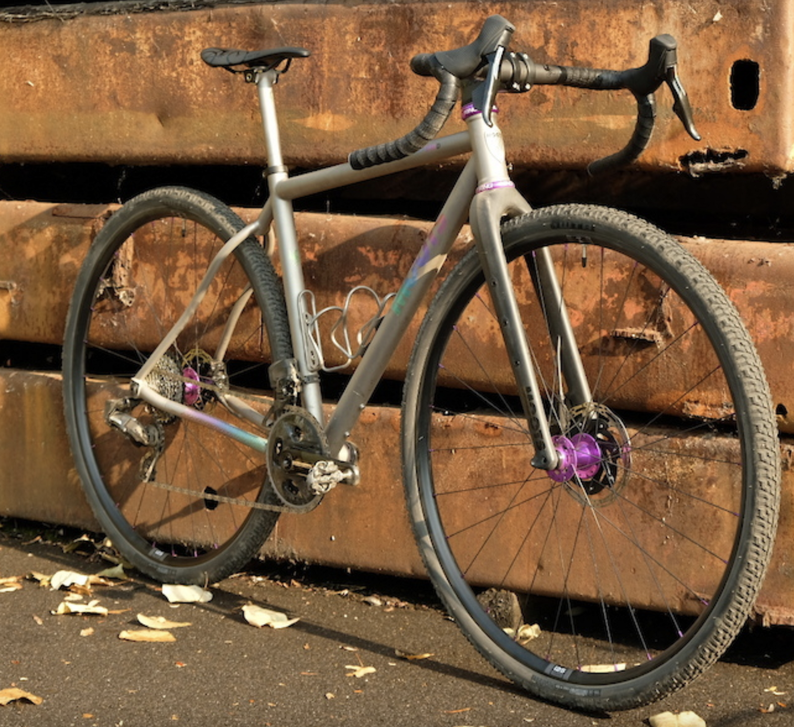

Here is the Moots version:

Here is an explanation of what drew Moots to try this I took from PinkBike:
I got to see this bike in the flesh yesterday at MADE and I spent some time talking to Moots about why they're experimenting with this. Here's the gist of their "why":
- It's still an experiment and may evolve into something different.
- The reason they aren't just using a larger MTB/Gravel tire pertains to aerodynamics, ride quality, and contact area: Moots says that a 40c 750D tire effectively has the contact area of a larger 48-52mm 650B tire, but in a longer and narrower contact patch. They say this is more aerodynamic for the same level of float, and the ride quality at higher speeds is better/more controllable than 650B in their experiments so far.
- Part of their initial prompt to explore wheel sizing was with difficulties optimizing the range of 1x drivetrains for gravel riding around a desired speed range and tire size, and the larger wheel size helps them optimize a gear range for the desired speed range with a desired tire size, while also claiming the benefits above.
- They see this tire optimized for a certain speed range. They said that generally for gravel, they see 650B as a 14-18 mph tire, 700C as a 15-25 mph tire, and 750D as a 17-30 mph tire.
- Because of the speed range, It's ultimately optimized for racing or higher speed riding.
For my purposes the last two bullet points have the most significance. As you might guess a 1000w front hub with the range of high gearing that the Schlumpf provides on the human side the bike above can be ridden pretty fast on level ground? Although I don't all the time and certainly only on open roads, when I do the bike is extremely stable, more so than my other ones that had 700c wheels. There is some compliance also afforded to the longer spoke lenghth also as you suggest and I have been getting away with low 30 psi that helps keep road chatter down.
Overall I don't see this wheel size blowing up the industry but it has been fun to build it up and mess around with and am sure that others will also if made available. My preferred mode of transport here is my FS eMTB because it adapts itself better to the surface variations that range from pavement to roots an rocks to sandy beaches that I encounter on any given ride. The term "gravel bike" seems to be more about a new marketing moniker and racing genre. Where I live the variety of gravel, from chunk to champagne, happens in spurts that can cause too much flat anxiety. The attraction is that it is primarily available behind locked gates with no traffic that makes it safer than highways I find.
