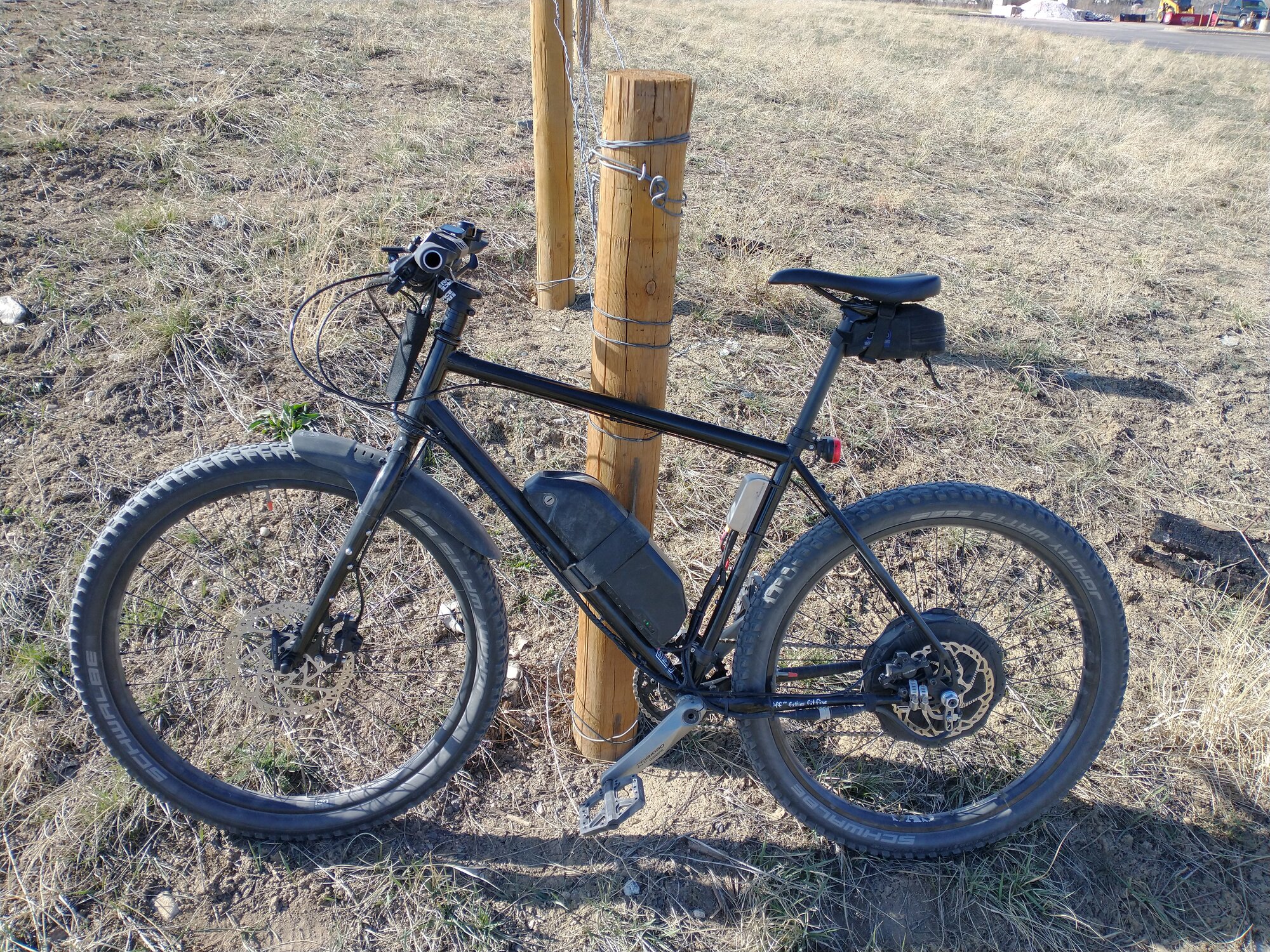

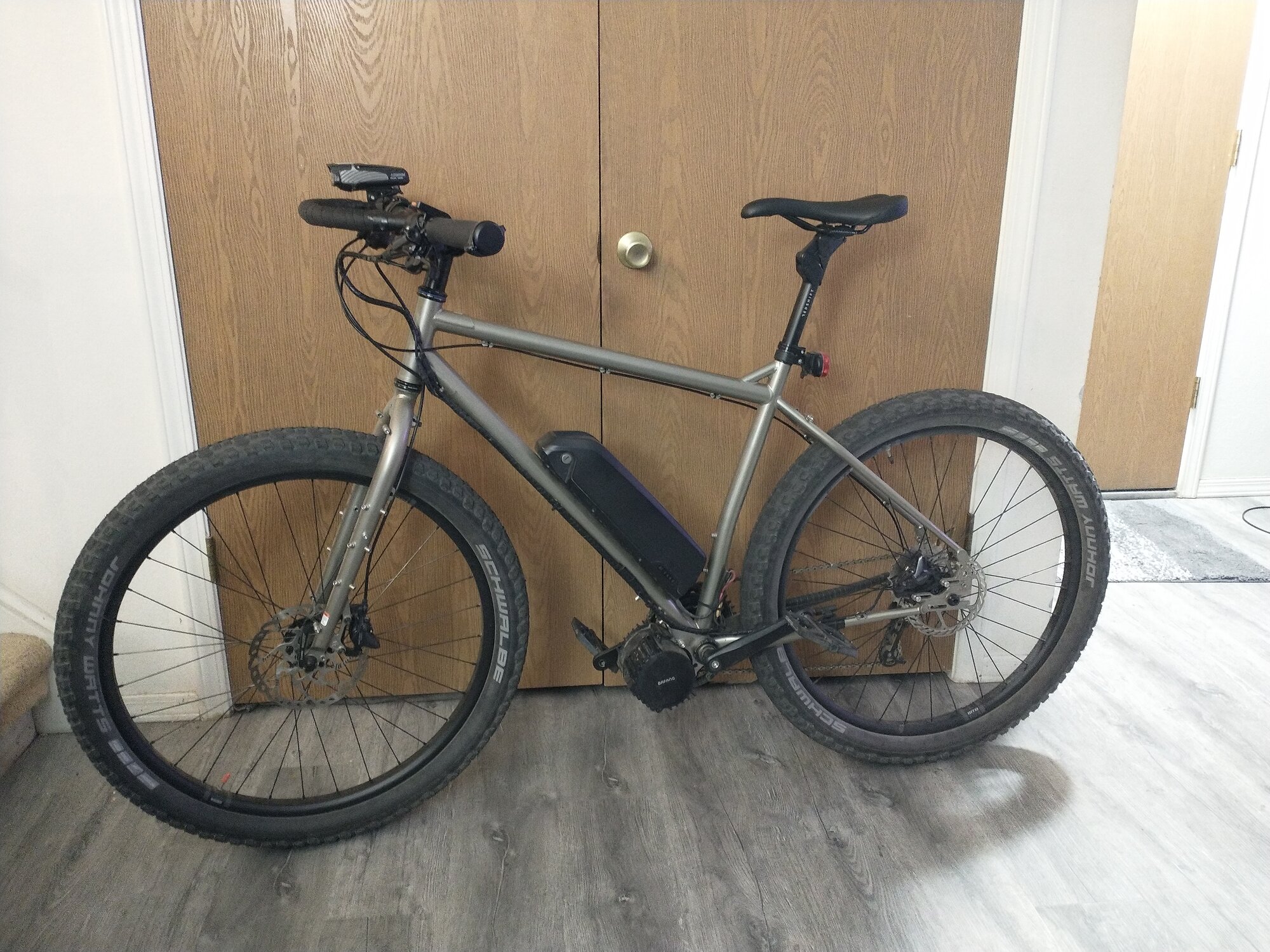

Surly BC/BBSHD with 27.5x2.8 Johnny Watts
Cush city. Super traction although not as good as 27.5x2.8 nobby nics. I am able to do several trails I would consider full suspension only. Not the best for these trails but allows me to extend rides into these areas (everything is a compromise). I will definately keep this wheelset ready for some rides. Fun to ride although I need to crank up the assist level a notch.

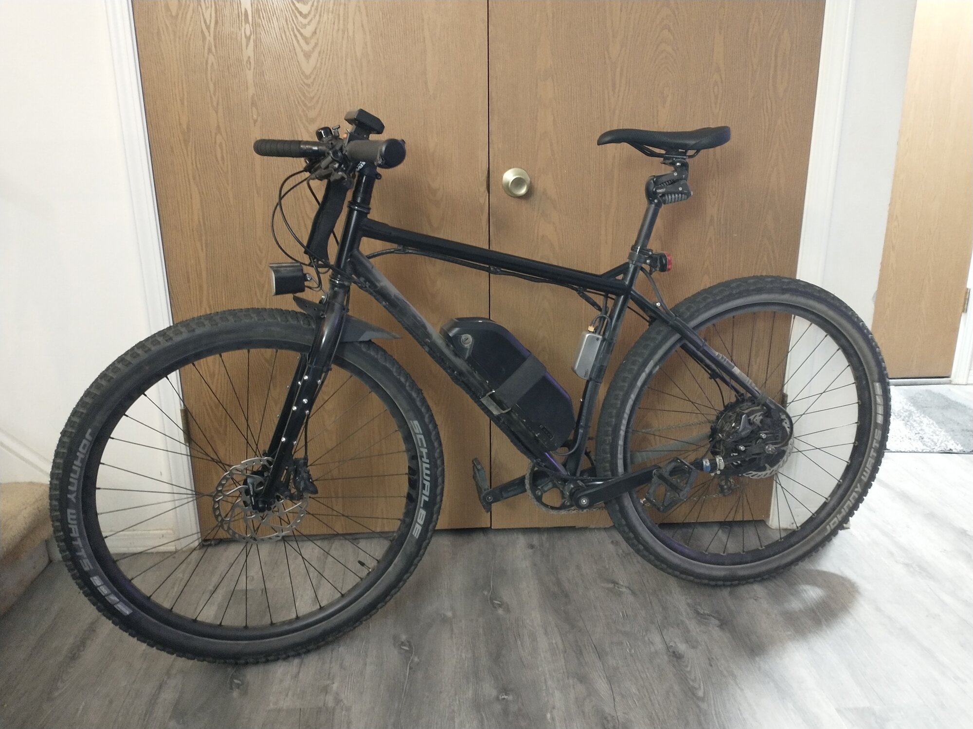

The GMAC is now on on a Surly Ogre frame (the blue one showed previously). I decided to paint it satin black using paint from spray.bike. This was a huge nightmare and took awhile. All the mounting holes made sanding and painting a chore. Many people like spray.bike paint but it just didnt click for me and is very $$. Due to all the mounting holes/angles etc.., it was hard to get a consistent flat black texture/surface finish. Same with the clear coat. In the end I just sprayed on a ton of clearcoat and finished it up to a satin fininsh with 1000grit sandpaper and rubbing compound. Next time I will just use an automotive spray paint in gloss and get the same satin finish with sandpaper and rubbing compound for less $$ and time waiting for shipping (had to order twice as I used twice what was expected).
This setup with Johnny watts 29x2.35F/2.35R is definately more efficient by a few wh/mile for the same average speed although I tend to just ride faster now by a few mph average. I do miss the wider 27.5x2.6 tires from before but can still mount these old wheels/tires/motor or even mount a set of 27.5x2.8 tires.

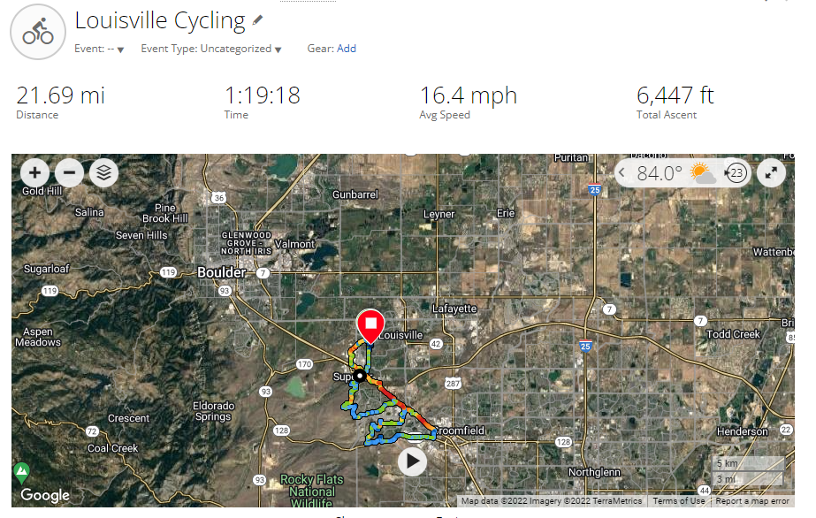

Interesting ride today on the Surly Ogre (29) with BBSHD. Used 460wh but ALOT of climbing
Whats even more amazing is that I rode this with a neighbor using a GMAC on my old Juiced CCX and it had zero issues like overheating and we went up some pretty steep technical stuff (>15%). Most definately not the realm of the GMAC which was beyond its limits but it survived.
Edited: Total vertical reported appears to be an anomaly, its more like 3k ft.

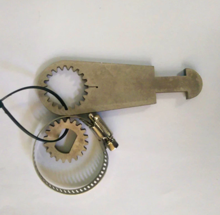

I also ordered statorade (10ml) and their V4 torquearm
Anyone considering this motor should also buy some spacing washers available thru grin at the same time. There is a washer that needs to fit over the axle
but inside the cassette and the supplied one with my motor was not thick enough to keep the cassette from rubbing against the frame when
the motor was mounted.
So the cost of a few washers + shipping was $30, uggghhhh, Wont arrive till next week.
As it turns out, you can use the washer available here, although the torque arm is a POS imho

RH212 update
This motor is just a monster, total overkill for my needs at 52V(with statorade). I have done stupid things like just gone full throttle in high winds(20mph+) for about 5 miles doing 4-6% rolling hills reaching speeds up to 32mph. Its very rare to see temps over 50C. I have had it up to about 74C once but that was total abuse of the battery which is now the weakest link.
72V would be AWESOME with this motor although I have no need for that level of performance/weight.
Despite the performance, its not the most fun bike to ride. Perhaps its the cadence sensing assist, maybe just the weight or lack of low speed torque. I plan on putting a torque sensing BB on soon to see if that changes anything.
Grin has come out with some new torque arm designs which is a big complaint I have with my RH212(with V4 torquearm) in that I need to carry quite alot of tools to be able to change a tire.
I just ordered the V5 torque arm

An interesting design in V5. That star centerpiece was used at least 10 years ago. I have a couple left. But Grin managed to incorporate it and improve!
These were problem solvers! ALiexpress model sucks, mine are all NOS.
Thanks for sharing the history 👍
