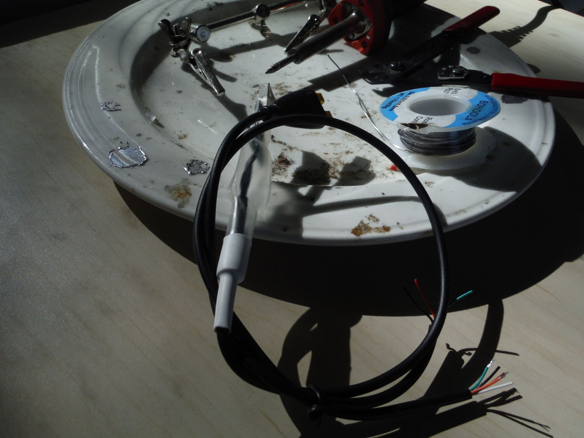

I have my BBS02B tweaked near perfect but torque sensing has my interest. The Open Firmware on the TDZ is supported by sellers and pre-installed so no worries about Russia/China downloads... and making up a cable is just another reason to practice soldering.

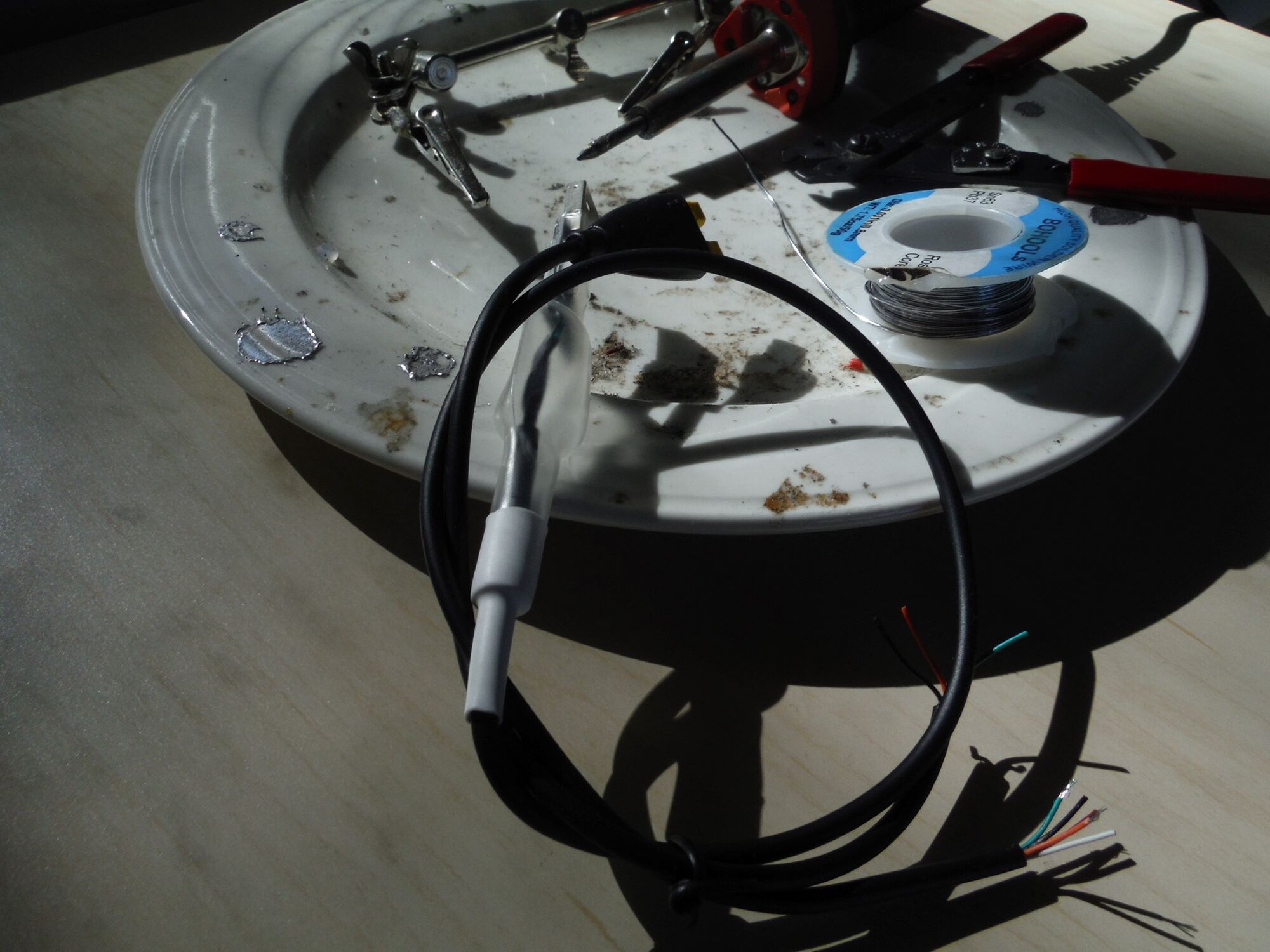

Here is the USB programing dongle hooked to a TS controller thru the speed sensor. @tomjasz has a few spare speed sensors you can chop to assemble a USB programing kit like this. He also has about 30-pounds of other relevant stuff. PM him.
