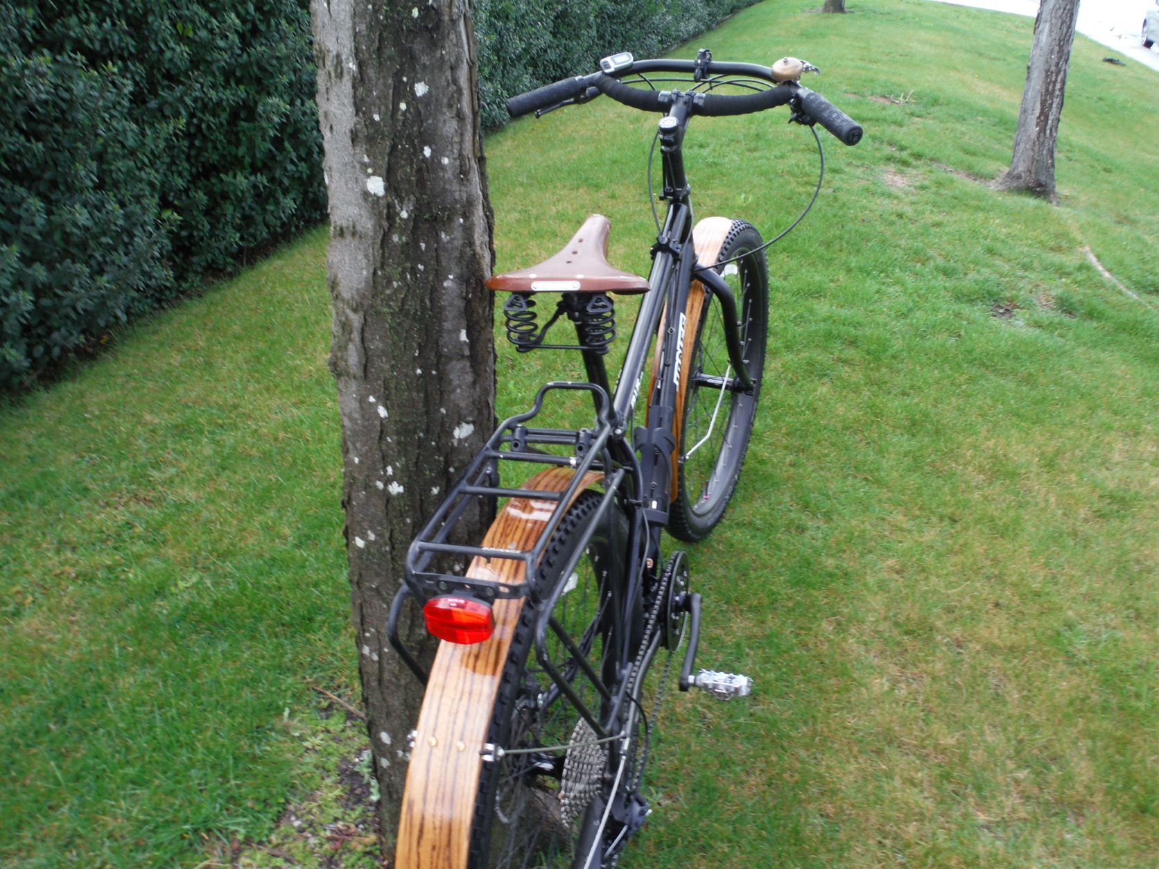

I have a bike in the shop. The owner described the symptoms of it randomly shutting down. I offered to install a new motor and work on full diagnostics latter. What it was is the display timing out after five minutes at power level Zero. He would put it at zero and coast down large hills or when he had a big tail wind. If you are not using any power it thinks no power is wanted.
I think the BBSHD gets around this by sensing wheel revs via the speed sensor. If the wheel is revolving the motor won't shut down. I've never tried setting PAS to zero... I mean... its an ebike. Turning the power clean off never occurred to me :D
His bike does not have a speed sensor. He rode it 67 miles in the hills and wind and returned with two bars. He is of the rare breed of experienced ridder who likes to nurse a battery. It turns out I do need to replace the motor. In walk assist it shutters and makes a sound like a buzz saw. The controller and torque sensor are both intermittent. Water incursion? Or defective from the factory. My motors are all QC checked. It is under warranty. But that does not cover abuse like fording a river with it.
The buzzing sounds like a sawed-down internal nylon main gear grinding against the secondary when stress gets high? Just a guess.
I agree. But the guy is super gentle and I have never had a blue gear fail. If walk assist works then the controller is good, but that is intermittent. The torque sensor is intermittent also. 3 out of 5 restarts the display works but nothing else. He has only had the bike 25-days. It is the woody Jones with a heavy duty 100Nm, 750W cargo motor with extra bearings. I wonder if there is rust all over the torque sensor and corrosion of internal connectors and bearings with damp white crystals growing in the housing.
