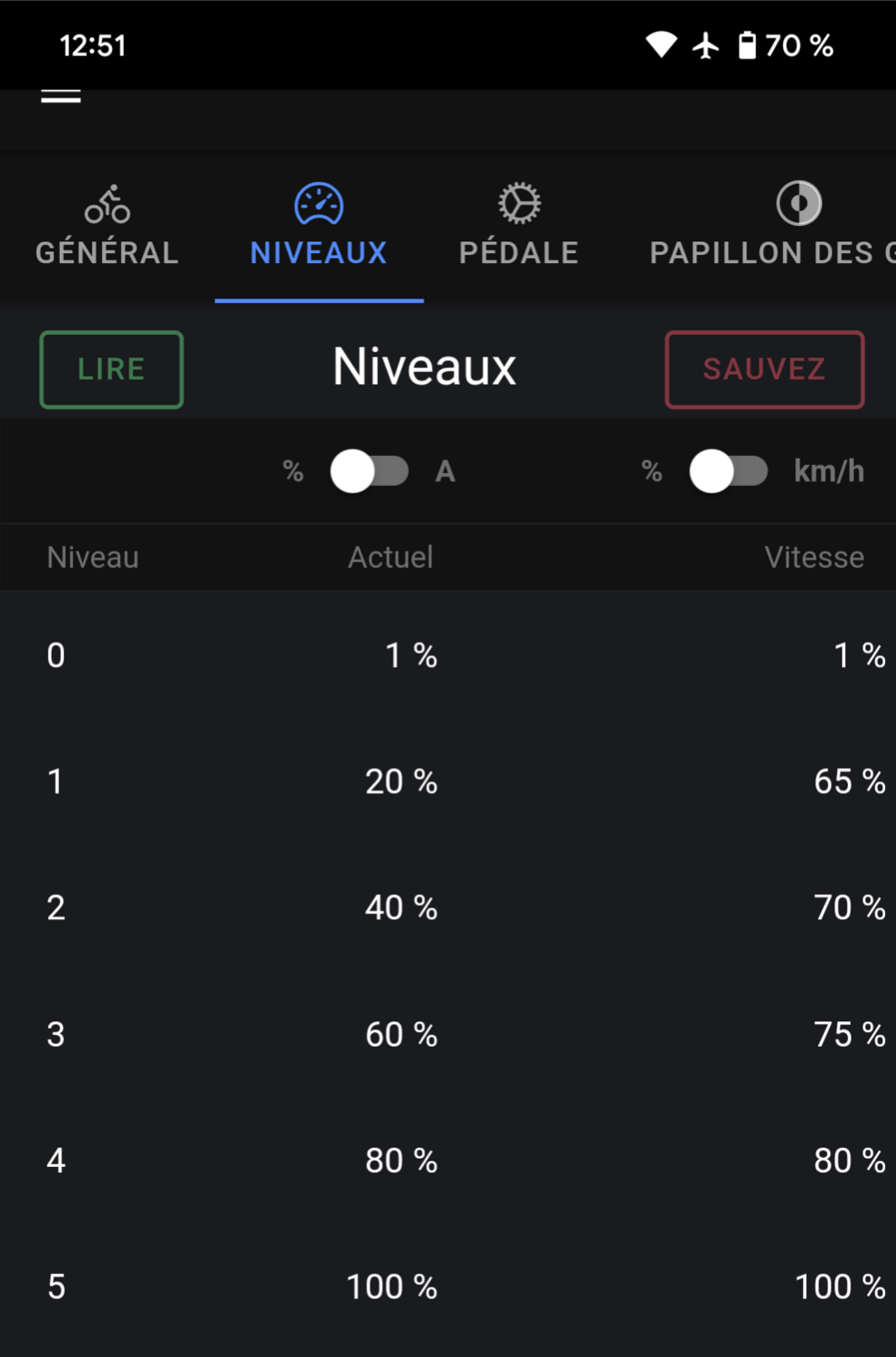

To have this feeling, it is enough simply not to put 100% on the speed of rotation in this kind for 5 levels
