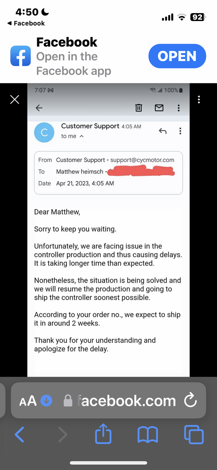

Lastly, I emailed [email protected] a few times over the past weekend, but no replies. Are they typically poor regarding support?

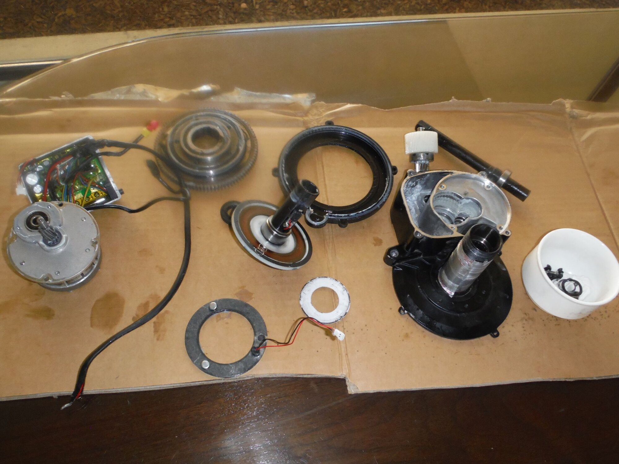

Left to right: Motor, controller, main gear assembly, torque sensor part A, torque sensor shaft assembly, nylon gear, motor housing, axle shaft, small parts. Oh, the little white doughnut ring is Teflon, the torque sensor rides on it.
