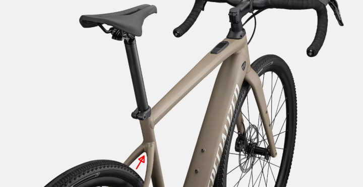

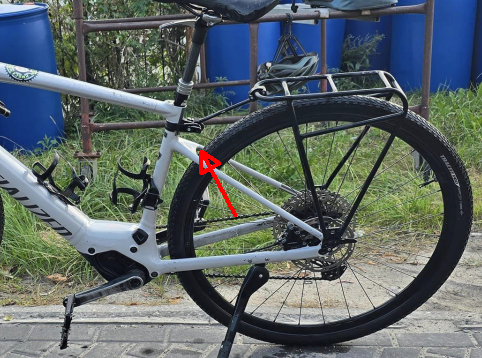

To put it straight @SupremeTorch: You cannot cannibalize almost anything from the Vado SL to upgrade the Creo 2. These two e-bikes are totally different. The Vado SL rack and the rear fender are totally integrated with each other and good for 38 mm tyres maximum (Creo 2 has big 47 mm tyres). I'm even not sure whether the bosses and mounting points on Creo 2 would fit the Vado SL equipment! You cannot use the Vado SL handlebar remote, as it is the wrong size for the Creo 2 handlebar/type, and so on.
The rack? Buy Ortlieb Quick Rack, it is a marvel, compatible with almost any bike, and can be installed and removed in a minute. It is worse with the fenders. Please look at SKS website and look for detachable fenders that can fit 47 mm tyres.

Creo 2 frame (although made with multiple bosses for equipment) was never made to take up the Vado SL equipment. For instance, the integrated rear fender/rear rack combo requires a threaded socket at the junction of the seat-stays, not present on the Creo 2. The devil is in the details, and I assure you the name of Specialized is not coincidental. (Specialized loves integrating things and making proprietary designs and parts).
It makes no sense to maim a good Vado SL to recover several useless and incompatible parts. Just sell the Vado SL in the good shape. Or, keep it as it is.

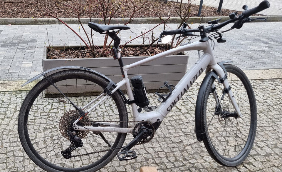

Indeed, Creo 2 E5 comes with 700 x 38 mm Pathfinder Pro. Just buy SKS Speedrocker fenders (they fit a 700 wheel up to 42 mm). Speedrockers can be detached or attached in minutes. These perfectly coexist with the Ortlieb Quick Rack. One day, you could have an unequipped sporty e-bike, and an equipped one on another.
Moreover, the Vado SL rear rack is flimsy, and only good for 33 lb load (distributed evenly on both sides). Ortlieb Quick Rack takes 44 lbs (distributed evenly).
SKS Speedrockers. (Unfortunately, I have no photo of Speedrockers working in unison with Quick Rack).

As it rains in Poland (not this Summer!), I invested in SKS Speedrockers that any of my buddies praised, and you can remove these fenders at any time. Went with Specialized Tracer Pro 42 mm tyres tubeless. Then I bought the Quick Rack, and recently invested in a simple dropper post I need off-road at times.

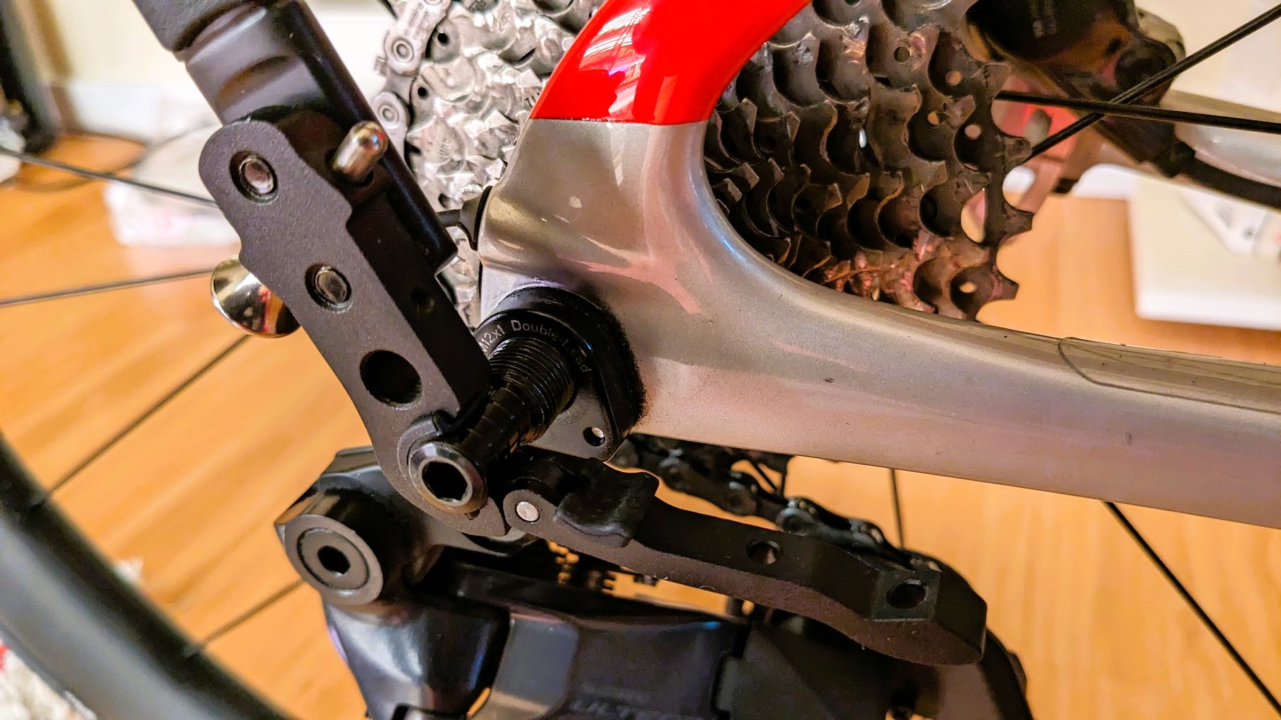

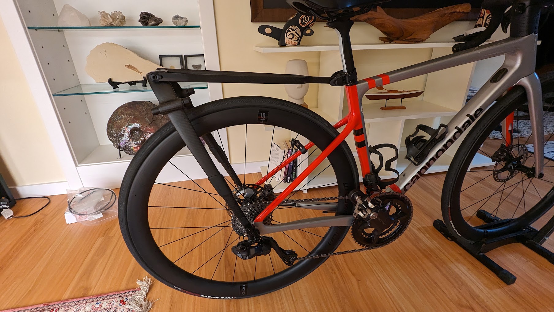

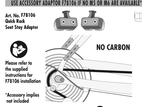

I’m not sure why either but I suspect that might be Ortlieb just playing it safe. Likely preferable to saying so rather than hide behind a ‘Use at your own responsibility’ clause. My Cannondale road bike naturally has no rack eyelets so the Tailfin will complement it well for an upcoming overseas trip. The rack also fits my other carbon bikes using the universal axle/UDH adapter kits and is also dropper friendly.
OTH I wonder why Ortlieb wouldn't be compatible with carbon frames 🤔
If you don't have the rack mounting screw near the derailleur (which may be less common on carbon frames? my grizl does not have it) you have to use an adapter that clamps onto the chainstay (or is it the seatstay?) somewhere. It might not work for various reasons (CF chunkier profile, CF can't take the point force clamping load, etc).

There appears to be a bit of confusion between Ortlieb’s product info and the instructions with regards to carbon bikes. On one hand, it clearly states in the instructions that the seat stay adapters are a no go but in the product data spec sheet it gives the thumbs up to carbon bikes with eyelets and carbon seat posts. Go figure.
The carbon stays on my Cannondale are not very beefy so my preference is with Tailfin’s thru axle where the load bearing weight is focused.
