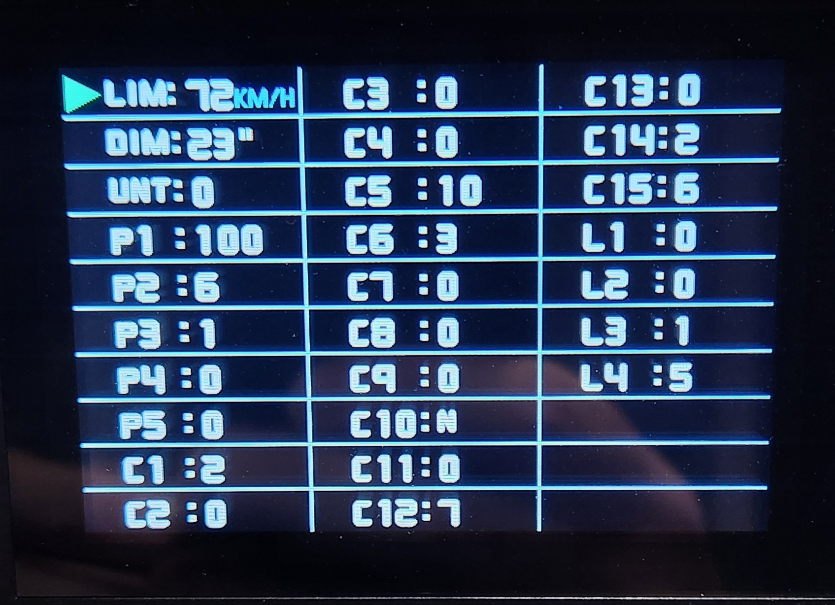

I have a KT 45A controller (sine wave) and LCD8H display. When I pedal or use the throttle, the speedometer works properly and shows the correct speed. As soon as I stop pedaling or using the the throttle, the speedometer drops to about 4 to 6 km/hr. (it doesn't matter what my actual speed it, the speedometer shows a low value). If I pedal while slowly applying the brakes, the speedometer also drops to 4 to 6 km/hr. I have a Bafang G062 hub motor. While pedaling or using throttle from a couple km/hr to 45 km/hr, the speedometer works as it should and matches the GPS on my phone.
Any suggestions to make the speedometer work while coasting?
Here are the settings I have:
Bafang G062
6 pole magnets
Reduction ratio of 1:5
Magnet poles 20
Max speed – 72km/hr
Wheel Diameter – 23 (I have a 20" x 4" fat tire, and actual diameter is about 23")
Metric – 0
P1 - 100
P2 - 6
P3 - 1
P4 - 0
P5 - 0 for instantaneous voltage, or about 22 for smart voltage (I have two 52 volt batteries, 15 ah each)
C1 - 2
C2 - 0 for sine wave controller (Is this correct?)
C3 - 0
C4 - 0
C5 – 10 for maximum current
C6 – 1 to 5 brightness
C7 – 0 (1 if you want cruise control to work)
C8 – 0
C9 – 0 (password off)
C10 – n (restore settings)
C11 – 0
C12 – 7 (Voltage for battery cutoff)
C13 – 0
C14 – 2 or 3 (power assist tuning for PAS, 1 for lowest assist, 2 for general assist, 3 for stronger assist)
C15 – walk assist, 4 for 4km/hr, 5 for 5km/hr and 6 for 6km/hr
L1 – 0
L2 – 0
L3 – 1
L4 – 5 (screen time out, enter number above 5 for screen time out minutes)

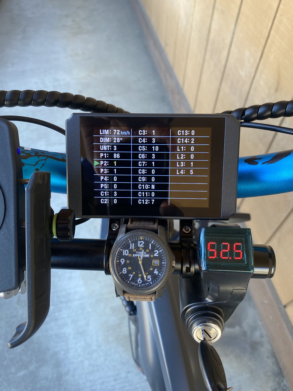

Can you post a picture of your settings? It sounds like your settings might get his speedo working?

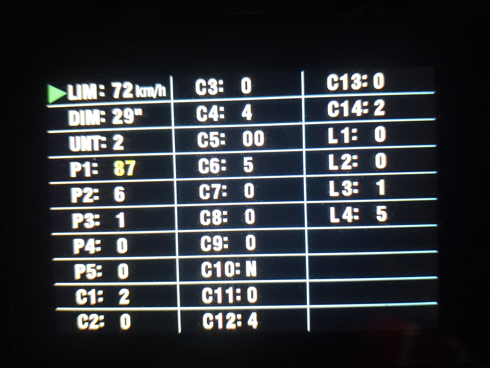

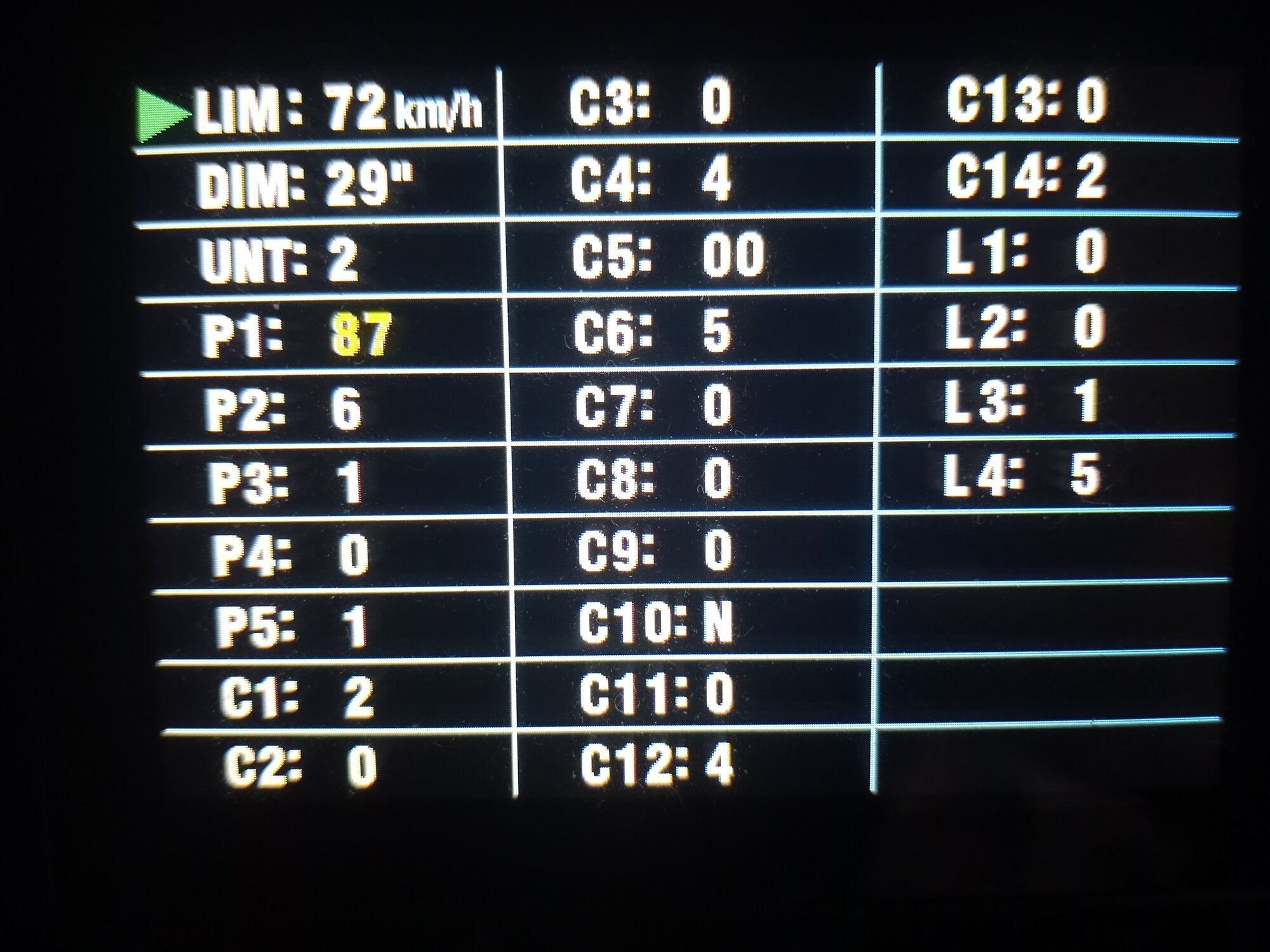

These are my current settings on my 26" fat bike with a Das-Kit motor,..
Interestingly, my P1 setting is always yellow.
All the other settings are white until I adjust one or more,..
Then when I save the settings and restart the display, all the settings are white except P1.
I don't know what's going on, but I've never hooked up my PAS sensor, and that might have something to do with it?
P1=87 was what got my speedometer dialed in perfectly and I've never had my speedometer reading anything erroneous.
As far as the controller thinks, I never pedal (which is 98% true. 😂)

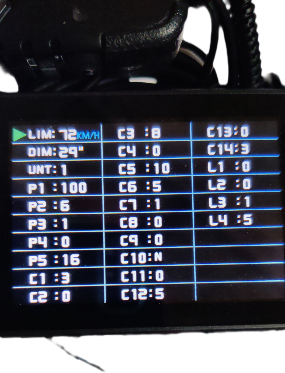

Here were my settings, but this was for a Shengyi DWG22.

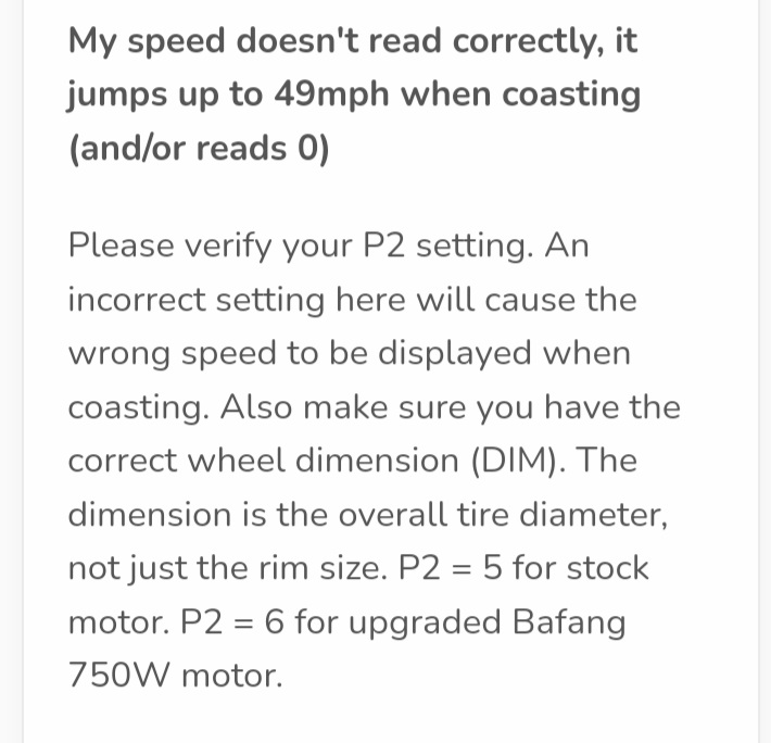

Here's a quote,..
My Das-Kit motor is apparently a rebranded MXUS 750 Watt motor, so me chosing P2=6 was probably the right choice for me?

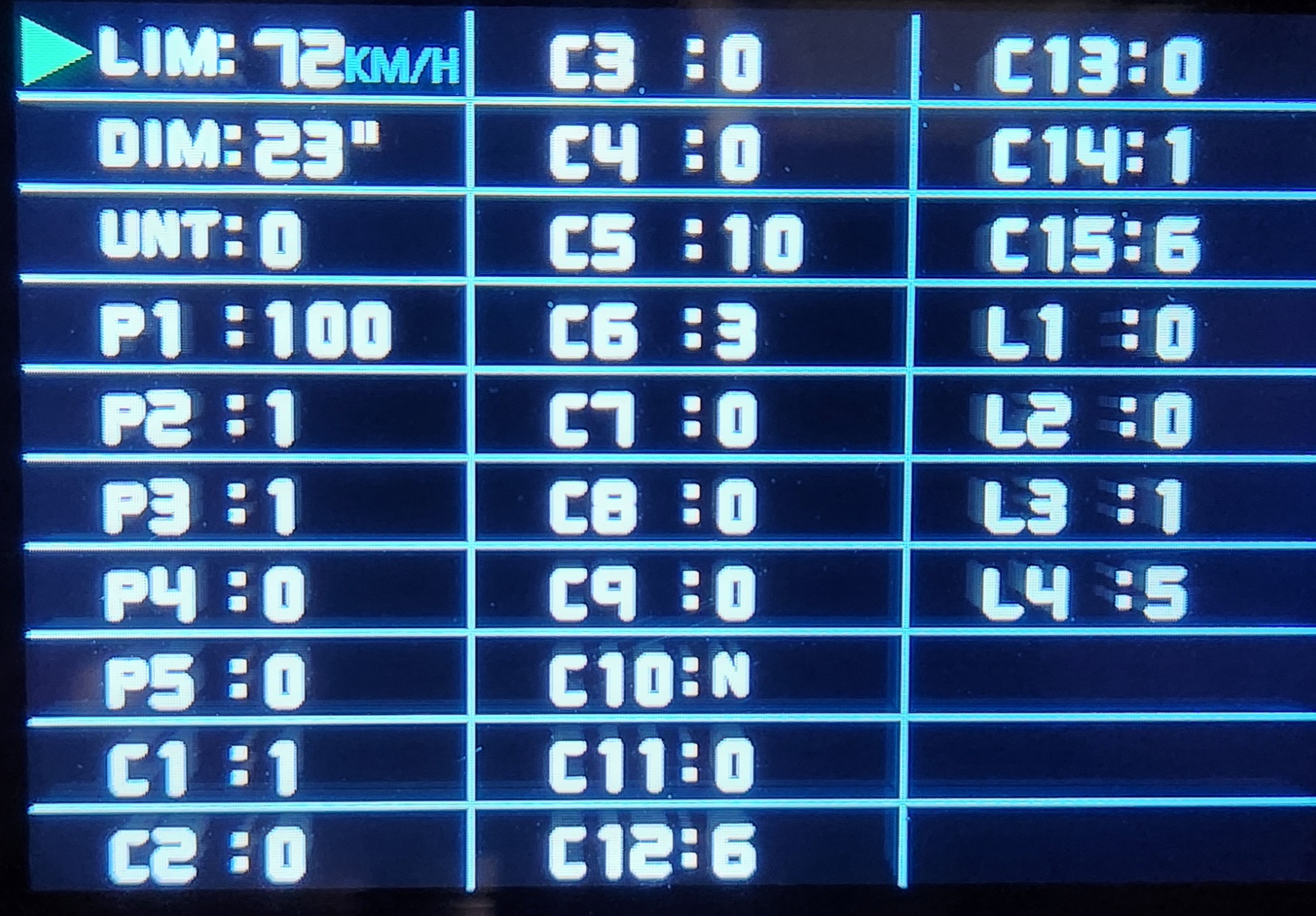

Here are my current settings. You can see from the Bafang spec sheet, P1 should be 100 and P2 should be 6.
I tried changing P3. On setting 1 or 0, same speedometer results
Changed C2 to 1. Nothing works. No power at all to motor. Changed back to 0.

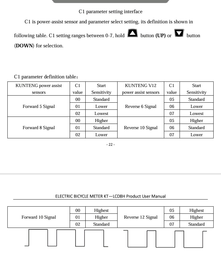

C1 - settings 1 and 2 work the best for pedal assist to work. 3 and 4 will work, but only kick in after you manage to get up to about 10km/hr. Settings 5, 6 and 7 do nothing
I unplugged the PAS sensor. The speedometer works on throttle, but drops again to 4 to 6 km/hr while coasting. If I only pedaled the speedometer read about 2km/hr. I could only pedal so fast and speed didn't show the correct speed.
I'm stumped. Am I missing something or would the controller or display be faulty?

I reset the display. C10. Selected Y and shut it off. Turned the display on and put in my settings I had, and I had the same issue. Pulled out my log book of each entry change I've done already and I started over.
Left P1 at 100. Started P2 with 6, then 5 and walked my way down to 1. Now with 1 in the setting for P2, it is allowing the speedometer to work all the time. The speedometer is a bit slower to react when taking off, but it works when coasting. Why it worked this time is beyond me. It didn't work before. All I did was reset the display and started trying all the settings again. I'm glad its working. My neighbors must have thought I was nuts going up and down the street stopping and going for hours. Thanks for all your help. Here are my current settings for the Bafang G062 with KT 45A controller. I will still need to do some research on P5 and C12 for voltages with 52V batteries. The only manual I can find lists 48V as the highest voltage. The display does say up to 60v on the back of the unit.
