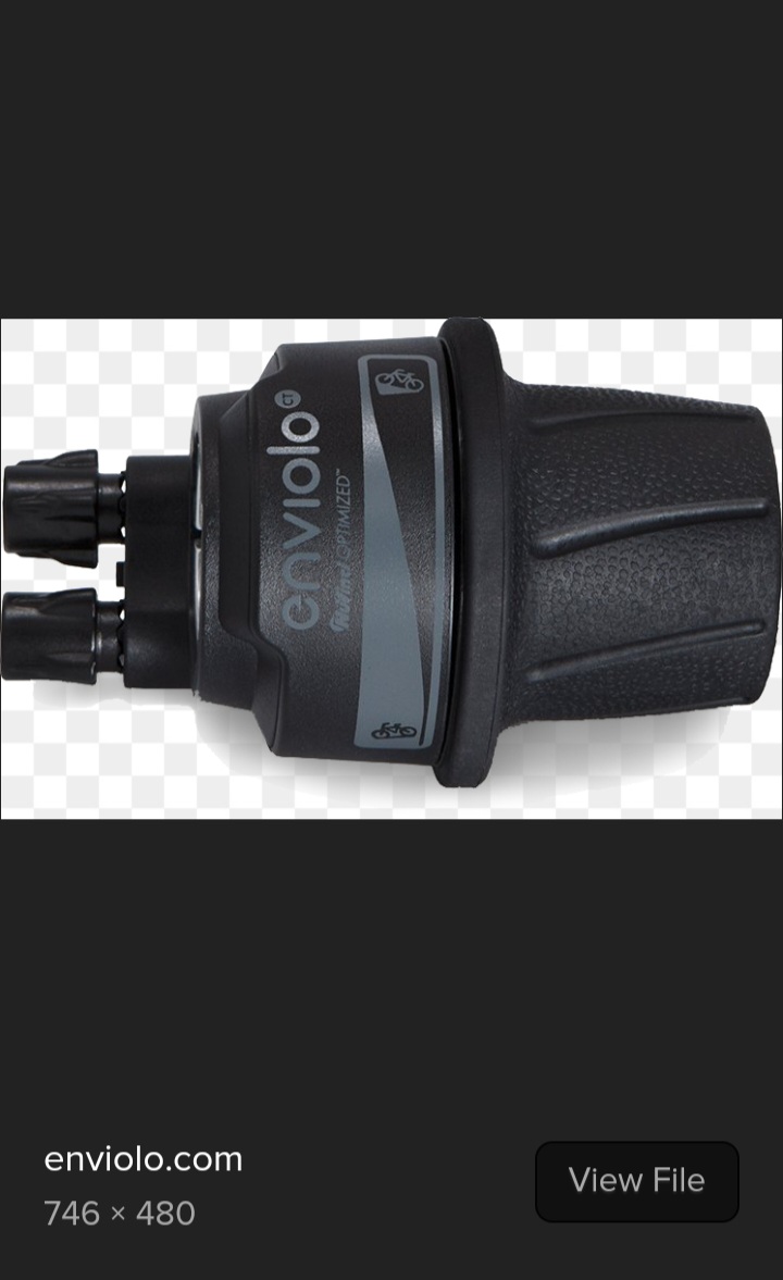

So Enviolo is a pretty established brand among ebike components these days. There are a lot of them out there and I can't be the only one wondering this.
The twist shifter (with the little guy on his bike climbing an adjustable hill), as installed, seems counterintuitive to me. Is it possible to reverse its orientation by simply reversing the two cables (or their wind direction) at the twist grip handle? Has anyone successfully done this? If so, any pictures or descriptive instructions would be appreciated.

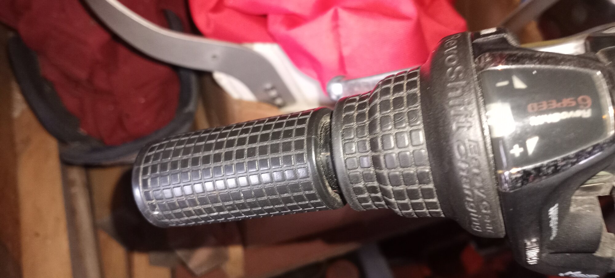

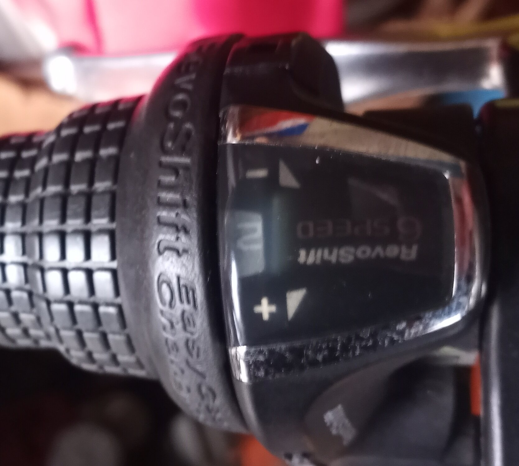

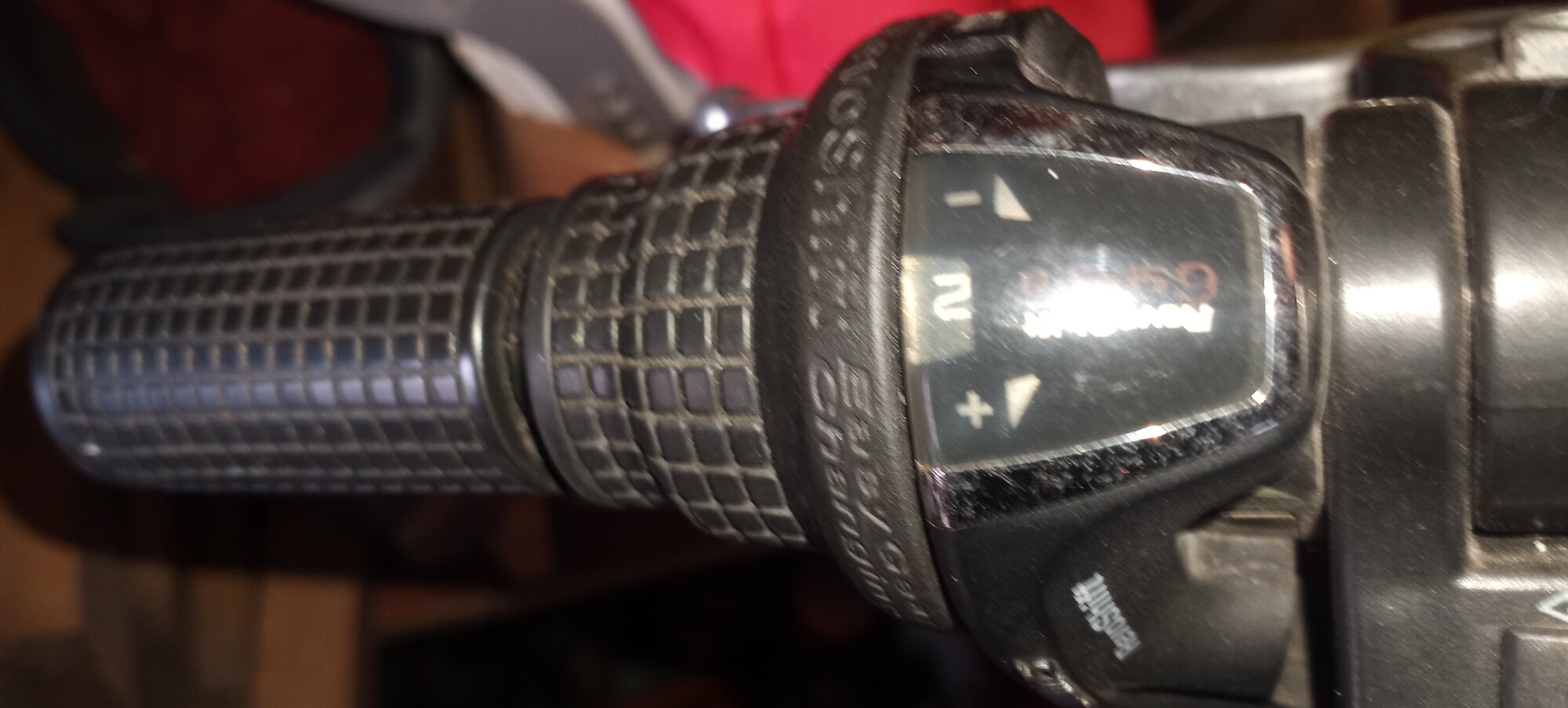

That's what they did on my old e-bike. It was built for the European market and they added a throttle on the right for the North American market so flipped the grip shifter upside down and installed it on the left.

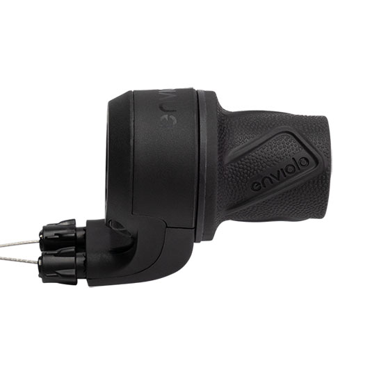

I found a couple of enviolo manual shifters at modernbike. They seem to have 2 cables. Putting it on the left bar would also work, I think.

If you reverse, just make sure the cables are perfectly straight - otherwise it could be finicky.

You could install your grip shifter on the other side.

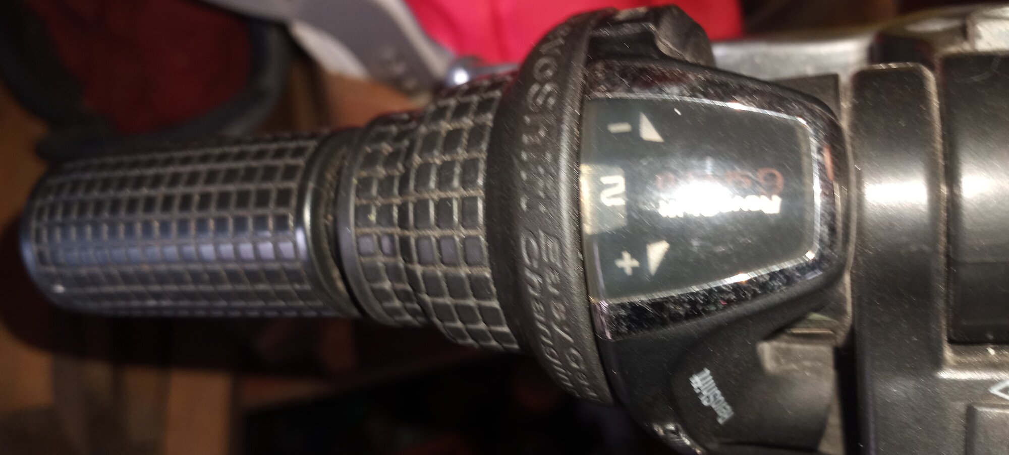

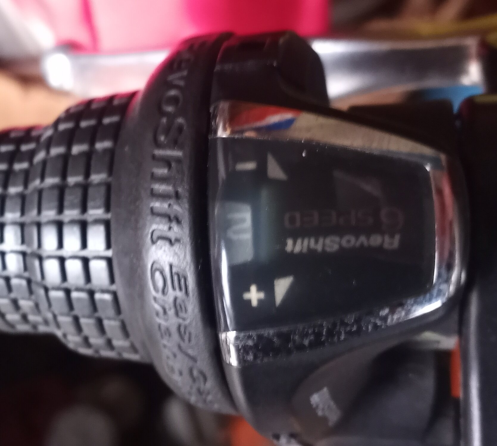

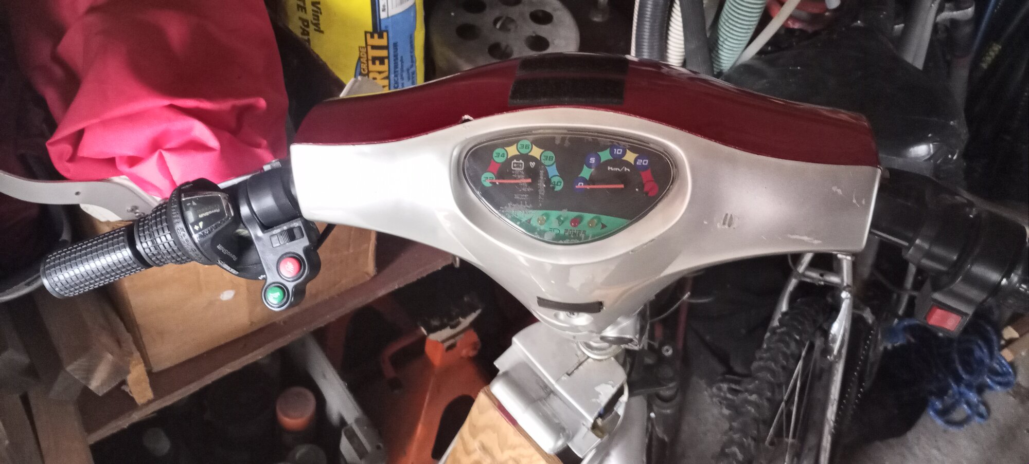

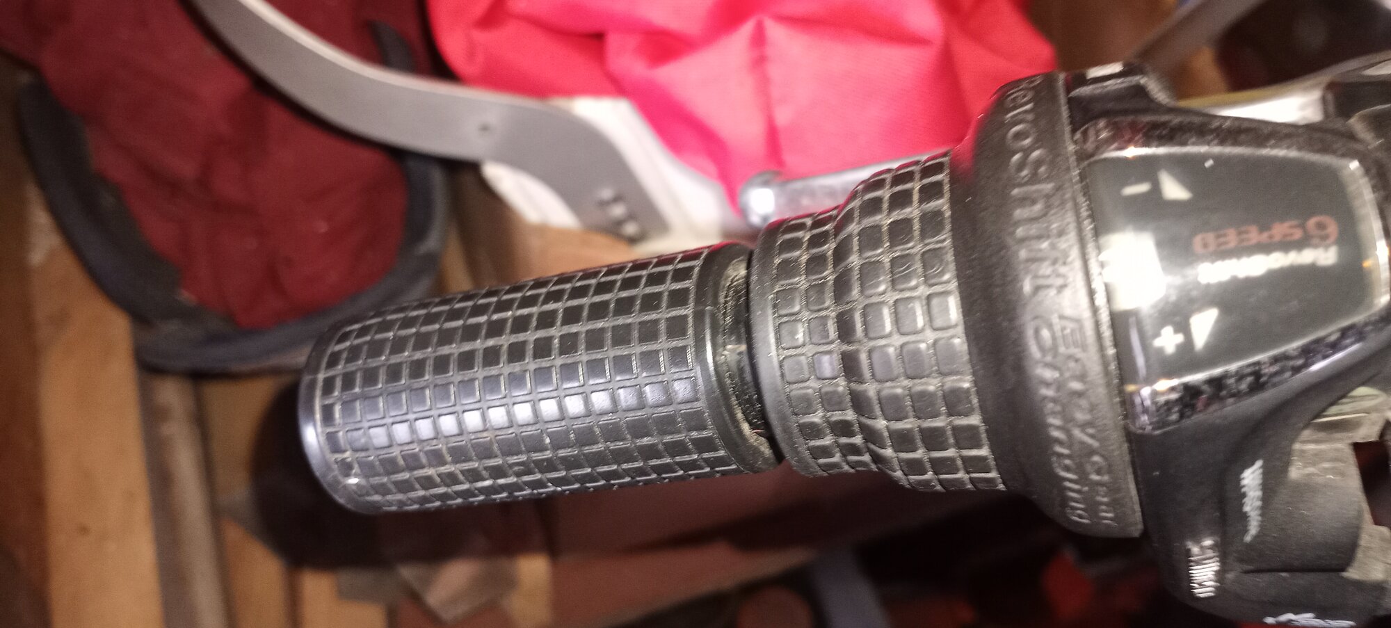

View attachment 173334View attachment 173335View attachment 173336View attachment 173337
Love this out-side-the-box thinking. This short-term solution is quick and costs nothing to implement.
That said, at some point in the long-term, I'll probably investigate @AvalancheRun "reverse the cables" approach using the attached video. It seems feasible. I was just curious if any others here on EBR had actually tried doing it with any success.
To do it right, I'll probably purchase and replace the shifter with a non-display version (~$40), cutting the new cables to proper "reversed" lengths.
Thanks again everyone. Unfortunately, I've just had some major surgery that will have me away from the bike for a few months, but I'll be sure to post my efforts -- should I decide to go this way - when implemented some time in late June.
