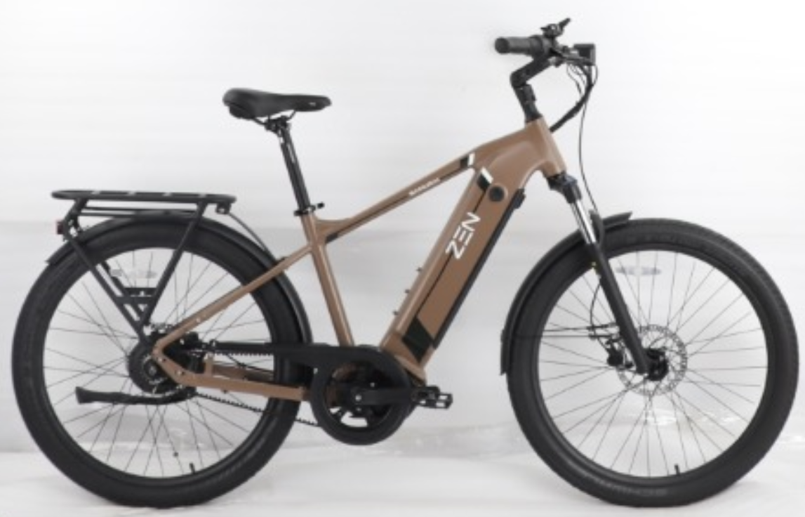

Yes, totally! and we have a few prototypes like that
750W Mid-drive ✅
Torque sensor - ✅
Top speed of 28mph - ✅
Large 960Whr battery ✅
Throttle ✅
AIR suspension ✅
powerful hydraulic brakes ✅
Gates belt drive ✅
Enviolo Heavy Duty CVT hub ✅
Integrated lights, fenders, and racks ✅
27.5" wheels with Schwalbe Super Moto-X tires ✅
Cost $3999 USD ✅
UL - certification of batteries. We are working on that. Offering high-quality batteries (warrantied for 4 years) is important.
We have a few prototypes, and if there is enough interest, we will bring this to the market.
We think a lot about offering a long lifetime/warranty on motors, batteries, and every other component. It is for this reason our flagship model will be Bosch-based. Currently, Bosch has 1000+ dealers across the nation. Excellent quality when it comes to motors and electronics and so are the service and longer parts availability. Building a bike that OP is requesting is not hard but having a long-term plan for support and warranty takes lots of meticulous work from the OEM. I know many companies are selling Bafang M620 motor-equipped bikes for $4K or $5K.

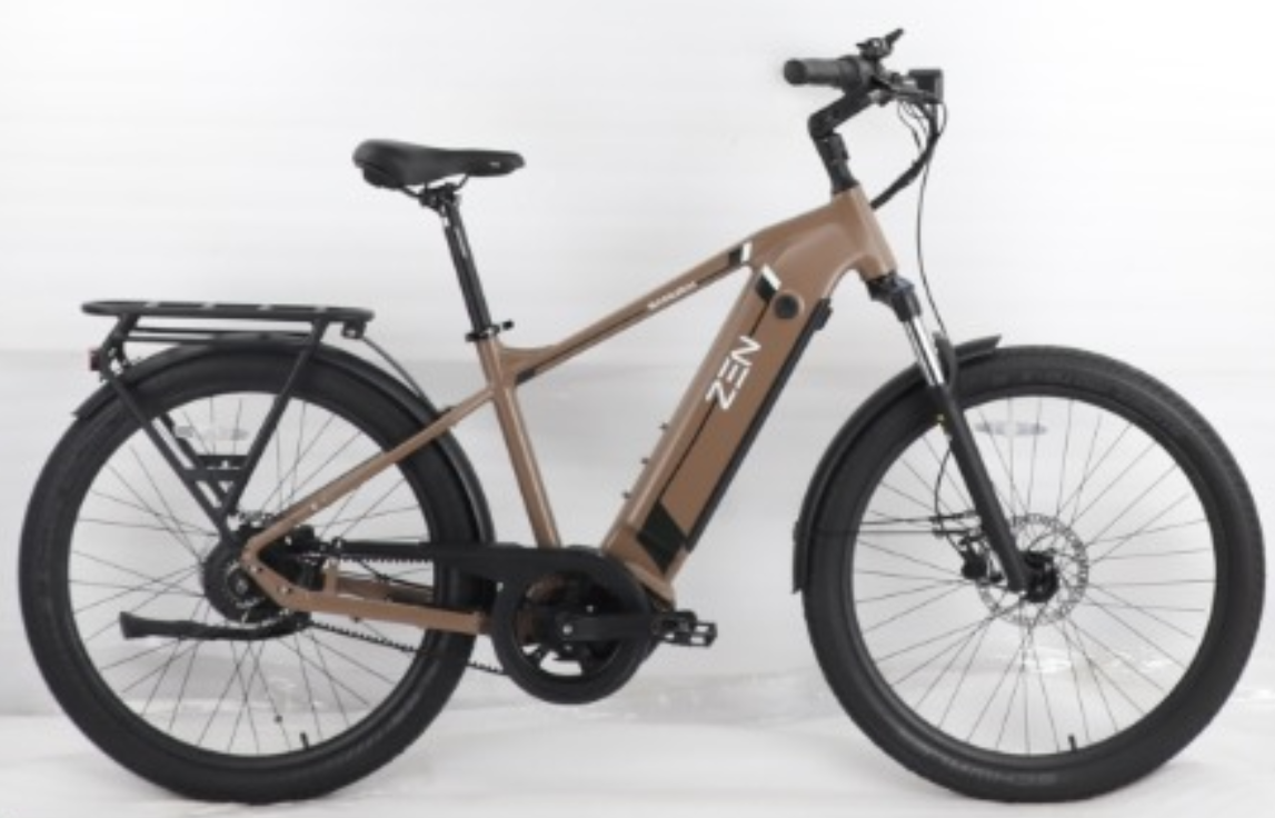

750W Mid-drive ✅
Torque sensor - ✅
Throttle ✅
AIR suspension ✅
Gates belt drive ✅
Cost $3999 USD ✅

This prototype bike doesn't have a Bosch motor.
Only our Samurai production bikes come with the Bosch. I was implying that before we bring something to the market, we try to think through the whole E-bike owning experience of the customer. We are confident about the quality and customer service offered by Bosch.
On this prototype, we have a 48V, 750W mid-motor rated for 130Nm, but we will test it thoroughly before mass production.

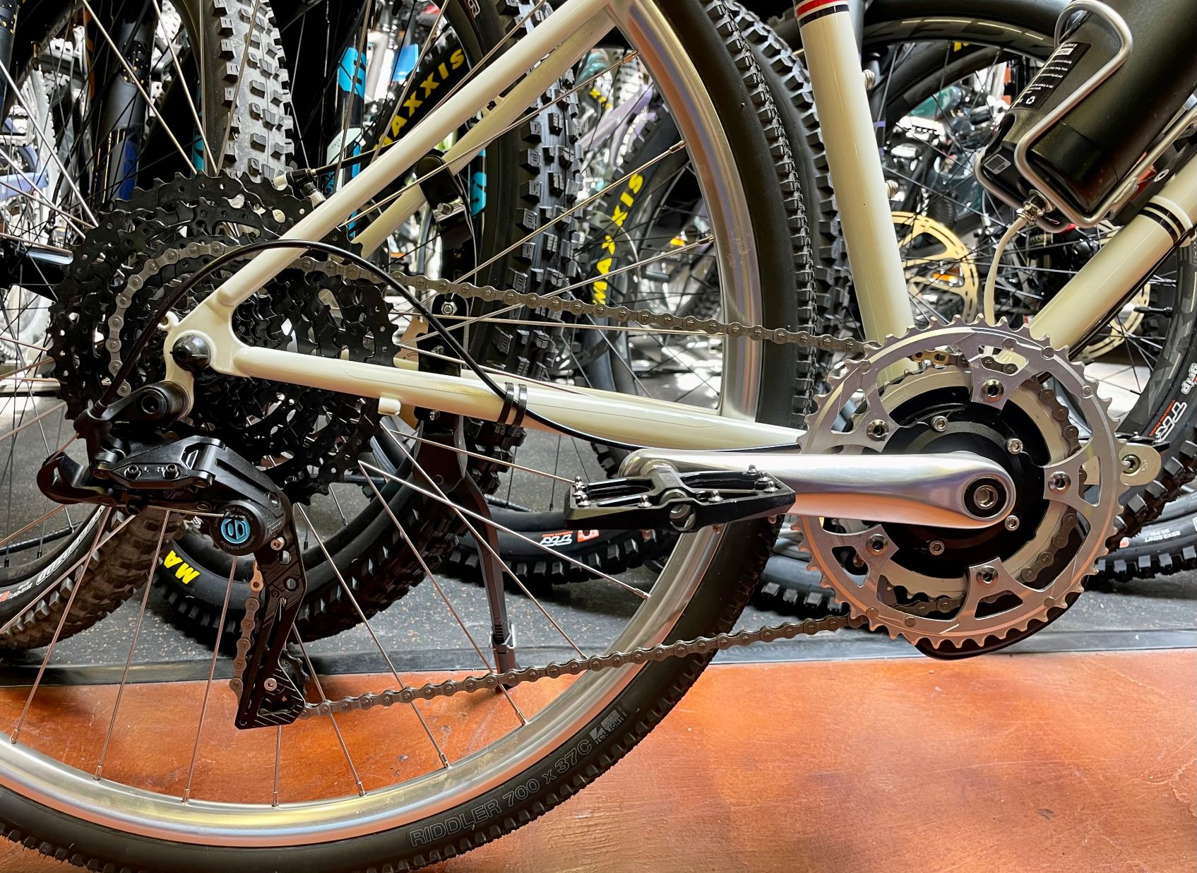

Yes. It is very possible. If you are willing to make it yourself. The problem is the belt. Typically those require a right seat stay that can open to slip on the belt. It is much less expensive and just as robust to use the new single speed eBike chain from KMC. A replacement cog is $12. Not $120. Gearing range is limited unless you want 12-14 gears and to pay big bucks. I would rather go with a 9-Speed wide range cassette, 11-46. e9 chains can go for $20. A Box 3, Prime 9 group set is about $200. This bike has two rings that allow for a manual change over. The 36-t hits all gears and makes the bike Class 1. The 46-ring hits 11-28 and is Class 3.
Single speed wide chains are awesome and much more durable for ebikes than the multi speed chains, but there is no market where a chain is as robust as a kevlar belt in industrial, automotive or elsewhere. You're still looking at 3-4x the lifespan for a belt over a chain, though they are definitely a cheaper option to replace (if more often). They simply have much higher pre-tension, don't stretch and accept much higher peak torque loads in comparison to a chain over their respective lifespans.
