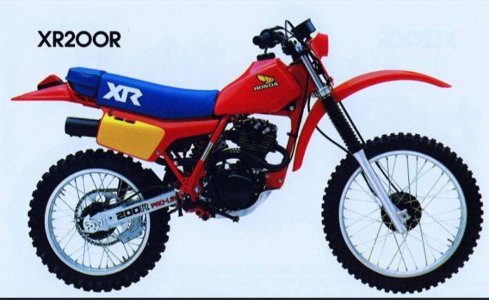

It's like the Hondas I used to have.
Twist throttle go.
