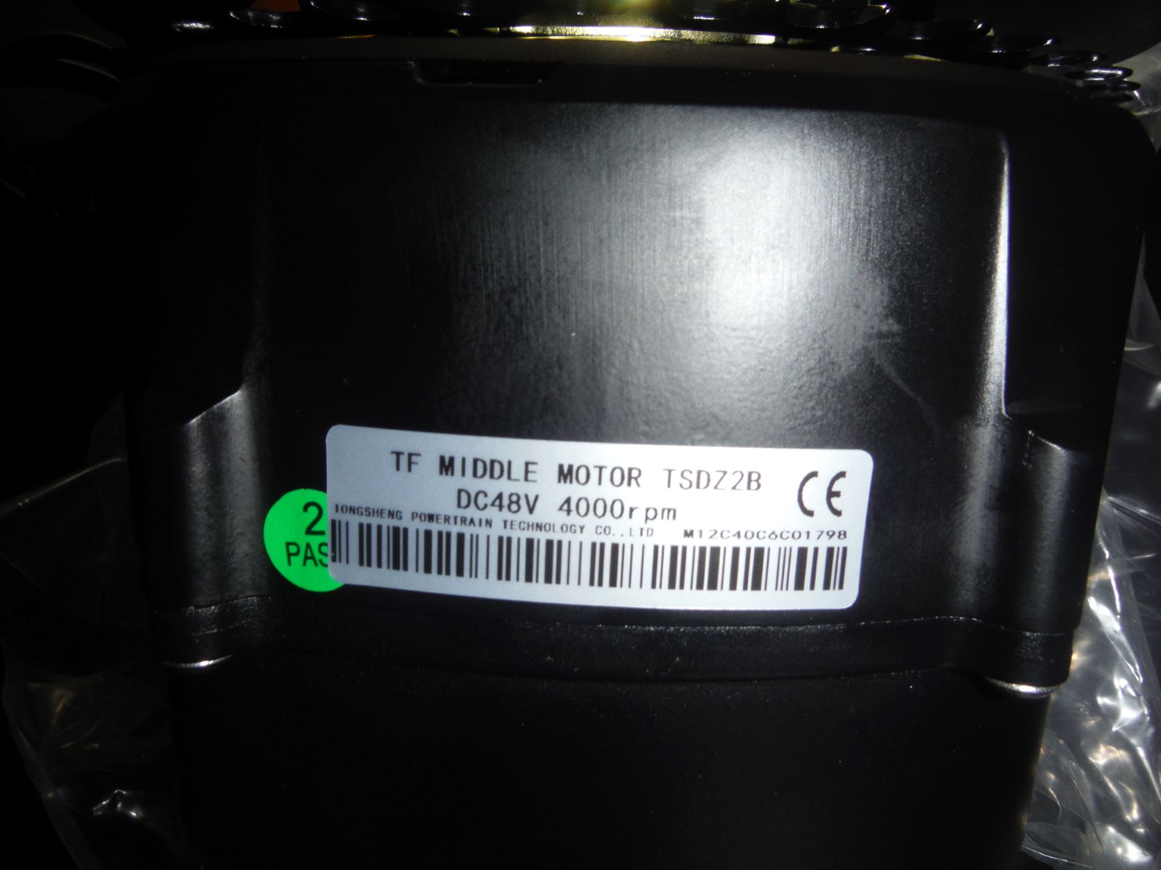

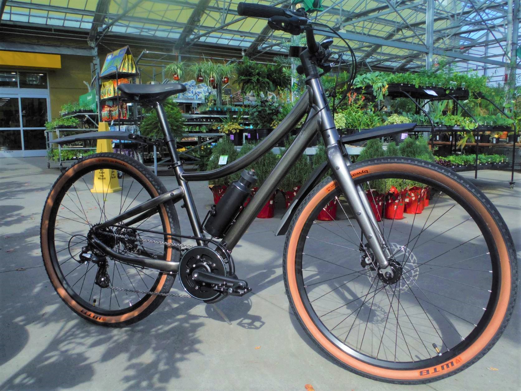

These are water resistant but not dive watches. Today I opened up the two sides of a new TSDZ2 and used gasket sealant for added weather resistance. The 'B' version comes more weather resistant for example a new seal behind the chainring. It is also more robust and smoother than earlier versions and comes in a 90Nm 750W permutation. If you were averaging 20Mph and lightly spinning like a pro 50 miles of range is no problem. See a video on How to Pedal Like a Pro. Grippy pedals help. For a starter bike I love the low maintenance Giant Momentum Vida Mid-step. Comfy and sturdy. This bike does what you are asking. The small frame has a smaller battery the large gets a large one.

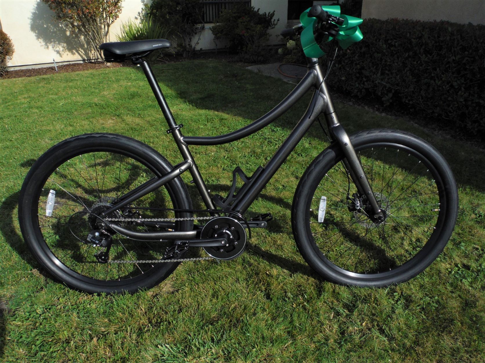

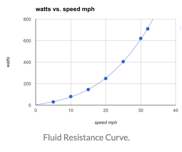

When you start going over 20 things like wind resistance come into play. Also bodily damage in a crash and the chance of a crash.

I would build it. Bicycle Motorworks sells stock 52v batteries that will work for you, and he builds them custom to spec. I've got a 35ah one built to my needs going into my latest cargo bike build. A BBSHD is by far the reliability king here. 160 Nm gets you out of any jam, and reprogramming the drive via many available online resources de-fangs it so its a PAS-loving exercise machine that uses a fraction of its capability, giving you a trouble-free motor that hums along at 20-50% of its capacity ... forever. The latest parts are also water-resistant. During the recent CA rainstorms I used onewrap ties and bits of plastic sheeting to 200% waterproof my handlebar bits and displays, and I commuted thru the worst of it.
