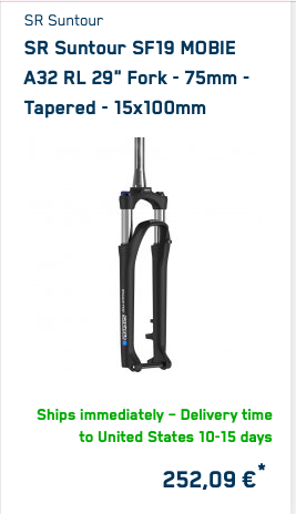

Forks: The largest brands typically use Suntour Mobie forks which are not only not the best but these are not available in the aftermarket. It is very hard to find a better replacement because the good companies making suspension forks are not interested to provide a 50-80 mm travel air forks (meaning quality) for as advanced concept as the modern thru-axle. Such companies produce for XC and MTB market. Therefore as you get your Suntour Mobie fork, it is hard to imagine finding anything better.

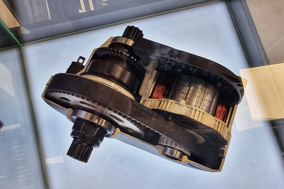

It is hard to know about the Dapu motor, but the specs are very interesting if you find the Bosch, Brose and such a bit on the weak side
