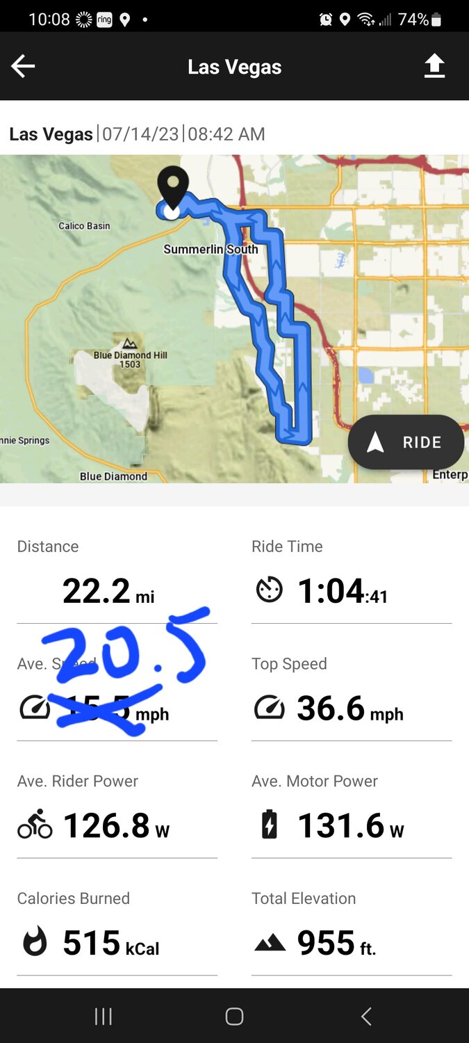

Thanks for the information. I would like to know if you are recording your rides with the TreK app.
Some yes, some no... having been (and still being) a habitual Garmin user, I'm not in the habit of recording from my phone. Also, other than an "Ave Motor Power" and "Ave Rider Power" summary numbers, you can't really look at charts of either power over time. The data is in the GPX file - but I've not delved down that rabbit hole yet... I did use the TREK app to record my coffee run, I've attached the summary info. Oh, and the app appears to calculate avg speed from total time, not moving time - even though it shows moving time on the summary screen... 🤔
