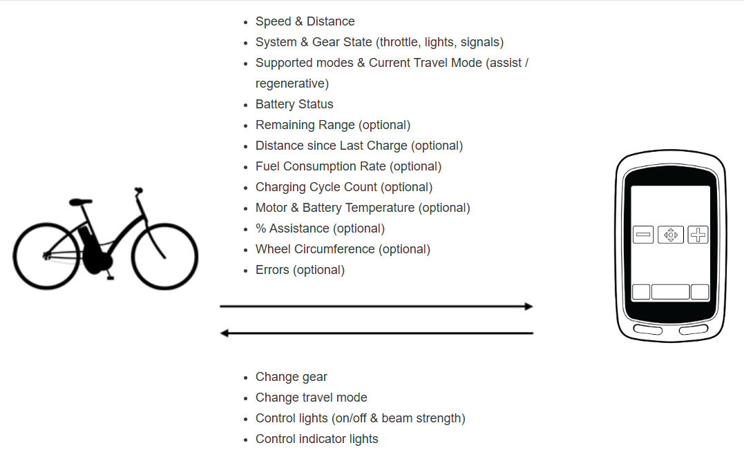

The LEV ANT+ protocol has no Motor Power included :)
Source: https://www.thisisant.com/developer/ant-plus/device-profiles#527_tab

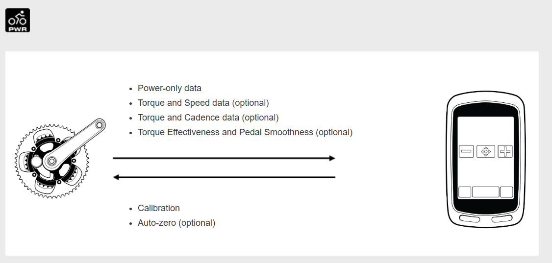

Interestingly, the protocol does not mention the Rider's Power but that is the part of another ANT+ protocol (the one dealing with Power Sensors).

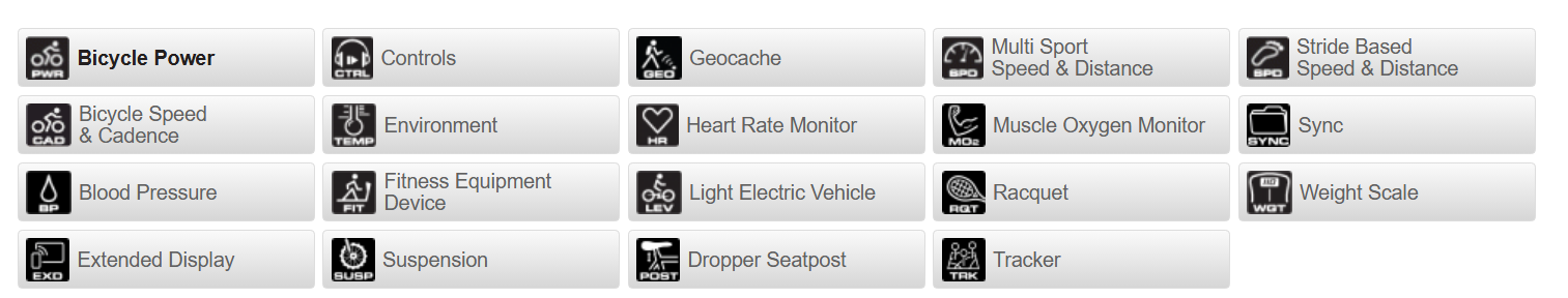

ANT+ is what it is:
Not only the protocols (while quite extensive) are limited. It also requires a good will of the e-bike system manufacturers and the bike GPS computer makers to use the full strength of ANT+, and that's not happening. You still get a lot of useful information obtained from compatible e-bikes:
  • Speed
  • Distance
  • Cadence
  • Rider's Power
  • Travel Mode (assistance mode name or ID)
  • LEV Battery Level % (can involve Main/Range Extender)
  • Range (optional)
(Garmin and Shimano Steps have cooperated. Garmin Edge has a special data screen for Shimano STEPS e-bike system, showing many normally ignored parameters; this is not ANT+ though).
It is a wealth of information! Some advanced/lightweight e-bikes come without the display and ANT+ is the only way to replace the display capability. Otherwise, most advanced e-bikes come with their own App that shows a way more parameters than ANT+ can visualize. Or, it is an advanced display such as Specialized Mastermind. Both display and App can show the Motor Power or Rider/Motor power ratio, for instance. However, it is not really practical to have a smartphone on your bars unless you only ride paved roads.

The only widely accepted standard is ANT+ with the LEV extension. The implementation of ANT+ for a given e-bike system solely depends on good will of the e-bike system manufacturer. For instance, Wahoo has no issue to recognize both Main and Range Extender batteries while Giant/Yamaha battery is not being recognized because of some software glitch on one of the sides. While Garmin will read the Giant battery but not recognize any Range Extender. Wahoo intercepts the Travel Mode name (ECO, SPORT, TURBO etc as it has been written in the e-bike software while Garmin can only produce 1, 2, 3...

Re-iterating: LEV ANT+ is the e-bike MIDI but it hasn't achieved the excellence level or recognition similar to MIDI. However, it is not any dead-end as illustrated by the fact TQ HPR system is equipped with the protocol. ANT+ is a transmit only protocol, so nobody can manipulate their e-bike with that protocol (it was possible with unencrypted Bluetooth).

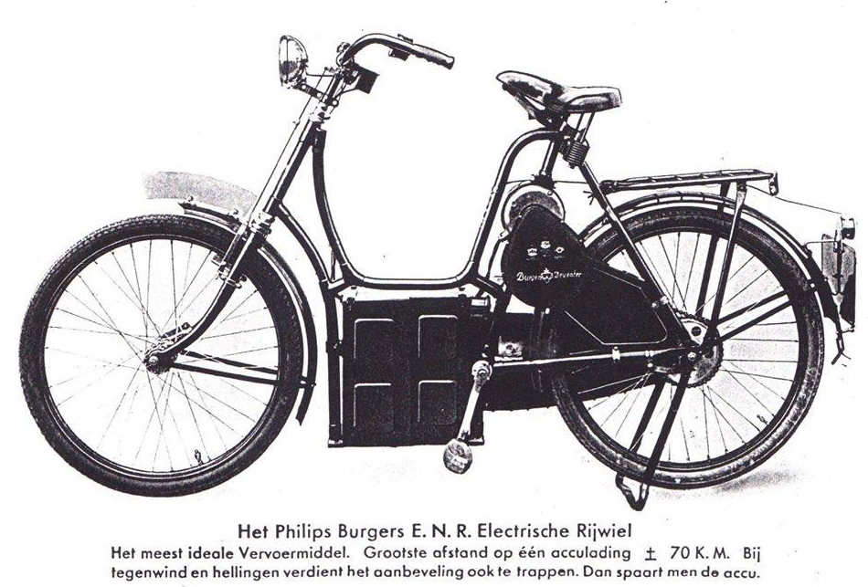

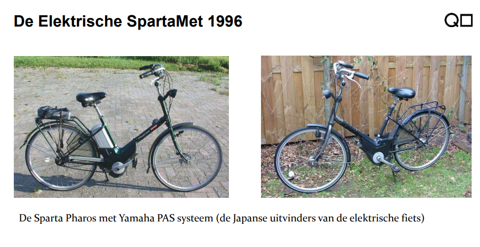

A bit longer than 15 years...

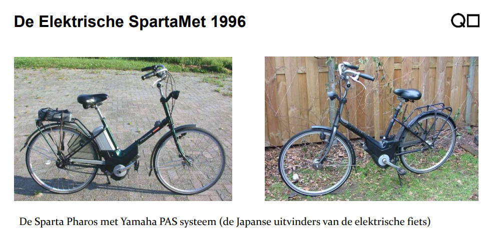

Yamaha E-kit is from 1993 on the market, e-bikes from Yamaha a bit earlier
not to mention the models pre-WWII

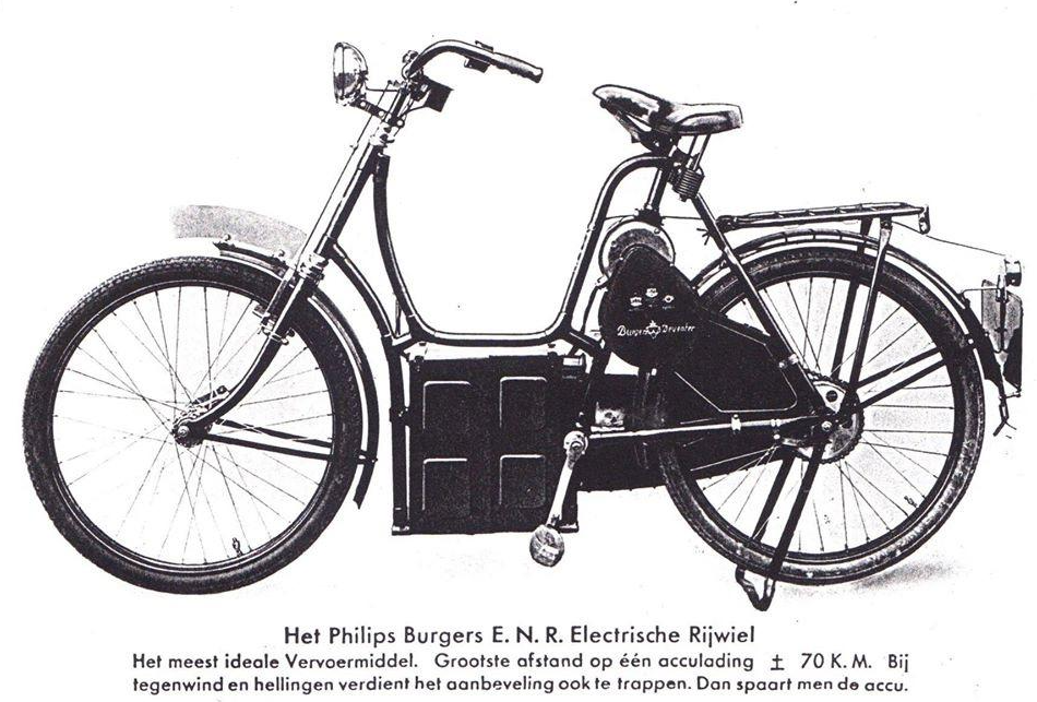

this one is from 1931. A Burgers model based on the system from Phillips.
