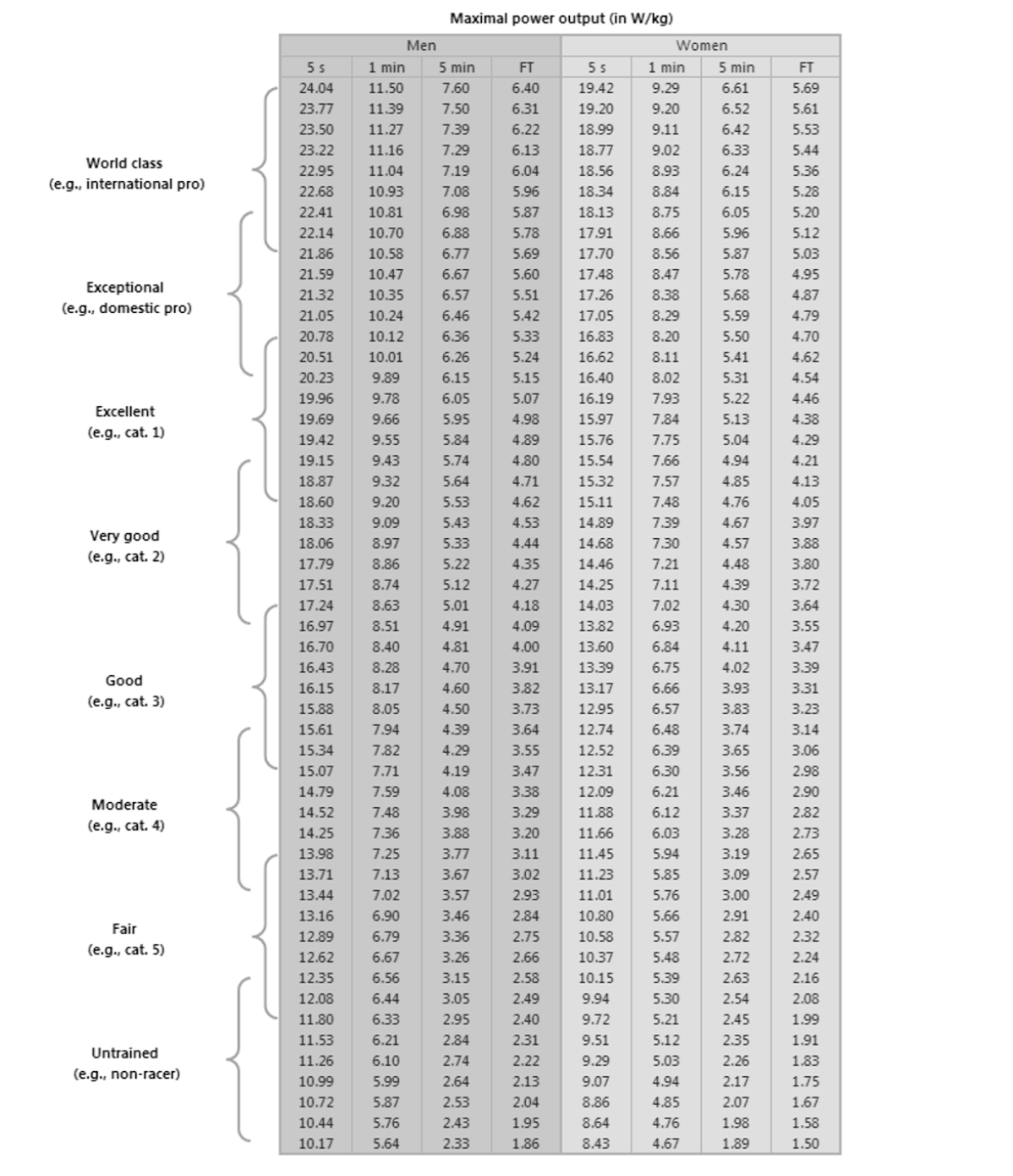

It's based on a bunch of empirical data, but I can't tell you how many times I've had to tell a rider who thinks they should be allowed to upgrade their category because of the numbers in this chart. It's way, way more than that.
Chart limitations notwithstanding, I'm very proud to have just squeaked into the bottom line — at least in the 5 min and probably in the FT columns. Hope that qualifies me to at least watch a race.

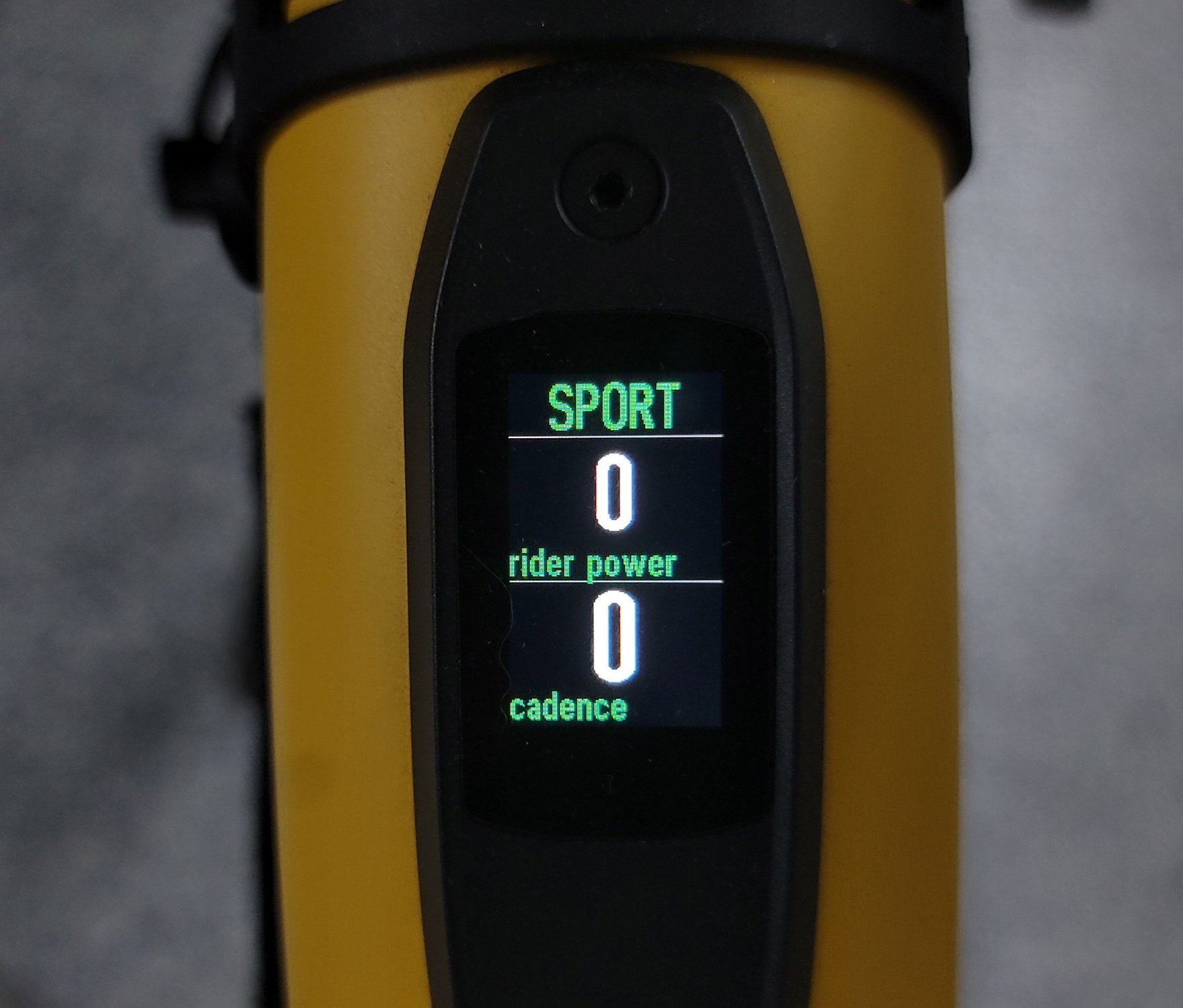

Digression: If you end up with a bike with a built-in rider power (Pr) display, I think you'll get a lot out of it — even if you never do a day of formal training.
My first power meter was built into my current Vado SL 1, and it's been both educational and entertaining. Not the most accurate by all accounts — per @mschwett , it runs ~5% high — but plenty close enough for my purposes.
This is the (top tube) dispay I watch 95% of the time now. Ride for fitness as much as anything these days but never in a disciplined way. Still, encouraging to see Pr progess over time. The lure of round numbers is also a spur: If I look down and see 190W, just can't resist pushing it to over 200W.
If you like bicycle physics, it's also a great way to develop more insight into how speed, external resistances, cadence and assist choices, and Pr interact in the real world.
A totally unexpected discovery — the carrot effect: When upping assist results in higher speed, my Pr tends to go up all on its own. Result: When you have the battery, better, faster workouts at higher assist. Who knew?
