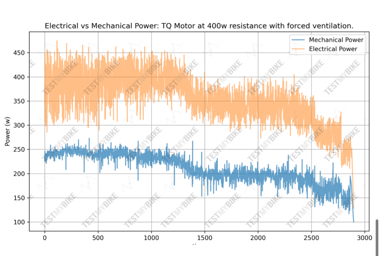

Here’s another test report I came across showing the efficiency o the HPR50.
Yes, it’s logical that the hpr40 will prove to be at least as efficient as the HPR50, likely better. Besides evolving motors, there are still gains to be made in battery technology which will increase range per battery size/weight = more miles per same physical size battery.Again, just from press blurb, but TQ claim a system efficiency of 80% on the HPR50, and we know that the ‘40 has a few differences in the motor (like the lack of a second freewheel/clutch) so I guess that’s where the claimed additional 10% efficiency comes from. I’d love to know the real figures!
Not really surprising Spesh press rate their main future rival for road bike motors very low…
Wow that is great stuff! I had a long phone call with the ‘40 Product Manager at TQ last week, trying to sort out those crazy claims of their customer services person, and one of the things I also wanted to check was whether they had addressed the derating that the HPR50 was known for. She said not only had the case design changed, to allow for greater cooling, but that also the 40 produced considerably less heat as it is rated at 200w and they had seen no derating in their testing. That would up the efficiency considerably. I’ll be looking out for Testmybike’s review of that one!Here’s another test report I came across showing the efficiency o the HPR50.
It’s nice to get your input and analysis, both here and on your YouTube channel! And you’re so right about the heat/efficiency connection: basic physics says less heat = better electrical/mechanical conversion. Thanks for your reviews!Wow that is great stuff! I had a long phone call with the ‘40 Product Manager at TQ last week, trying to sort out those crazy claims of their customer services person, and one of the things I also wanted to check was whether they had addressed the derating that the HPR50 was known for. She said not only had the case design changed, to allow for greater cooling, but that also the 40 produced considerably less heat as it is rated at 200w and they had seen no derating in their testing. That would up the efficiency considerably. I’ll be looking out for Testmybike’s review of that one!
Ditto, and Calcoaster thanks for the comparison data you provided.It’s nice to get your input and analysis, both here and on your YouTube channel! And you’re so right about the heat/efficiency connection: basic physics says less heat = better electrical/mechanical conversion. Thanks for your reviews!
Wow, a ton of useful information in this report. Thanks for sharing!!Here’s another test report I came across showing the efficiency o the HPR50

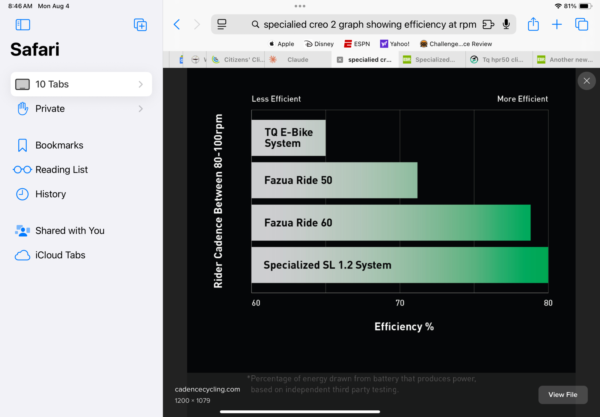

That looks more like an average efficiency of 60-70% which should show up in real world testing of battery range. Anyone know the approximate average efficiency of the X-20. About the same, better, worse?

Very helpful, thanks. Any idea of how the Mahle X-20 drive compares (not sure what value you use for cadence on a hub drive...)

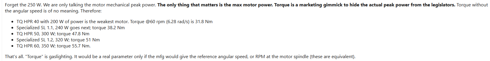

Forget the 250 W. We are only talking the motor mechanical peak power. The only thing that matters is the max motor power. Torque is a marketing gimmick to hide the actual peak power from the legislators. Torque without the angular speed is of no meaning. Therefore:
That's all. "Torque" is gaslighting. It would be a real parameter only if the mfg gave the reference angular speed, or RPM at the motor spindle (these are equivalent).
- TQ HPR 40 with 200 W of power is the weakest motor. Torque @60 rpm (6.28 rad/s) is 31.8 Nm
- Specialized SL 1.1, 240 W goes next; torque 38.2 Nm
- TQ HPR 50, 300 W; torque 47.8 Nm
- Specialized SL 1.2, 320 W; torque 51 Nm
- TQ HPR 60, 350 W; torque 55.7 Nm.
