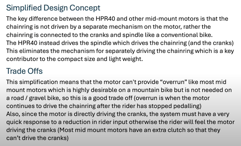

Then there is this TQ. Obviously we need to clarify this techie’s statements, but it is way better than the X20. My first reaction to it was “hub-motors are now dead”. The motor is tiny, easily hidden (important to quite a few roadies) and truly is next to silent. I’ve spent some time trying to record it’s sound for a vid, I’ll probably post that tonight as I don’t want to post the planned first ride vid if somehow this tech is correct.
Neither it’s size or quietness is as important as the way it uses it’s power. I’ve experienced lightweight mid-motors before (take a look at BH’s iAerolight if you want to see THE most beautiful e-bike ;-)) and they are simply better at climbing. The ’40 can use all of it’s power and torque as long as you can keep your cadence in it’s sweet spot. I guess that’s why the granny rings as supplied are either 36t or 34t. The X20 lacks grunt at slow speeds ie on steep climbs. It doesn’t have 55Nm under those circumstances, more like a proportion of it’s actual 23Nm, and the Mahle app I had running as I climbed confirmed that only 99w was being produced at 9km/h. Using the Smart Assist feature I could up this to 169w, but it didn’t feel like much.

Anyway, I hope you can help these people get their story straight with the TQ motor. I think it’s ridiculous and semi-impossible that an established motor company would make a DU that can’t run unimpeded without power. Especially for a lightweight mid-drive which will be used for applications where the riders will be inclined to turn power off and will expect the bike to be rideable without assist at all.

Yeah, it just has to be nonsense. The TQ motor is specifically designed to be run off as much as on. Think that techie might be in for some retraining!

i just received an email from a senior tech at TQ apologizing for the incorrect information being passed by their customer service rep. He told me the hpr40 was designed to be ridden with no assistance and will not be damaged by doing so. He covered all the cases: riding above assist cutoff, turning assist off, etc, and confirmed that they expect all of those situations will occur and they designed the motor to be ridden safely with no assistance.
He did say the Canyon should be ridden with the bike powered up for the sake of the lights and deraileur, but the motor assistance can be off.
