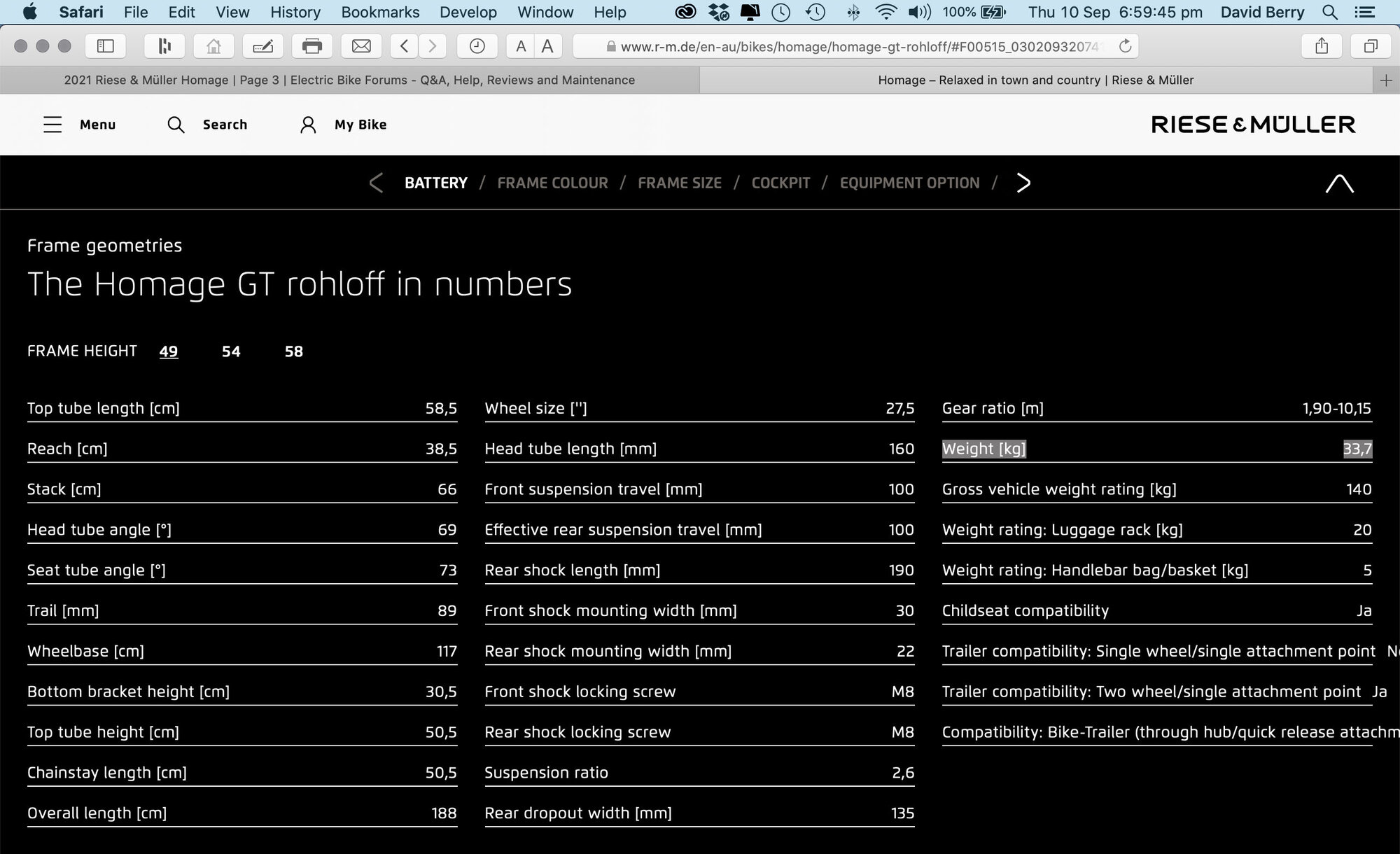

It would be interesting to see a weight comparison between the 100mm suspension Superdelite and the 2021 dual battery Homage. Does the step through frame make for a heavier bike?
A video of my local Brisbane Valley Rail Trail shows that it is not as ebike friendly as I would like! I can lift my existing 28.2kg Nevo but the new dual battery Homage will pose a bigger challenge.
+1
The R&M website has the information to do this but isn't smart enough :(
EUR 8000? Uh, oh. I feel I need a better car instead... :)
I like the new Homage specs though.
In their defense i should have said "isn't quite" as it is fairly decent, it does provide more details than many other ebike sites.
I do agree. After bike configuration, all specification details are given.
Mike…​
  • Open r-m.de.
  • Paste your order code F00515_030209320741 into Search.
  • Your choice will be displayed. (Save yourself time, click this link!)
  • Scroll down past
    • the summary (white background),
    • the man dressed for town (colour photo),
    • 'Your GT Rohloff' (black background),
    • Specifications (white background),
    • Frame Geometries (black background).
…David
Mike…​
  • Open r-m.de.
  • Scroll down past
…David
Unfortunately, the same 33.7kg appears for a 625Wh 49cm configuration. So none the wiser?
Hmm. Most of e-bike manufacturers are reluctant to give the bike weight. R&M try their best. R&M don't show however, for example, the fact the dual battery would increase the bike weight significantly. The single battery version I chose would weigh at least 10 kg more than my Vado or Trance. Very important factor for me if I wanted the "e-bike SUV".
I wonder why R&M don't follow their Delite/Superdelite naming convention with the Homage.
Anyway, there is a 3.1 kg difference between the two Delites, so my first guess is that there is a similar difference between the Homages.
  • Delite : 28.8 kg
  • Superdelite : 31.9 kg
The second guess will have to be yours. Is 33.7 kg the weight with dual or single battery? (Surely the dual battery version!)
  • Delite : 28.8 kg
The Delite / Superdelite data certainly suggest 33.7kg for the dual battery version. All will be revealed when my 1250Wh bike arrives (January?).
The R&M website has now changed the weight from 33.7kg to 29.7kg which makes sense for a single battery Homage Rohloff when compared to other models.
If 3.5kg is added for the second battery and an extra 0.5kg for the different downtube, then 33.7kg seems appropriate for the dual battery version.
