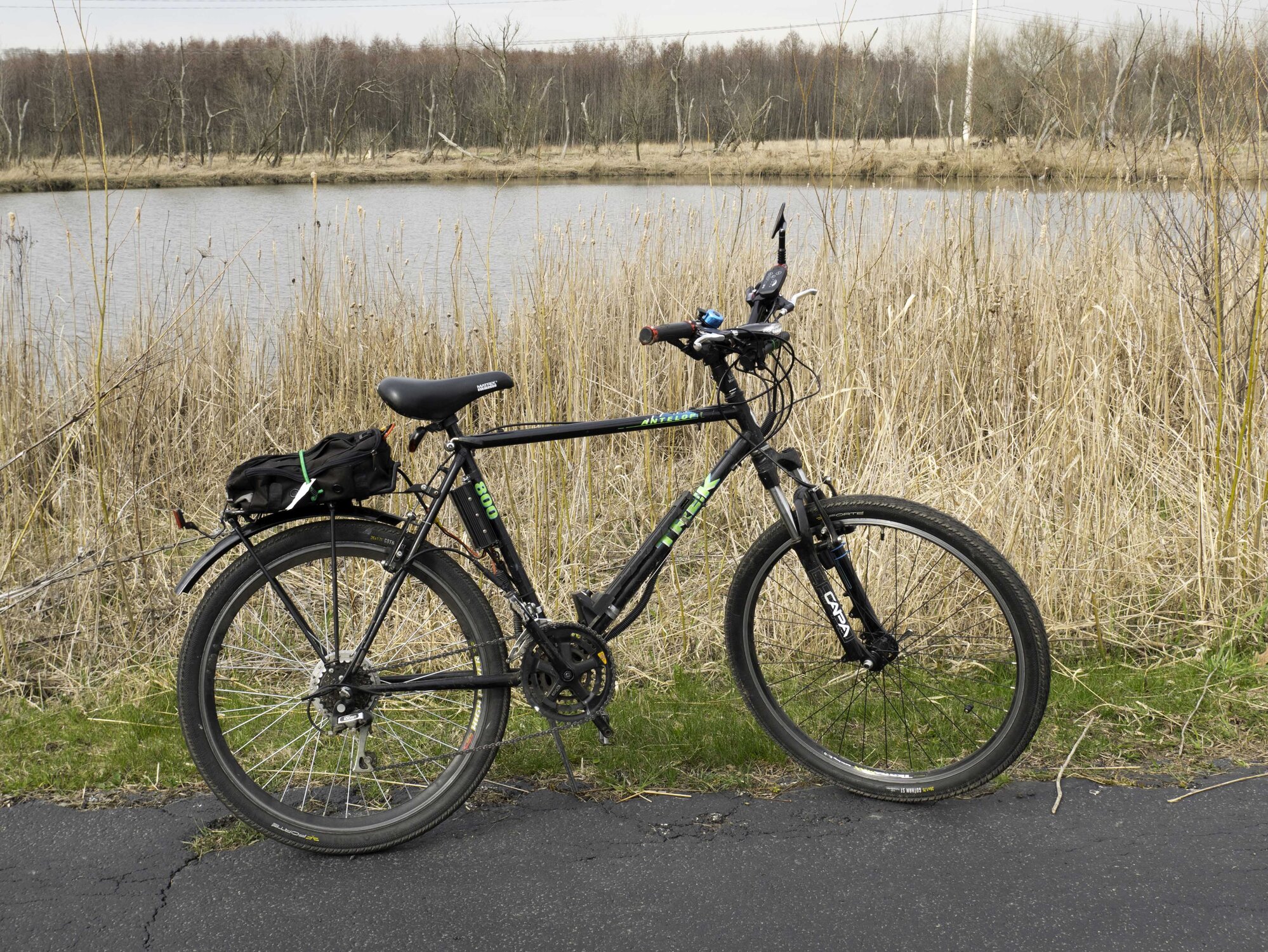

Did you say Trek 830 Antelope, from the early 1990's? I had it hanging from the garage rafters for years until 2015 when I installed a $200 rear motor kit and a $280 36V10Ah battery from elifebike on ebay, now grown to become U.P.P. (Unit Pack Power).
The original Trek brakes were horriible, but I think a lot of that was friction in the rusty cable sheaths, I replaced the cables, sheath, and switched to cantilever brakes. Here's my $500 ebike, make that $550 because I bought a new front wheel. Cr-Moly frame. No torque arms were used. I found the rear fender on the bike path. Re-used it.
This by the way was my first ebike conversion. Original (hard) seat.
No flat tires, so I've never had the motor off. Later that summer, I "upgraded" to a cheap RC Capa suspension fork ($50). It raised the front of the bike 5 inches, and now I can barely dismount the bike.

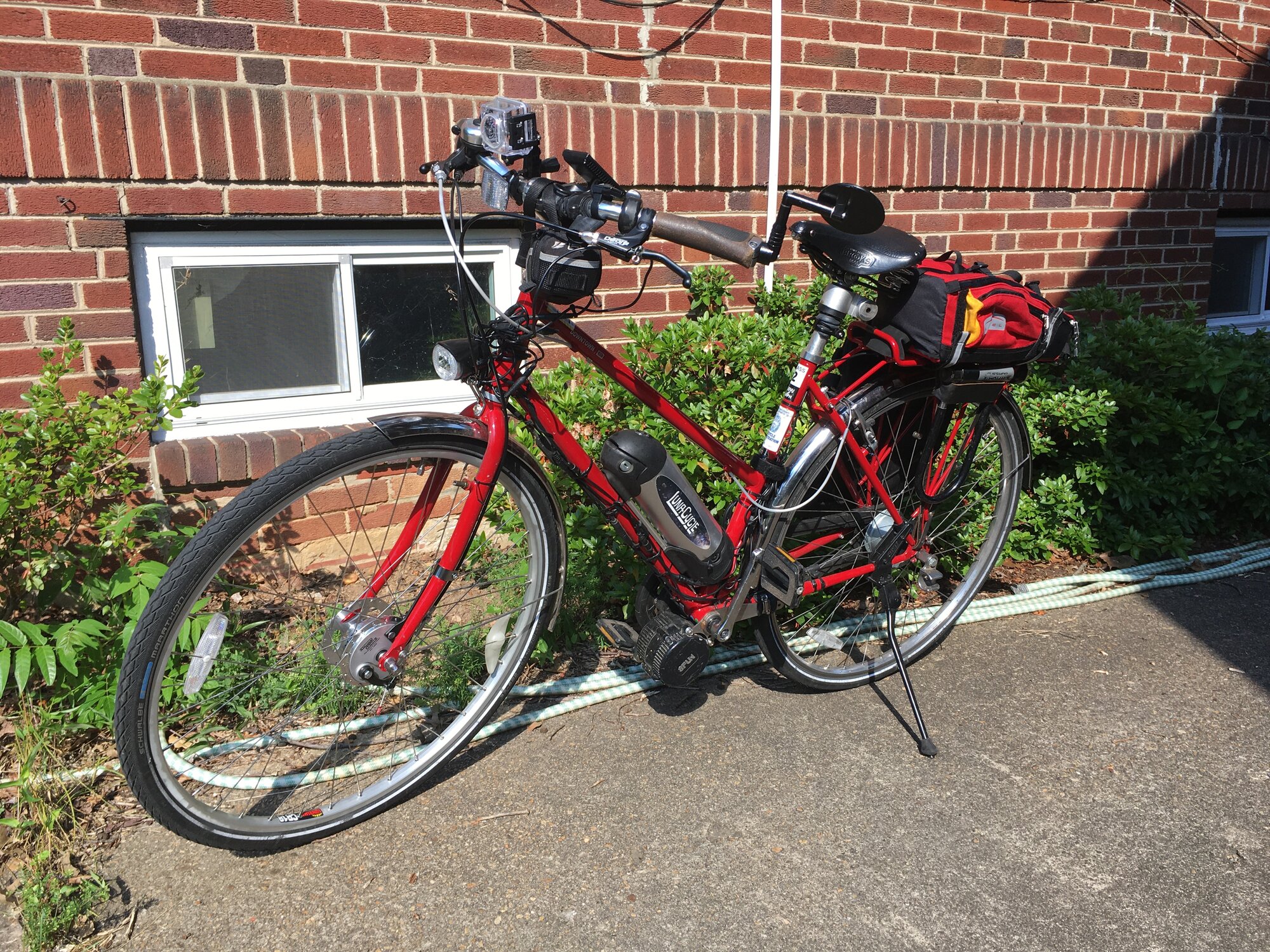

What a beauty! Those drum brakes are super clean! Is that a horn hanging below the display?
Tool bag, but with the Grin Tech DC splitter I now have a spare 36v DC Jack I could use for a horn. Thanks, I need to work on my cable management. Rear hub is a Nexus 8 IGH so I’m keeping the rim brake for now although I have the option to fit a roller brake. Debuting on tomorrow mornings commute to work! I’ve read it can take a couple hundred miles for a new drum to rough up the pad.
