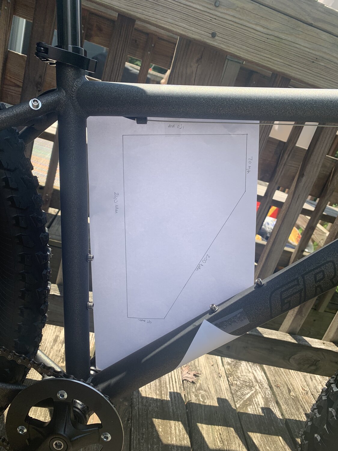

Here's where I envision the battery case fitting:

Why not turn the batterys so that the long section is straped to the top bar? That's the way I always see them mounted. Are you trying to get the CG lower?

Filling up the frame with battery is easy, but I haven't seen a secure way to do it and don't care for the look. I'm after a more compact battery so as to mount it as close to the seat tube as possible. Seems to me like the part of the frame designed to bear a load.
If I ever do a 72v pack it would likely be two 36v packs in parallel with the long sides running up the top tube, but with the big ends forward, like a gas tank. But better actually start this build first. ; )
