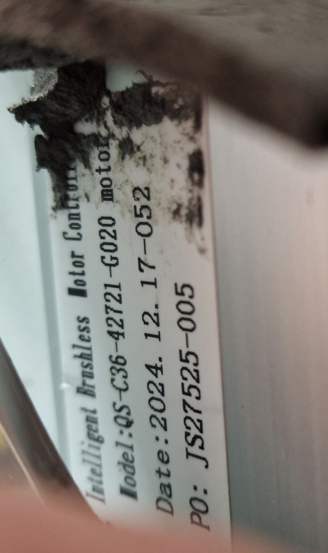

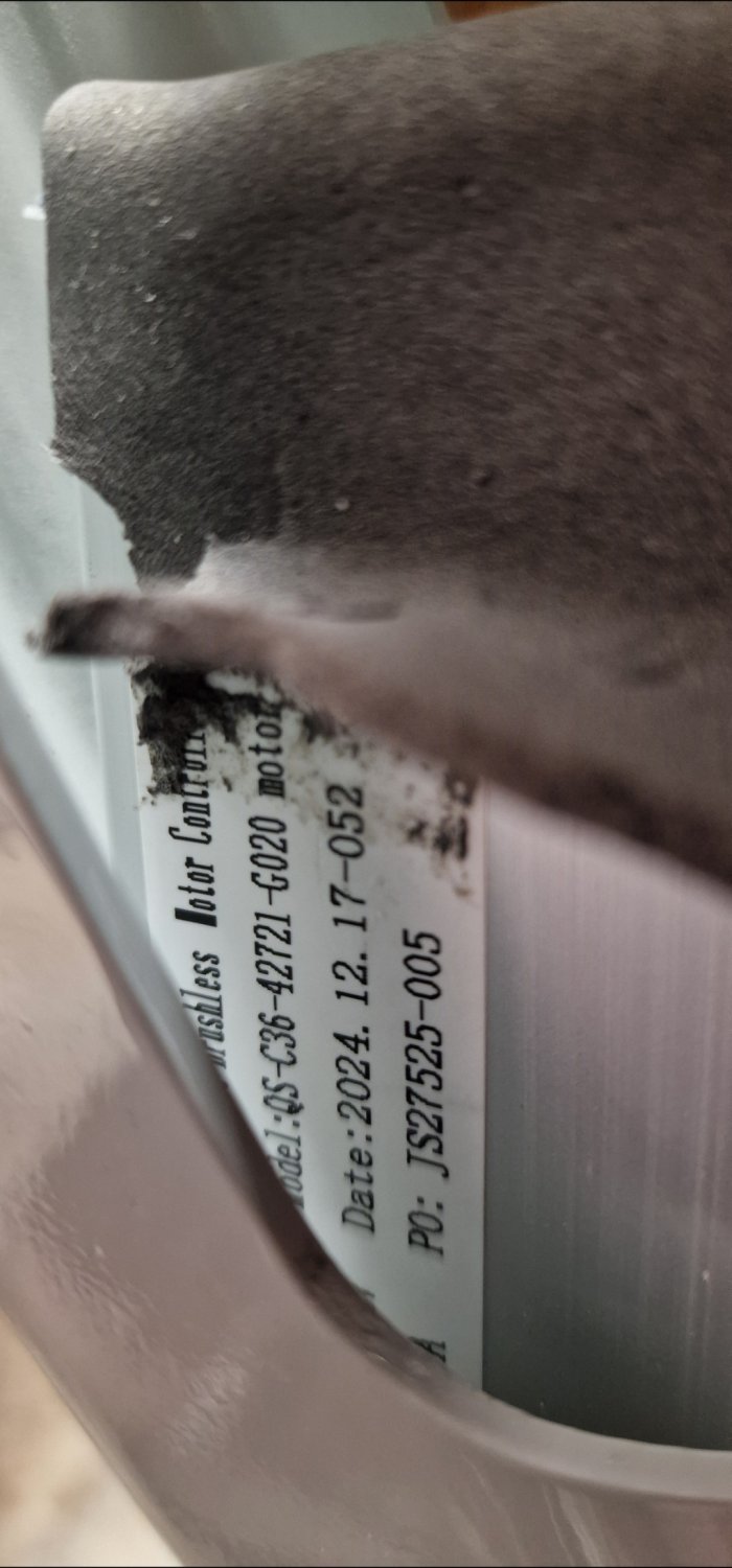

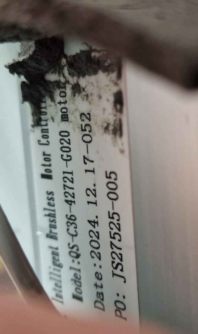

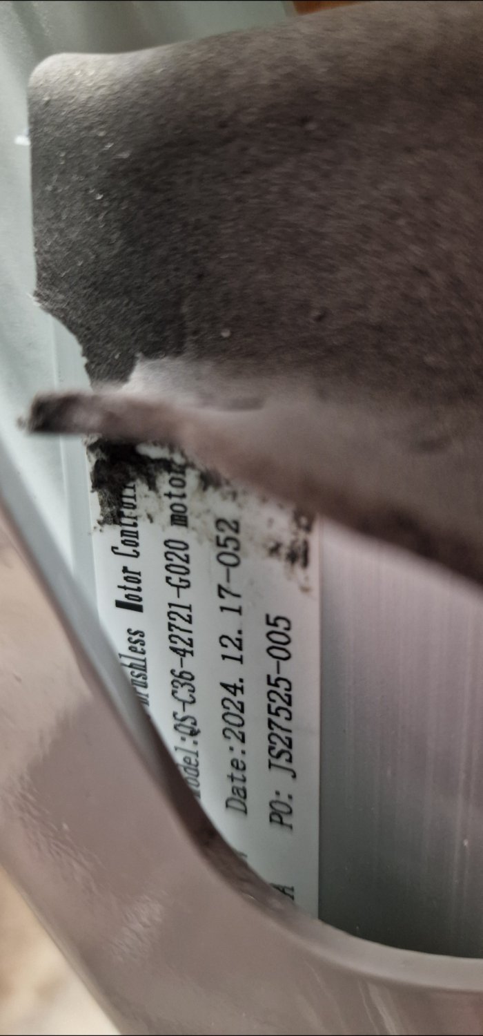

Hi there, looking for a little bit of help. I've struggled to find anything on the net, so thought I'd try you guys and see if any of you fine folk can help me. I'm looking for a replacement display, I want to upgrade it, for my Claud Butler Ridge 1.0 PAS bike. The display that is attached to the controller is a UART Topology DZ40 LCD Display with a 5 pin male connector, female connector comes from the controller.. Because of this male connector I'm have huge issues finding a replacement, can you help me? I've attached an image of the controller, really sorry it's a rubbish image but it's still connected to the bike.

I did initially get in touch with Claud Butler about the display. I'll condense the story here, the original DZ40 display initially got damaged. I reached out to CB who were extremely helpful. But on my quest to find a replacement I came across a load of really good displays that would work to my needs much better than the DZ40. So, CB confirmed everything about my display and sent me out a new DZ40 unit which worked right out of the box. During my quest I did try 3 or 4 displays, that didn't work. So, this bring me to you guys. There's very little info on my controller and CB have only confirmed the display that I need that works with the bikes set up.

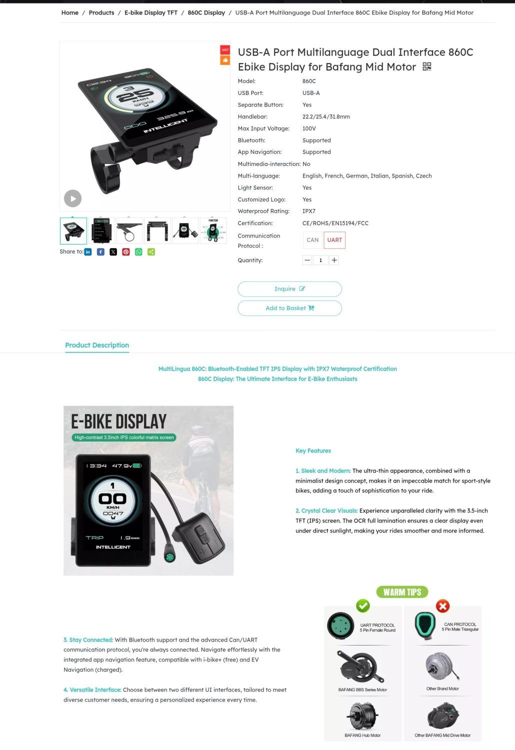

Yer, I did order something that looks extremely similar to the above but when it arrived it was UART protocol 2. It was advertised as just UART. I've seen that on almost every video I've looked at when people just swap out their displays without any issues. But for me, it's a struggle, ha,ha.

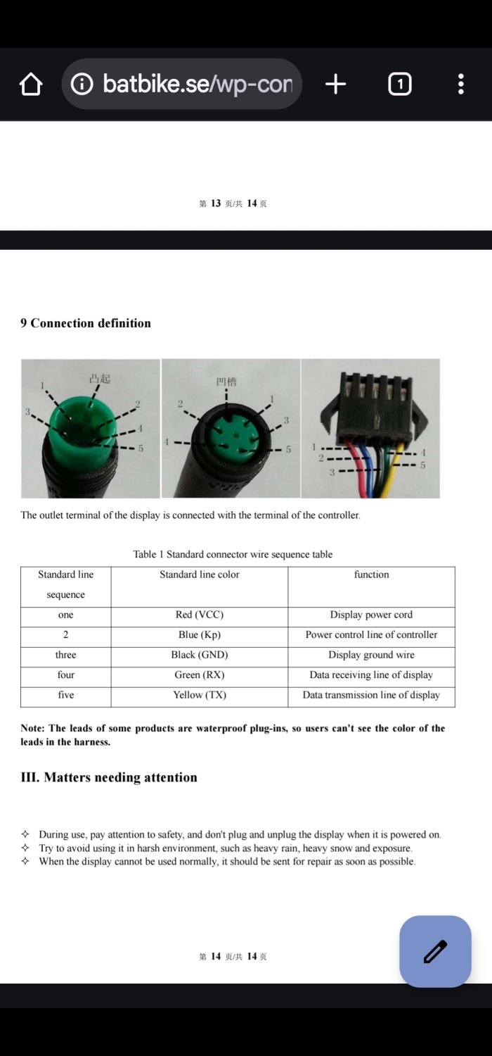

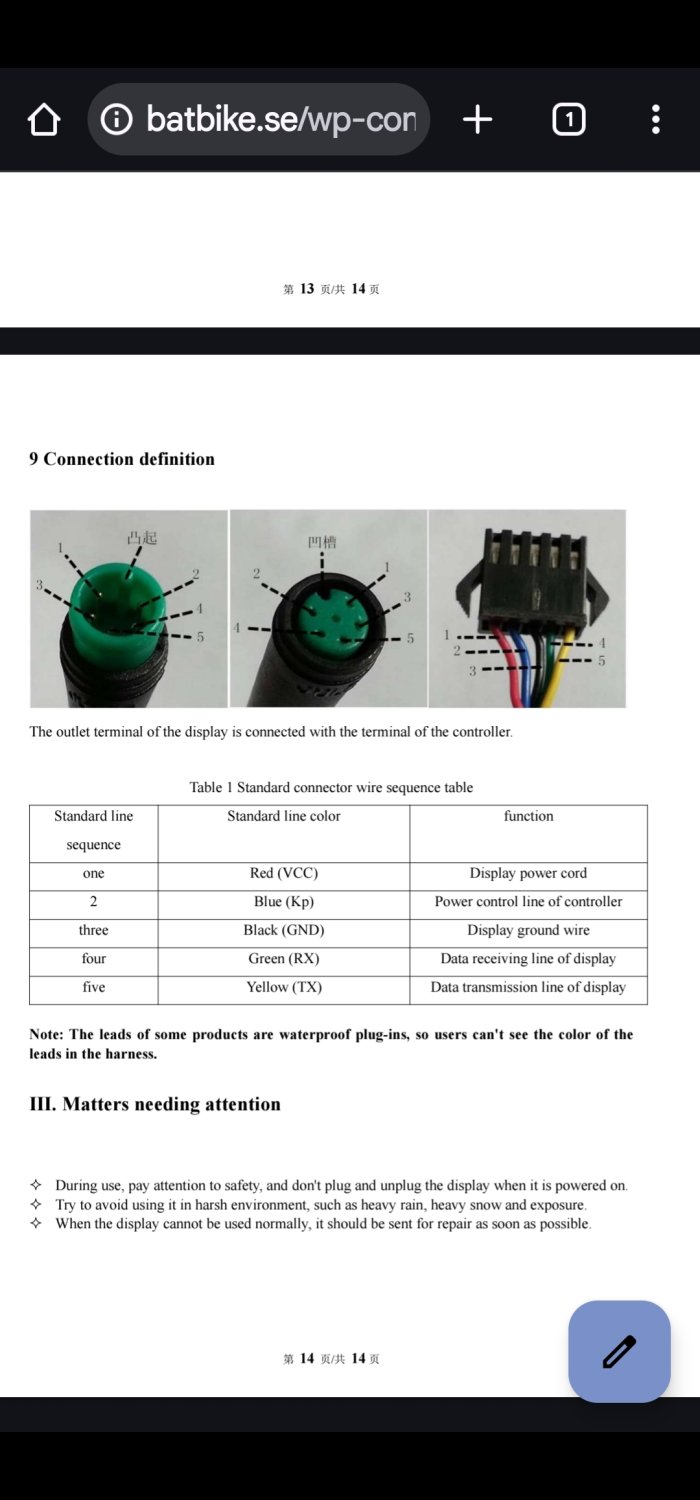

I believe the UART Topology DZ40 LCD Displays with female connectors are for Bafang mid motor bikes. Is your Claud Butler bike one of them, or is it a hub motor. I think the signal pinout for hub motor displays is not only changed in gender, but the pins are arranged differently, If so, then a commercial male-male adapter won't work.
We had a poster with this issue several years ago. He bought a bafang mid motor display with female connector for his bafang hub motor controller. Gender was wrong, and a straight-thru male-male adapter cable didn't work, Then he cut the connector off, matched by wire color, and it still didn't work. It was my guess that the adapter cable probably connected power backwards and blew up the display, but the poster disappeared,

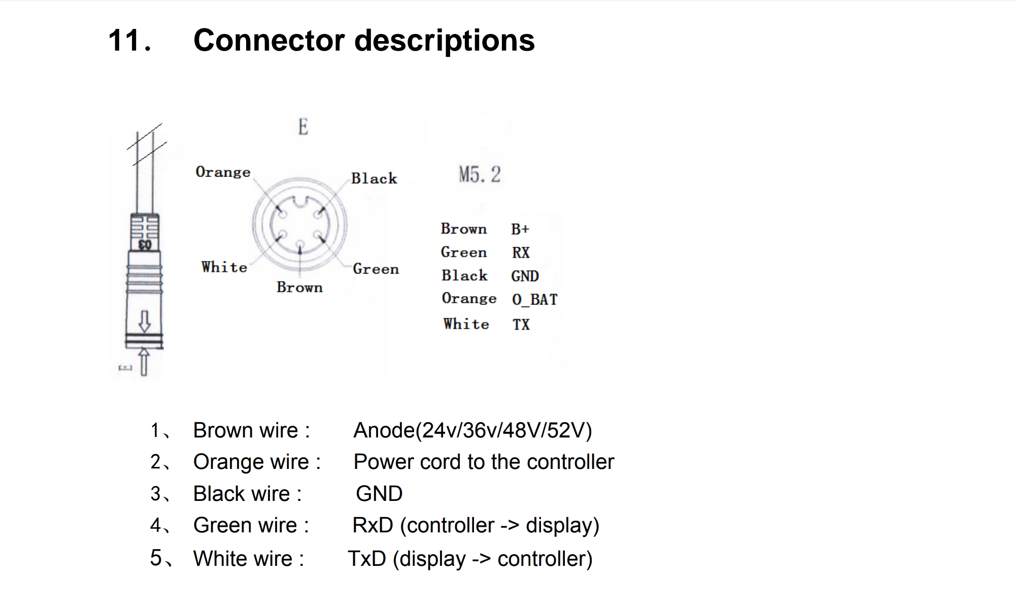

Hi there. The DZ40 has the male connector, the female end is the cable that goes to the controller. I've got a rear hub motor, think it's a G010 Bafang made. Yes, I've tried the conversion leads as well, that didn't work at all. That's the pin out for the display that is currently on the bike.
