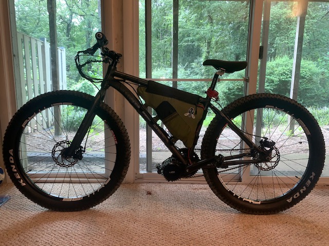

Here's how she sits with her new wheelset and Sturmey Archer RS-RK3: View attachment 65268

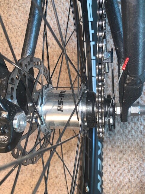

And here's the Sturmey in its natural habitat: View attachment 65269
Getting the shift cable properly adjusted was really frustrating until I realized that I'd reinstalled the shifter arm on the wheel incorrectly when swapping from the 18t rear cog to a 24t. The 24t turned out to be too low, so I swapped back to the 18t and got the shift actuator on the arm aligned with the receiver on the hub. May go with a 20t down the road, as they're cheap and not that hard to swap out, but a 42t chainring to replace the stock 46t might be a better solution.

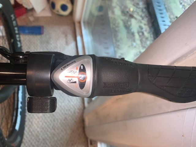

The half-twist shifter interferes with the throttle a bit:View attachment 65271
I may try to remove some material from the throttle to get it to fit closer, or maybe replace the thumb button with something that extends a little further to the right to make it easier to reach. Had an interesting ride yesterday with a buddy on his acoustic bike, though, and found that my riding style was totally different. On solo rides I'd been doing a lot of throttling up hills and accelerating until I was at top speed most of the time. These have been mostly commutes to work, so that makes sense, but it really puts a strain on the battery. A 2 mile test run on the 24t cog drained my 52v 18Ah battery by about 10%, while a 15 mile rec ride alongside my acoustic pal in PAS 1-2 only used about 9%, and was honestly more fun.

Well done... she's a beauty!

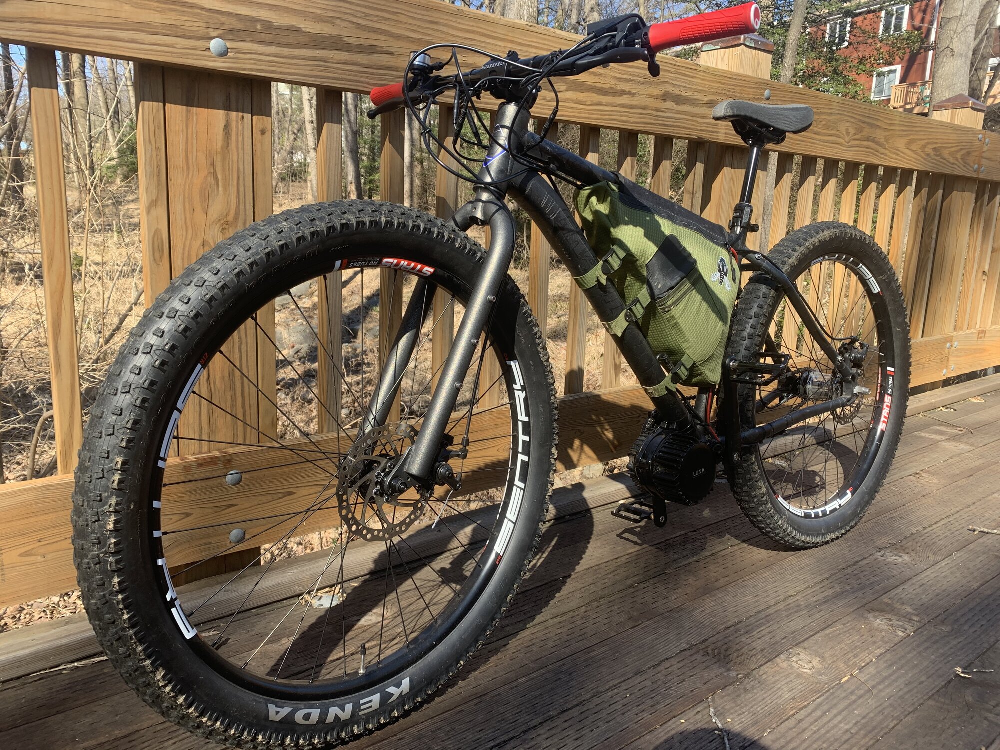

Manitou finally got the Mattoc Comp back in stock last month, and I got it installed last weekend. Works great, and slackens the headtube angle to 66 degrees, so a little closer to modern geometry. Looks the business, too, IMVHO.
That is one killer build! Looks totally dialed in as well, a bike to ride!
